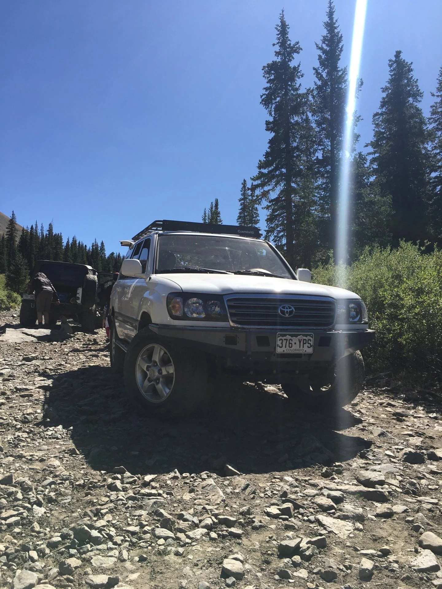

Well, this is Sasquatch aka "Sassy":
She is the first vehicle I have loved enough to name, and that was a complicated process of negotiation amongst my wife and 6yo daughter, and several of our friends. Text threads got quite long, and other top contenders included "Fully Metal Yeti", "Snow Yeti", and simply "Squatch". She's white and big what can I say.
I have wanted a land cruiser for a long long time, but student loans and practicality got in the way. With two young children, a realistic assessment of how she'd be used, I settled on the 100 as an ideal series for our purposes. Well thanks to this forum and the knowledge and support (and Classifieds!) found within I finally found the perfect one. Prior to jumping in I had already read so many build threads and tech articles I felt pretty silly with the (academic only) knowledge I had on these trucks without actually owning one, and I was excited to start building up one of my own.
So I bought one that was already built?? In reality, I have an extremely busy life (2 kids, demanding job) and my wife is not the most understanding about sinking thousands of dollars into an old vehicle (who can blame her). Truth is I found a deal close by that had all the modifications I would have chosen and more, at a price that was too good to pass up. @jfrench did a fine job of building her to where she sits today. This will get us out right away and be able to explore the beauty that surrounds my little podunk town.
So far she has been baselined/combed through by some of the best in the biz (@sleeoffroad and @2001LC ) which gives me great confidence in her longevity. I can only dream of maintaining the level where she currently sits. Hence the name "Tinker Thread", other than going full on "overland" on this baby there's not much else to be done to her. I'll be posting up my modifications, maintenance, and hopefully many trip reports and adventures.

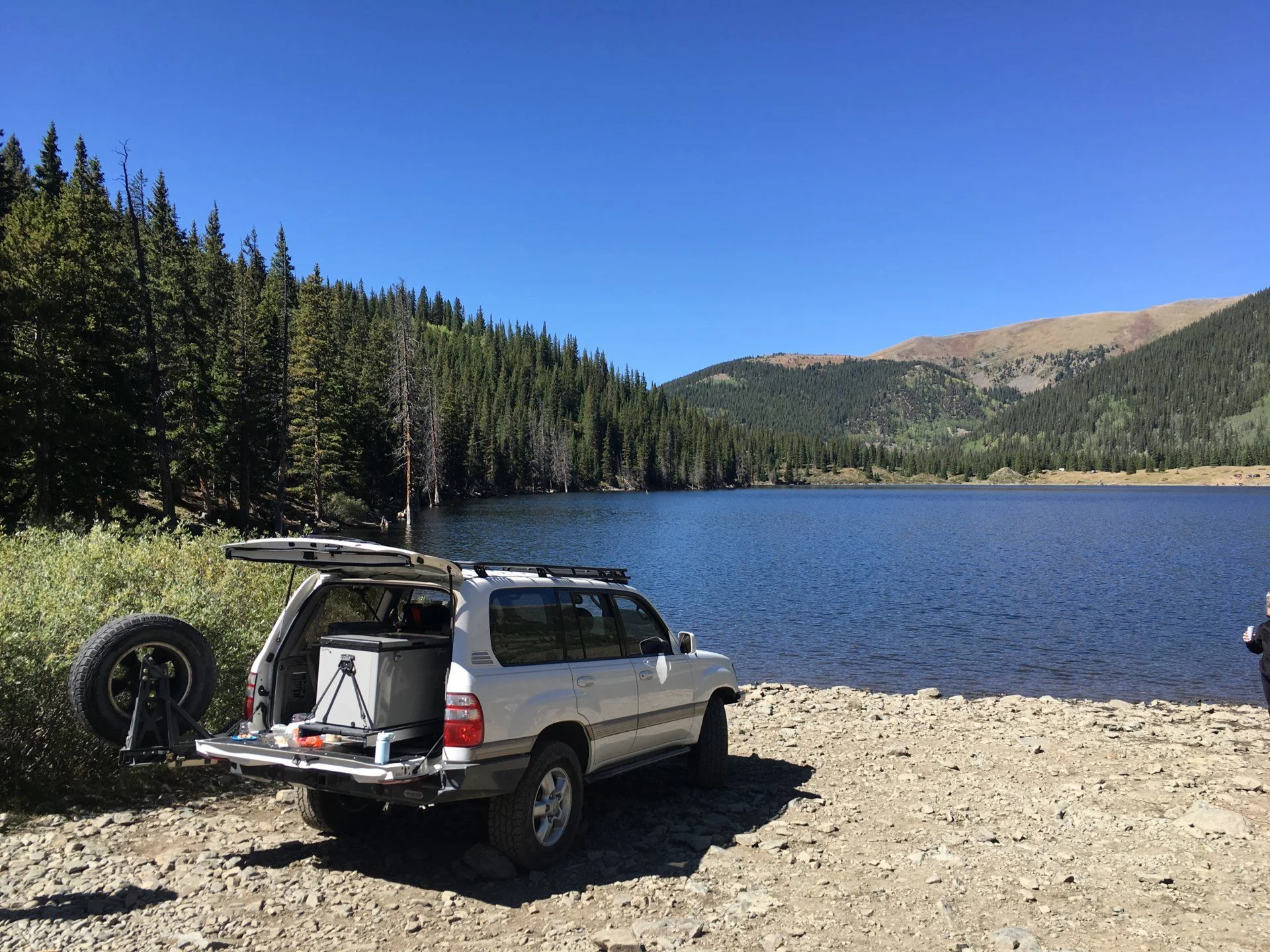

  8. Dial in the camping set up next summer, including fabricating a table for the camp stove to attach to the swing out. (next summer)

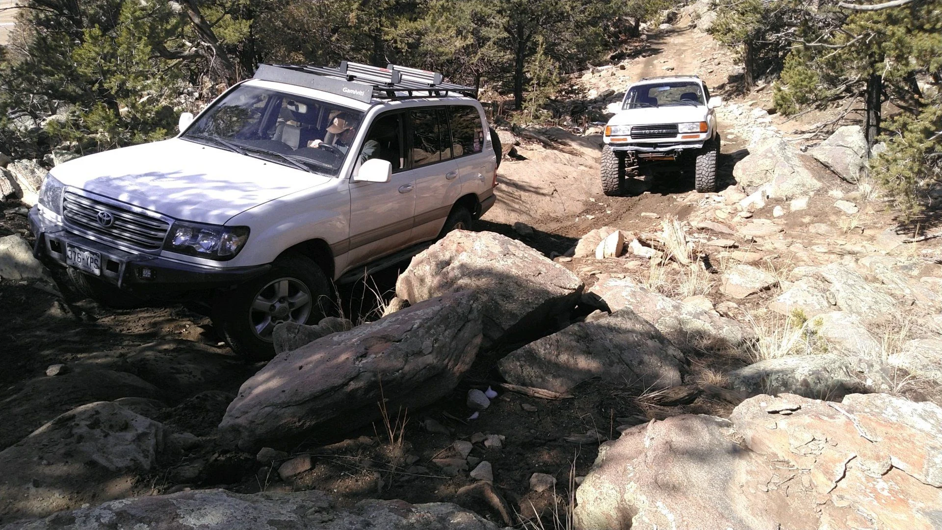

Took her proper wheeling today on Chinaman Gulch. Christened the sliders, rear bumper, transfer case skid, front bumper, RCA mounts, etc etc...It was a blast!
Thank you @TRAIL TAILOR and @benc for making bomber products, kept my baby safe! Unbelievable how capable the 100 is, I was hanging with an 80 on 37s.
Realized my rear locker isn’t working about halfway up, have some electrical investigation to do now.
Hell yeah! Love watching that crawling. Sucks about the locker. Sorry. Wonder what's up with it.

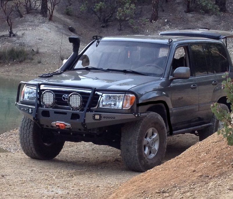

Not my pic but taken from Benc's thread. See my added bar work below!
I'm still running the 285/75R18's, 1-1/4" wheel adapters, no body lift. Can't get into my garage with any more lift. It does rub on occasion but only off-road. Fenders are still intact but the points of contact are the fender lip/upper liner and also sometimes the washer reservoir (even after some trimming). Doesn't really bother me but might, if I was doing more high speed desert driving. It would probably rub a little less with 20mm or 10mm wheel spacers (Motorsport Techniques).
Given your build is already outfitted with bumpers and sliders... you can do a 1" body lift but you won't reap all the benefits unless you modify each bumper/slider, 1" higher. In my mind, the best method would be to just cut the fender arch 1.5" higher, add Dissent's bullbar and get some custom bar work to hide my lack of bodywork skills and also protect the fender. This way your center of gravity remains the same. Could maybe even fit 315/70R18's (36" tire).
