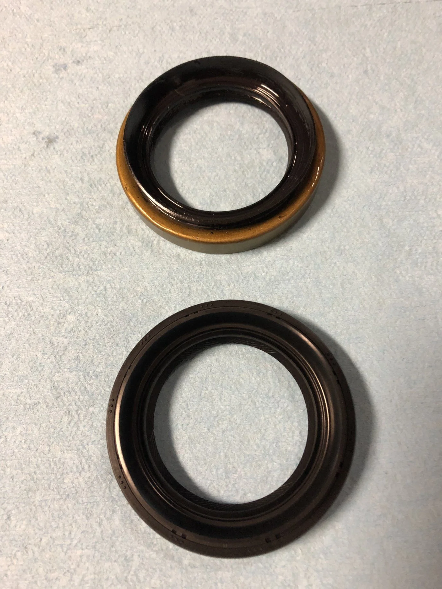

Alright so I went out to my local Yota dealership and bought a new cv axle oil seal for that passenger side. So far so good! Will update in a couple weeks.
Below is a picture of the Napa oil seal with the brass outer ring next to the OEM Toyota seal. Seeing the rubber on the yota seal made me happy!
