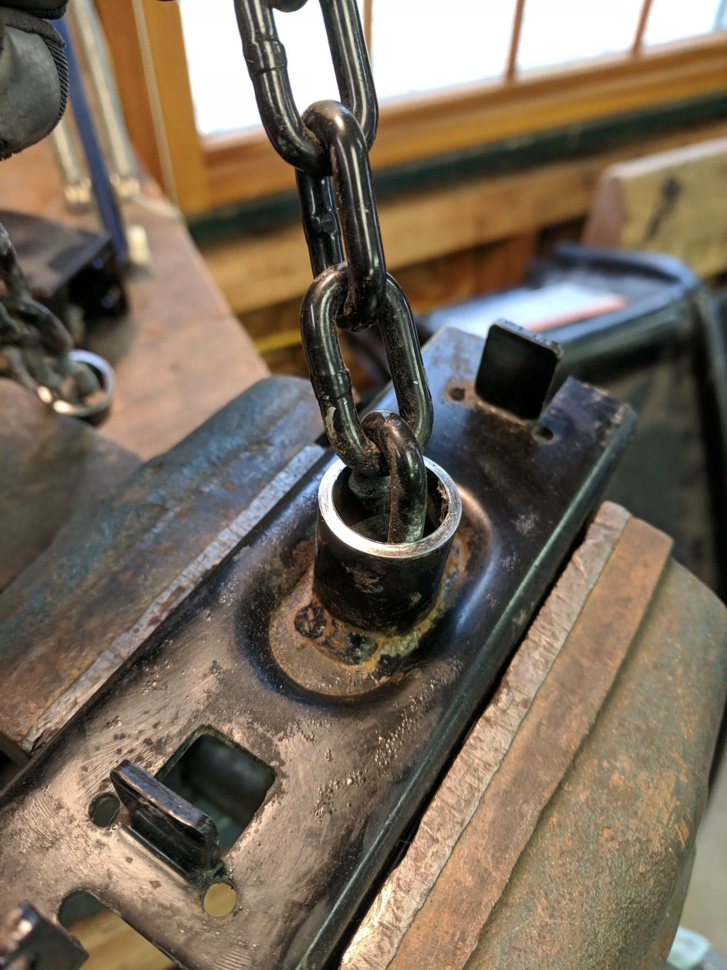

I actually removed the hoist to make the cut, so I could put the thing in a vise. Here's what mine looked like after I cut off a piece. I squirted on a heavy coat of Rustoleum satin black before re-installing.
