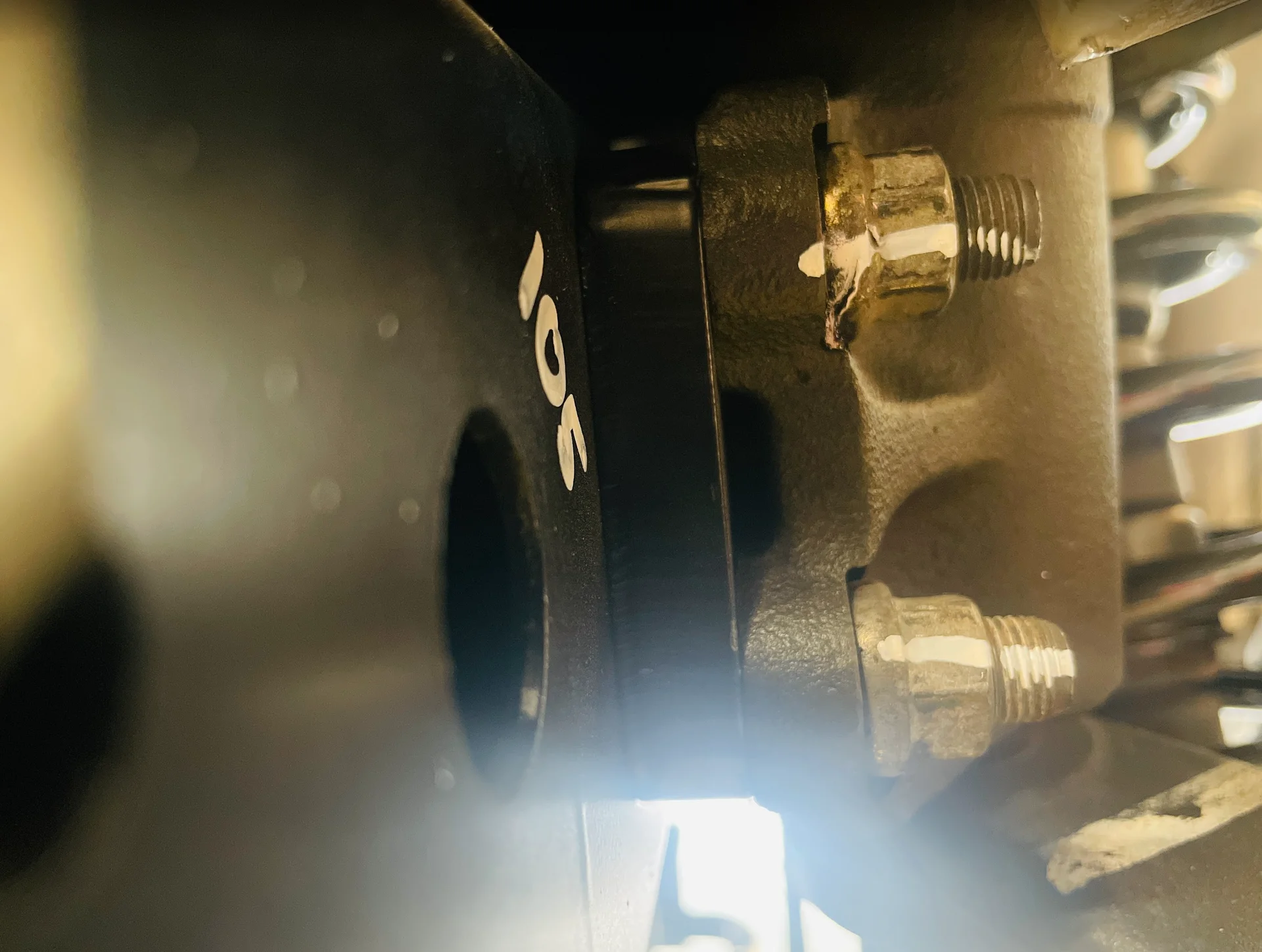

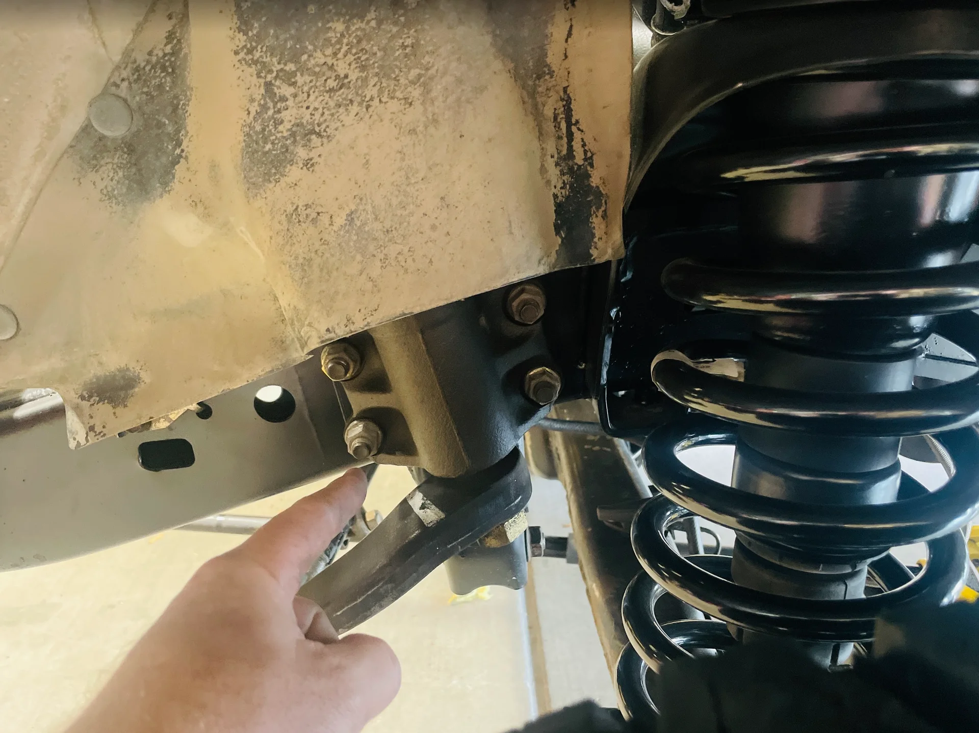

I used the longer bolts supplied and the 1/2 spacer to move the steering box out board by that measure. There was some fettling involved as the clearances were tight, and initially the u-joint contacted the engine bay side of the spring pocket. Lifting the steering box up to eliminate the interference and then torqueing the 4 bolts did the trick. This will be a high priority watch item on the shake down list. If it proves to be an issue, a little massaging will be in order.
In the needed location I have ~2mm clearance.
Red Loctite and final torque of 105lb/ft will call that done.

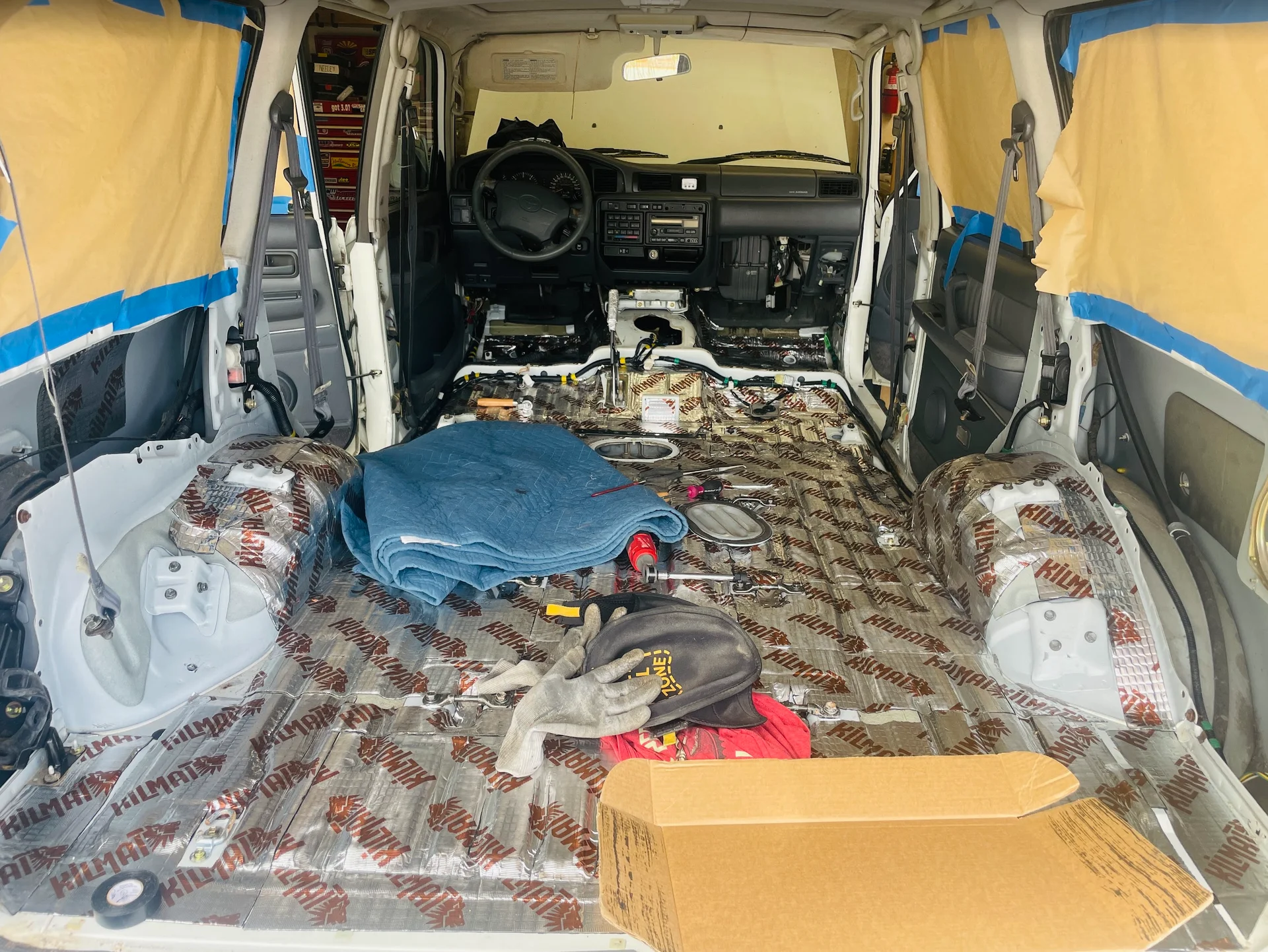

As part of the grand plan of this being my primary long distance tourer, sound attenuation needed to be addressed. I previously ordered two 36sqft boxes of KillaMat off Amazon. While I still think that DynaMat is the premium offering on the market, it is almost 2x the cost and KillaMat is still a butyl rubber product, so performance should be comparable. The really cheap stuff uses a type of asphalt in place of the butyl, and it seems to emit a petrol-esque VOC that I am not a fan of. I also had concerns about it running in high AZ temps, but I can't say that is an actual problem. Two boxes was more than enough to do the floor, and the left over sheets will be used when the final nips and tucks are done in order to close the gaps left at present. For now, I just needed to get enough of it done so I can reinstall the bulk of the interior and get it out of my spare bedroom. That bedroom has been a warehouse for all my project overflows, and I really want to get it back in order.
One note for the general good. All of the sound deadening products I have used are very sticky and in the AZ summer will leave black marks on your shorts if you sit on the edges. Note the moving blanket in the pic. I used it to kneel on as sitting on the bare surface left my shorts sticking to the edges, and knee pads left their mark on the mats.

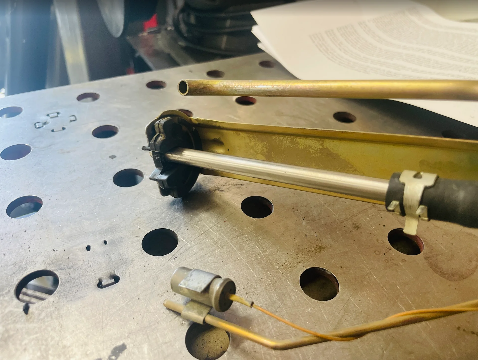

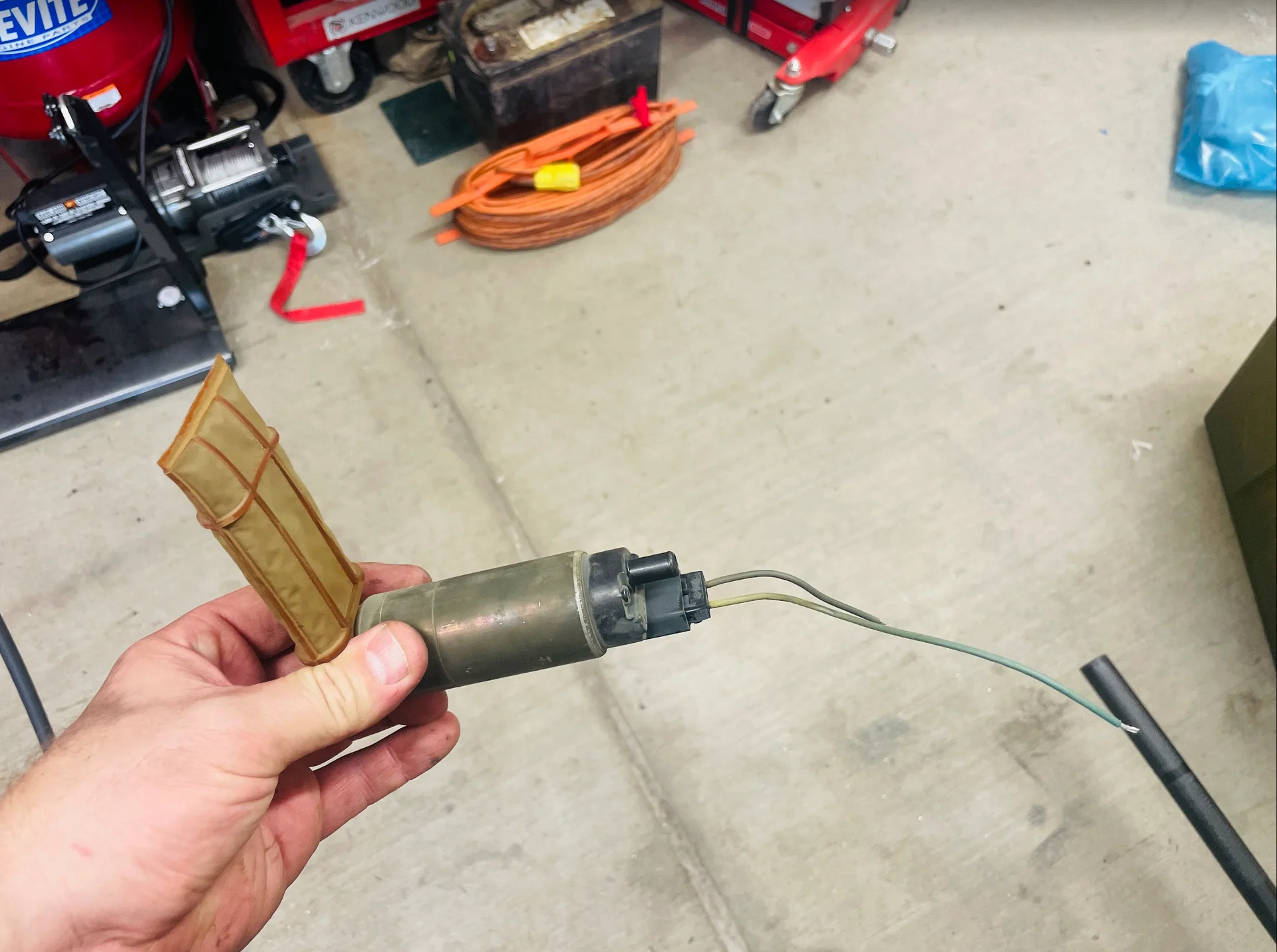

Last note of progress on this update is that I have in tank portion of the fuel system addressed. Since the 12V Cummins uses a block mounted, cam actuated lift pump, there is no need for an in tank fuel pump. Eventually, I will add a powered external fuel filter system as an additional safeguard, but that is a $XXX expense for a later date. You can execute the removal in several ways, but I chose to snip the power wires at the riveted ring terminals, and remove it all together. I bench tested the pump for flow and current draw, and it appears to be a 100% good spare. It'll go in my pack out for Lexi Jo.

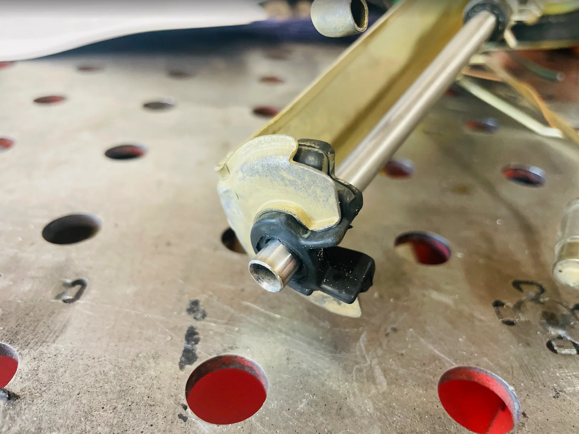

Fuel pump removed, and put the stainless steel pick up tube in its place.
Instructions were to crimp the foot closed with pliers, but I like the use of the factory damper instead. I centered the tube and tapped it through the rubber damper allowing the tube to cut its own path. I may have to revisit this to ensure my clearance between tube and fuel sump is good, but that is easy to do.

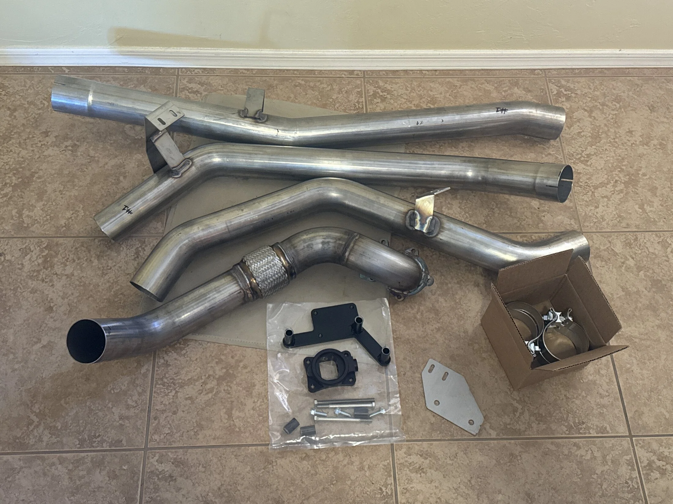

Finally!!! I got some parts to move forward on this again. Been a long wait for parts, but Dustin does great work. Looking forward to getting these installed and hoping to have Clappy on the road in January. Gotta have stated goals, or you will just be quietly wishing to yourself. Shown here is a bolt in 304 Stainless exhaust, sans muffler which is coming, and the T-Case shifter mount.
