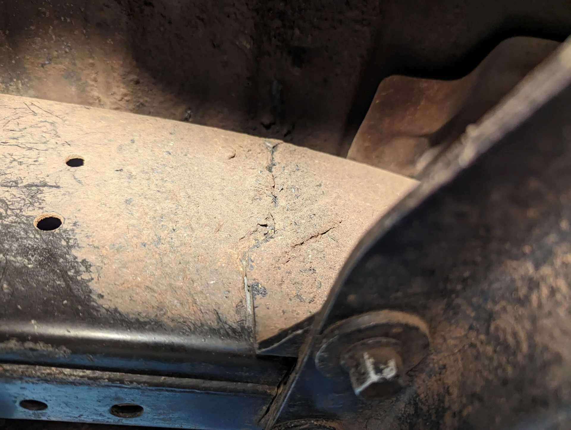

Sorry, not offhand. I found them searching for steering box reinforcement, or maybe panhard mount reinforcement. Might even be some kits at US suppliers, but it seems like it was a couple of Aussie kits in particular that I saw that addressed the PBCM passenger-side mount. I don't know if you are aware of the semi-common issue of the frame cracking around the steering box and panhard mount on off-roaded 80's, but having dealt with it myself in situ it's something I will preemptively address if I have the engine out on any 80 I plan to wheel. Typically it's some plating to add around the mounts, and some bracing. @richardlillard1 has shown me some graphic pics of the passenger side failures, they aren't pretty. There's a lot of stress on those areas.

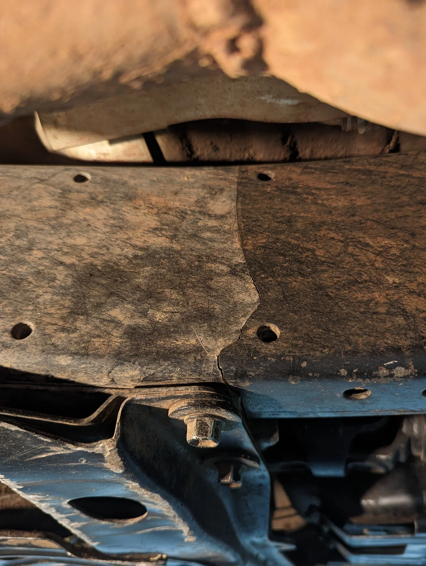

Something else to pack onto the snowball- with extended abuse, both frame rails can crack just in front of the transmission crossmember. I believe it to be a factor of the front suspension twisting the frame, and the crossmember fighting the twist. Here's my passenger side- look close, it's cracked all the way around, except for about a half-inch on the top that you can't see.

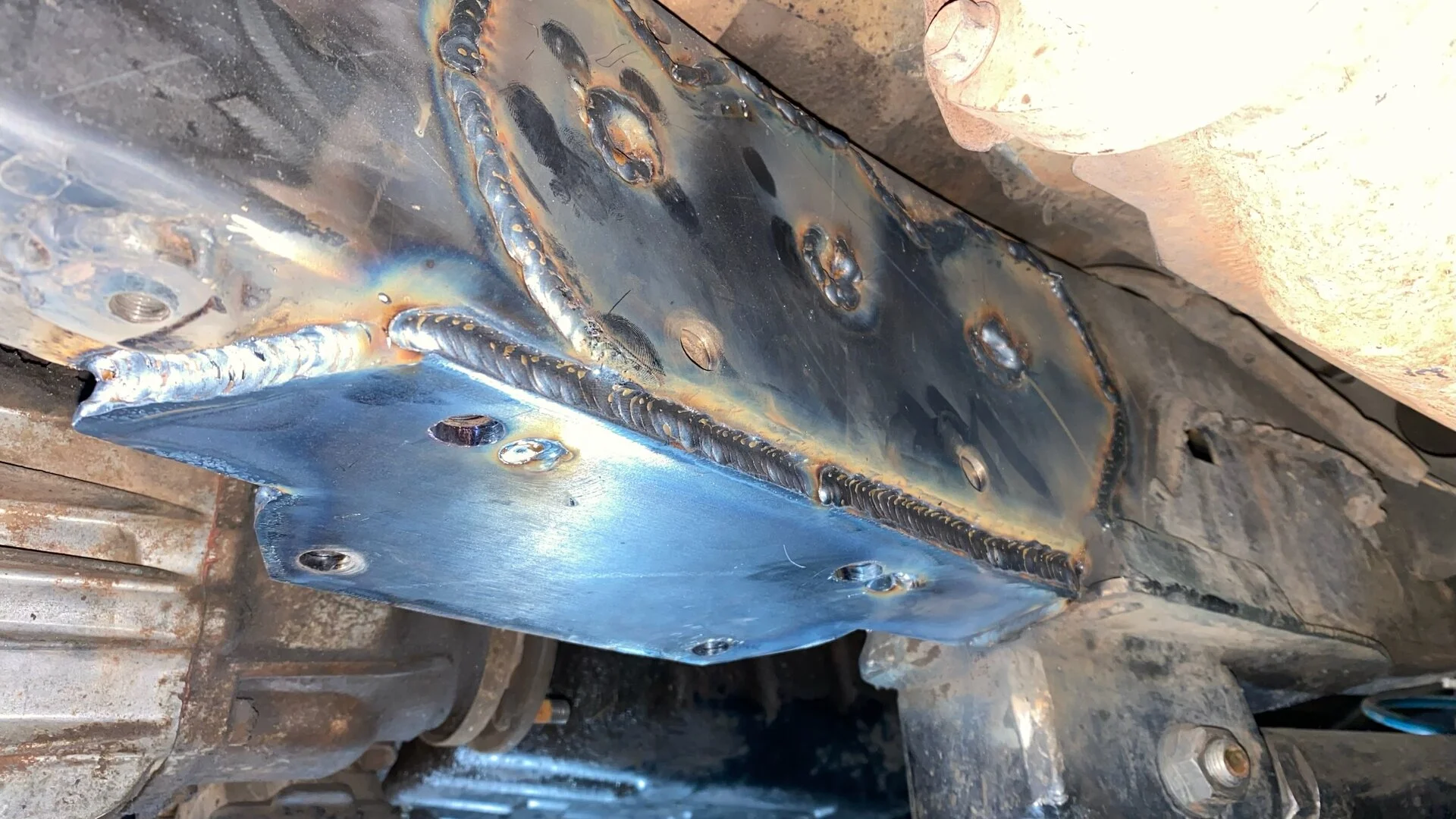

Here's a pic of the bottom and outside repair for a crack in the same area on @richardlillard1 's truck. (We are the definition of 80 abusers...)

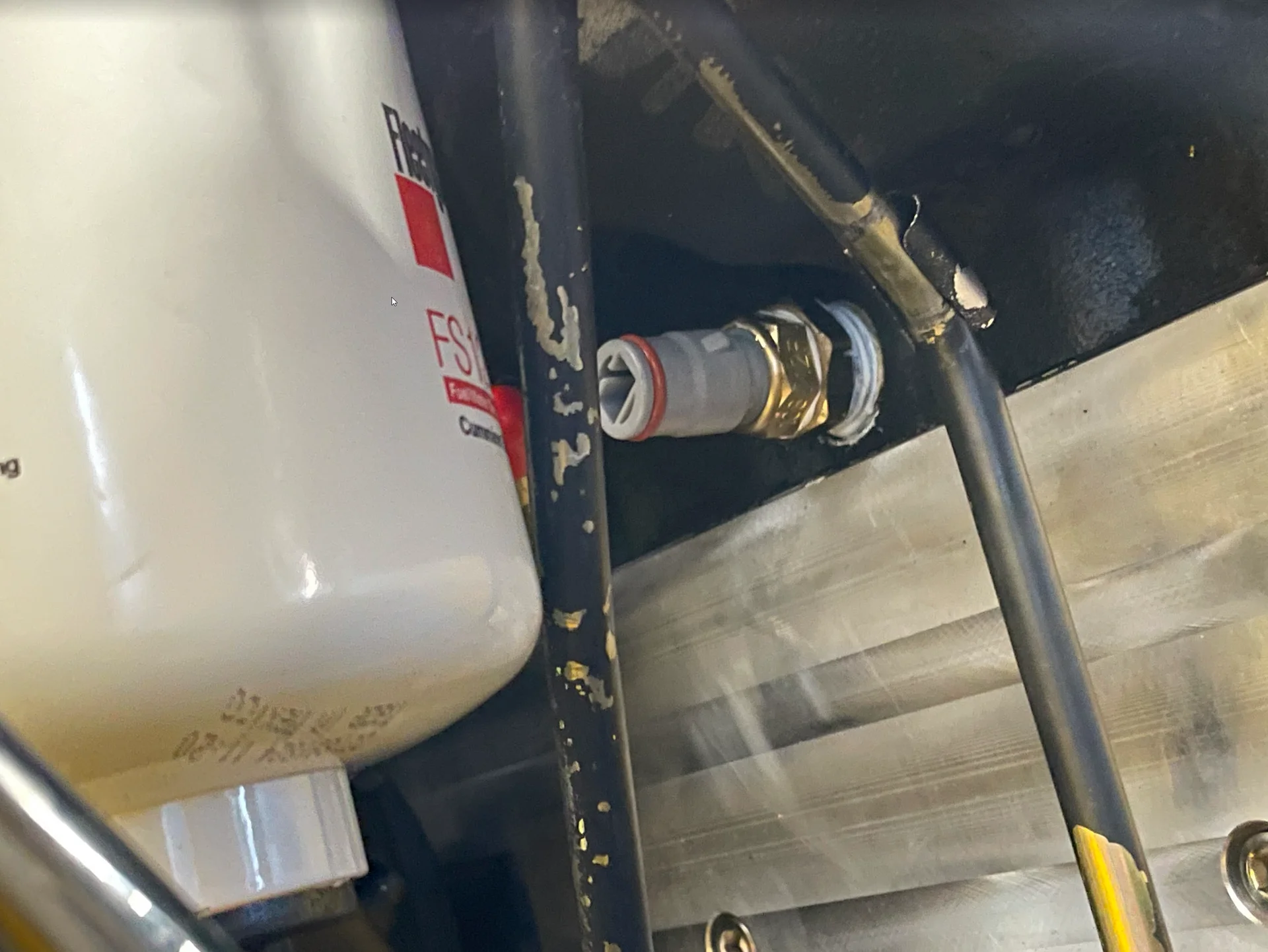

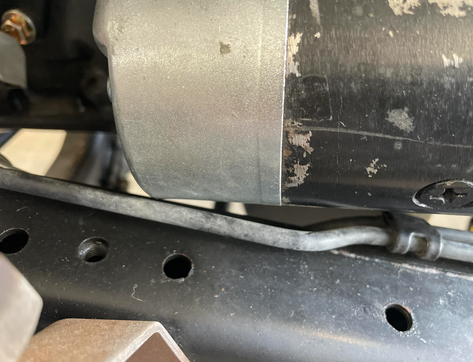

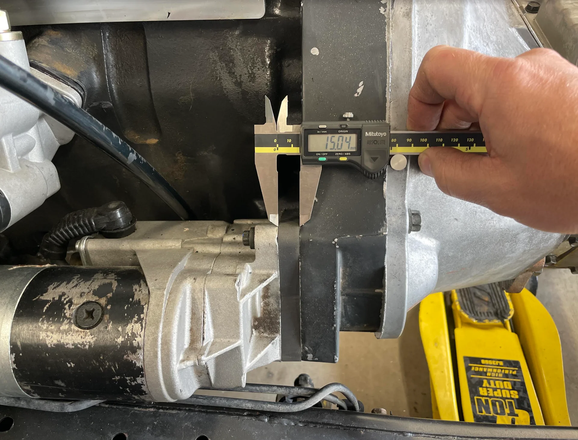

I had enough of work this afternoon and needed a break, so to the Bat Cave I went. I have been scatterbrained and random on my efforts here as of late, so there is a large pile of project barf all over the garage. Let's see...I ordered a 6.7 started to replace the 5.9 one. The swap requires the use of the long and skinny 6.7 starter in place of the short and stubby 5.9 starter. I didn't get the new one on yet but here is a few pics of how tight the 5.9 is with the LUK Repset spacer.

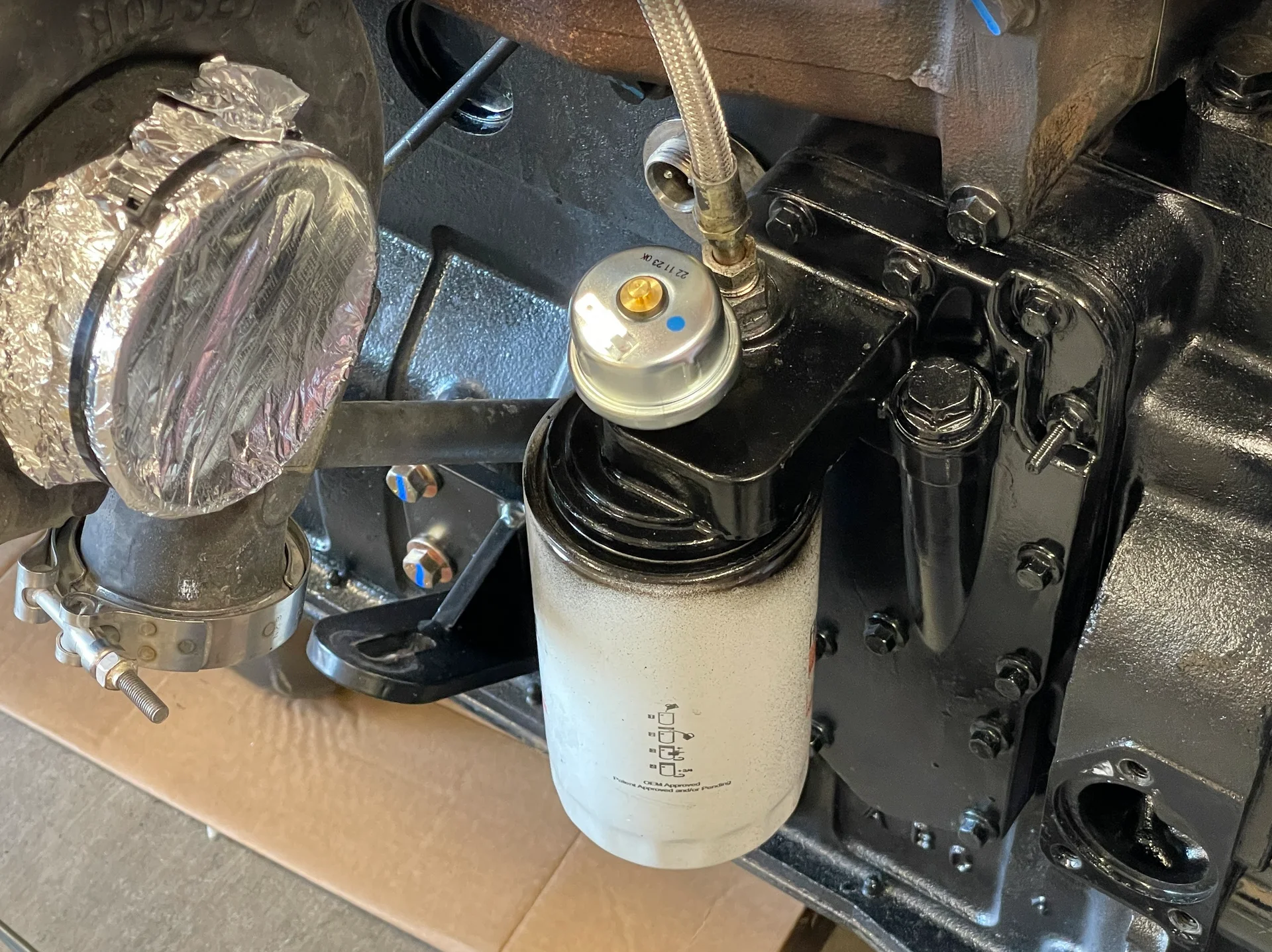

While I had the credit card out for the Rock Auto order, I went ahead and hit Partsouq and got a set of new OEM sensors on the way. Those arrived this week, so in they went.
Oil pressure sender:
AC Cutout Switch

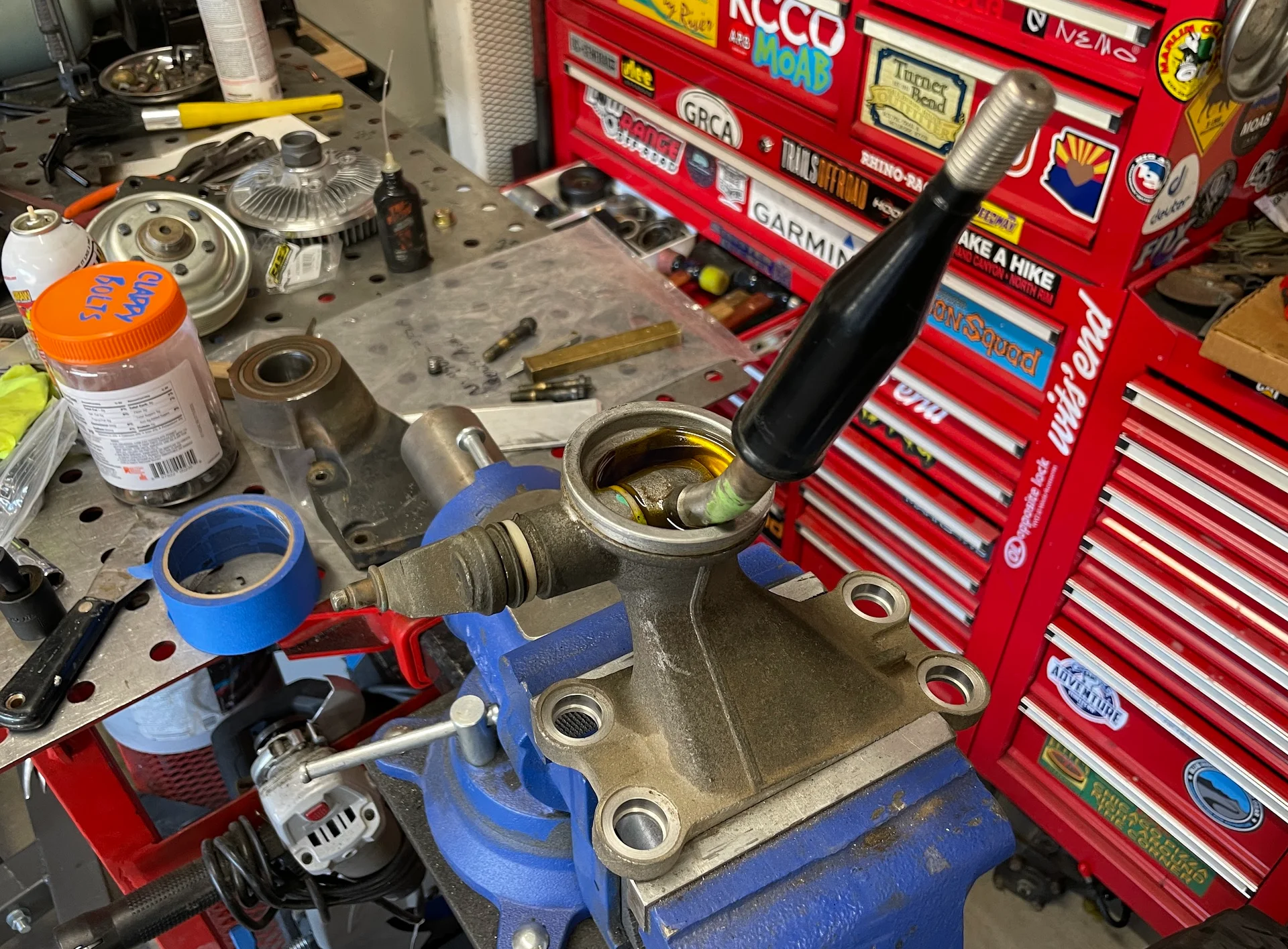

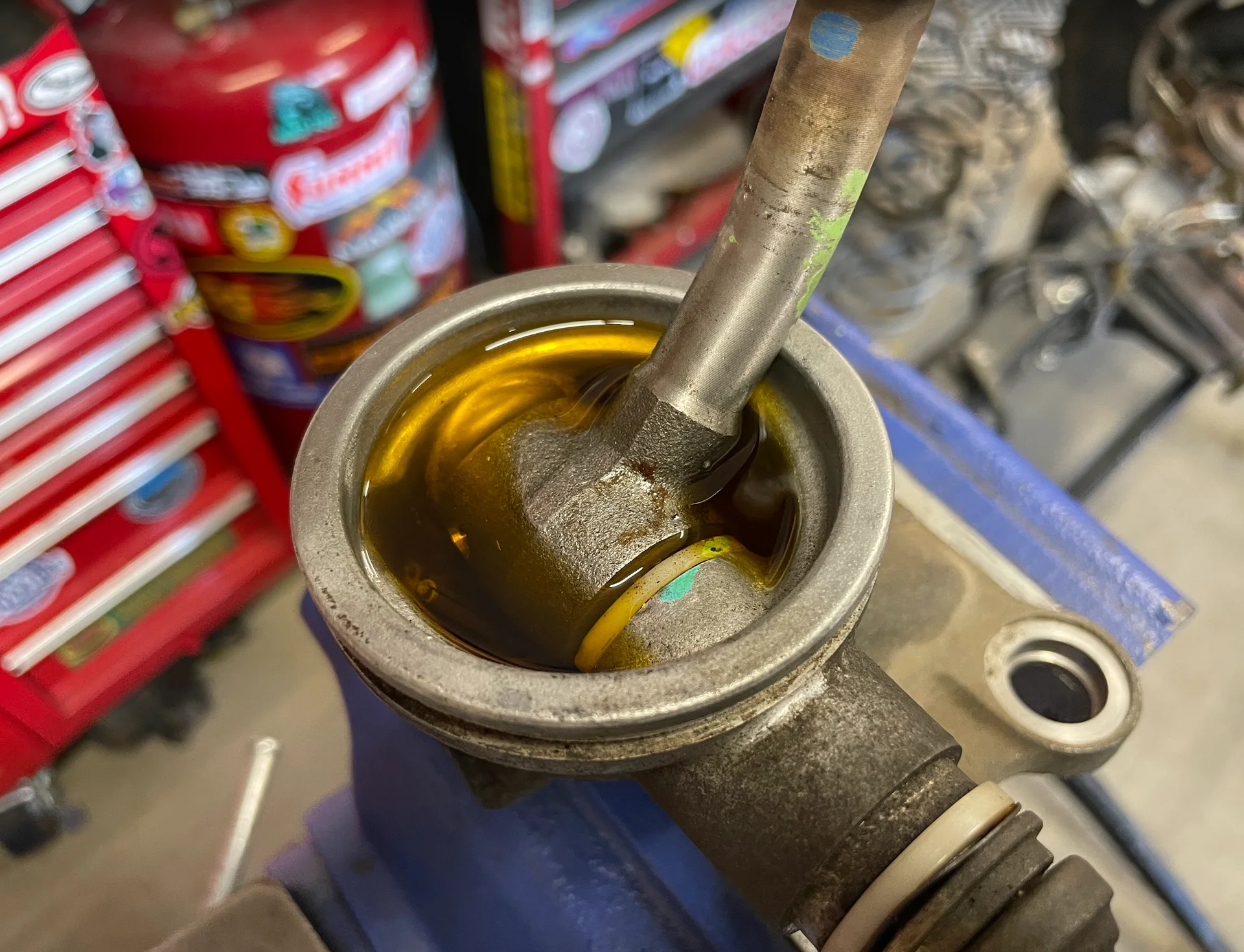

I got the t-case shifter out and started working on loosening it up a bit too. When I first bought the rig, I noticed that the lever was super stiff, likely from years of never being used. I tried to disassemble it, but after driving out the roll pin and trying to work it back and forth, I came up goose egg. That thing is seriously stuck in there. I filled the cavity with penetrating oil and have left it sitting for a few days, working it back and forth whenever I walk past it. It has just barely started to free up. Open to ideas if you got some to spare.

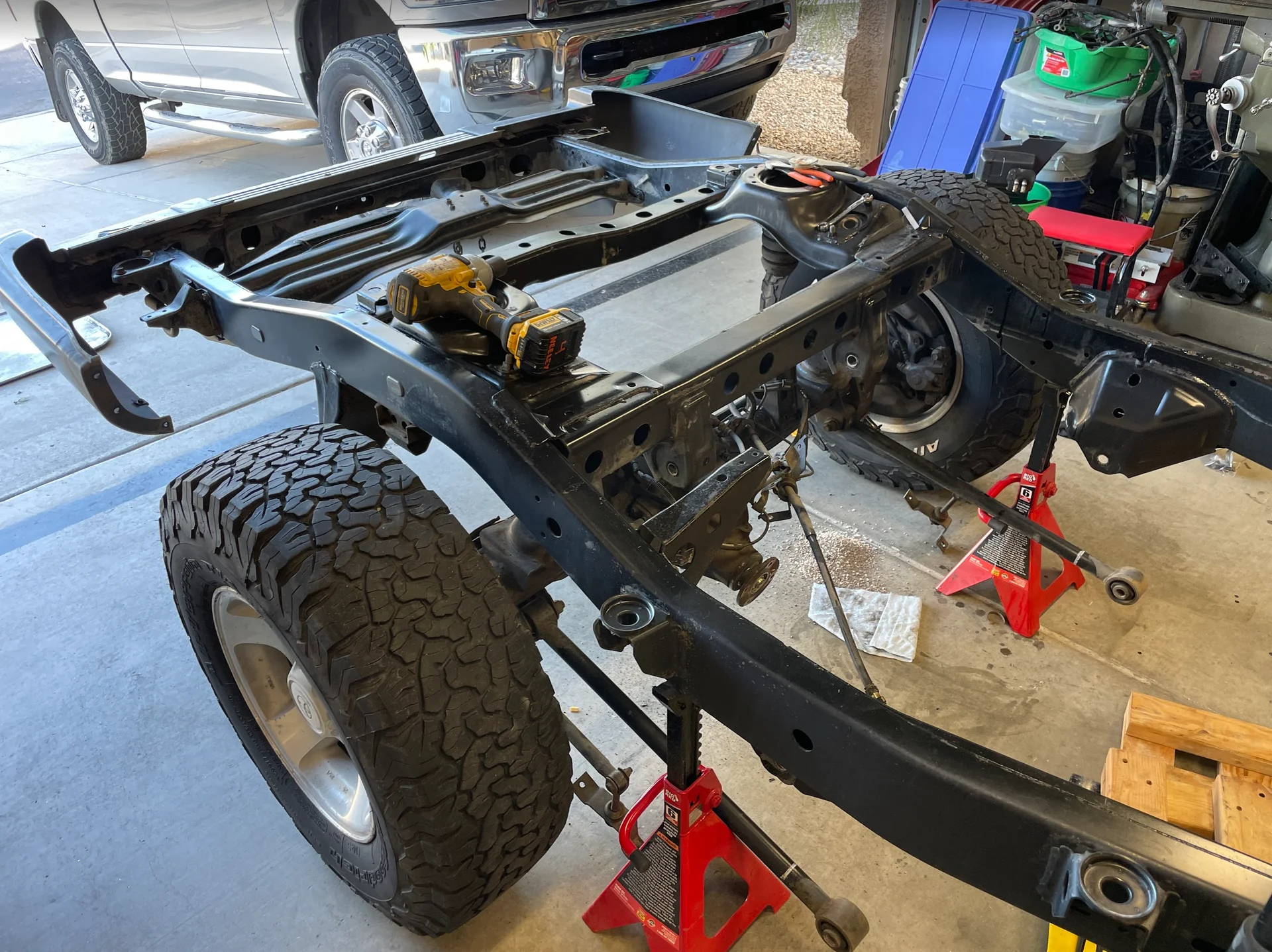

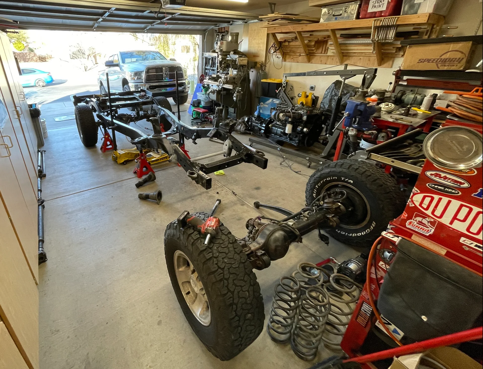

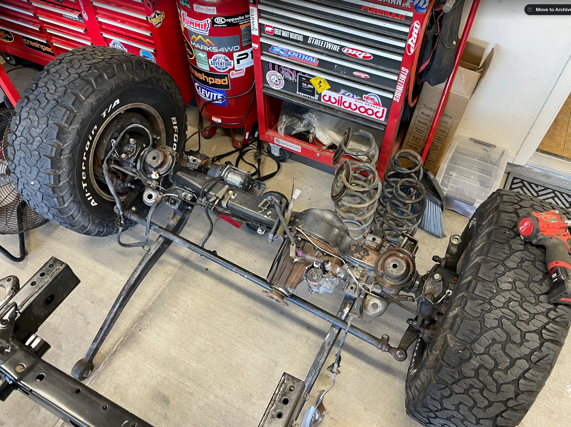

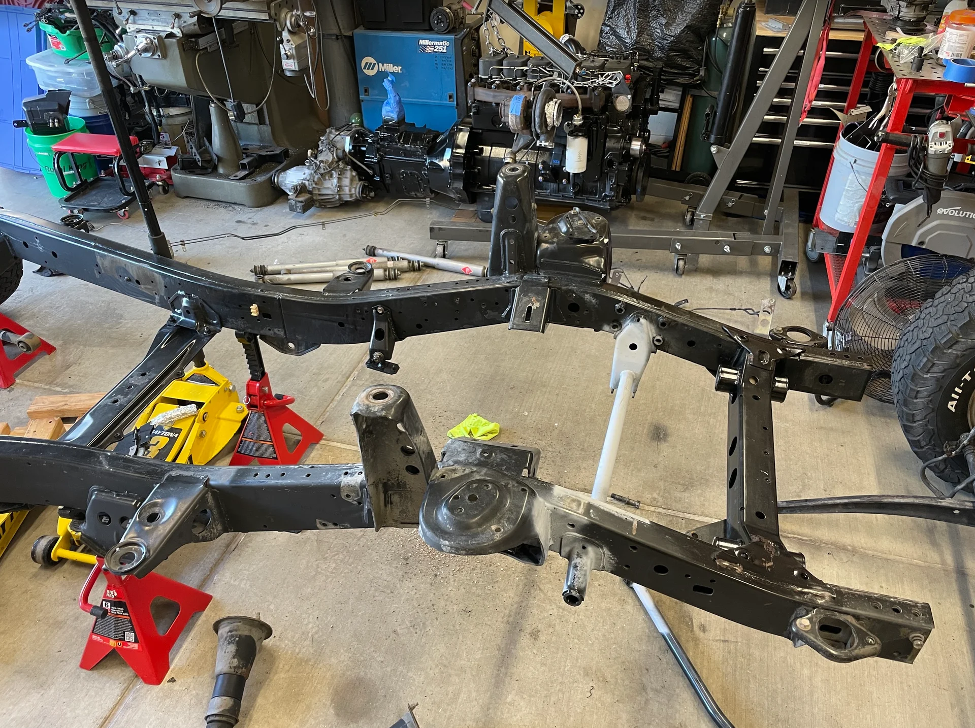

So, back to the current day and my OCD got the better of me. I decided, finally, that I was going to take the frame down to baseline. Everything must go! I got it all stripped down and will find some order in the garage to facilitate turning the frame up on its side to wire wheel all the specs of rust and metal, spray them with rust neutralizing primer, and then lay on a couple coats of satin chassis enamel. Needed? No, but it does satisfy my OCD and give me the satisfaction of knowing that nothing was left unchecked. This also gives me the chance to strip the axles and give them the same treatment, because they look like two terds hanging off the pretty frame. It all had to come apart anyway, so why not?
Wheelbase stretch?
Clean front end
Front turd out
Rear turd not quite out, yet. Fully disconnected, but the frame has to come up to clear the tires.

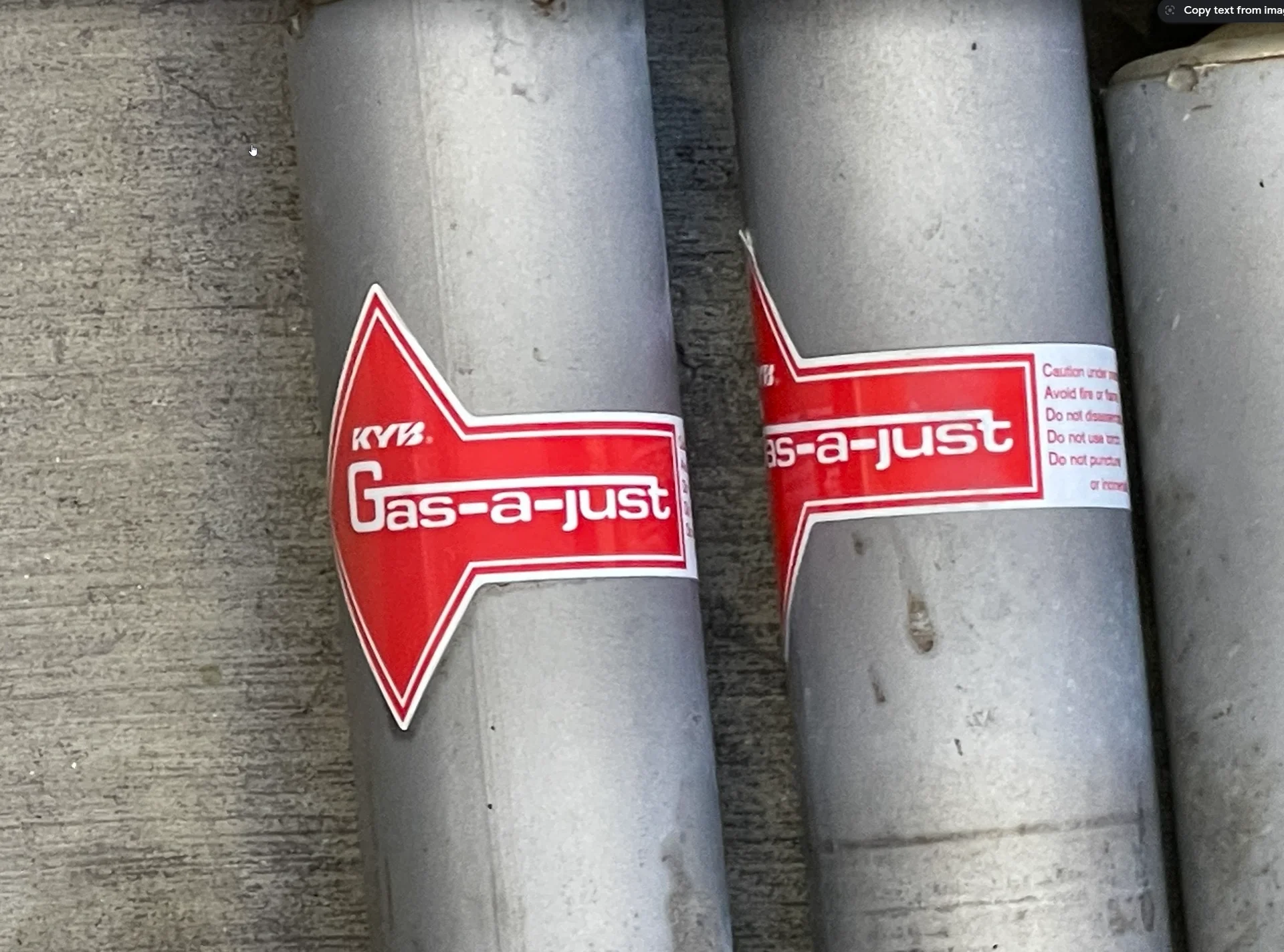

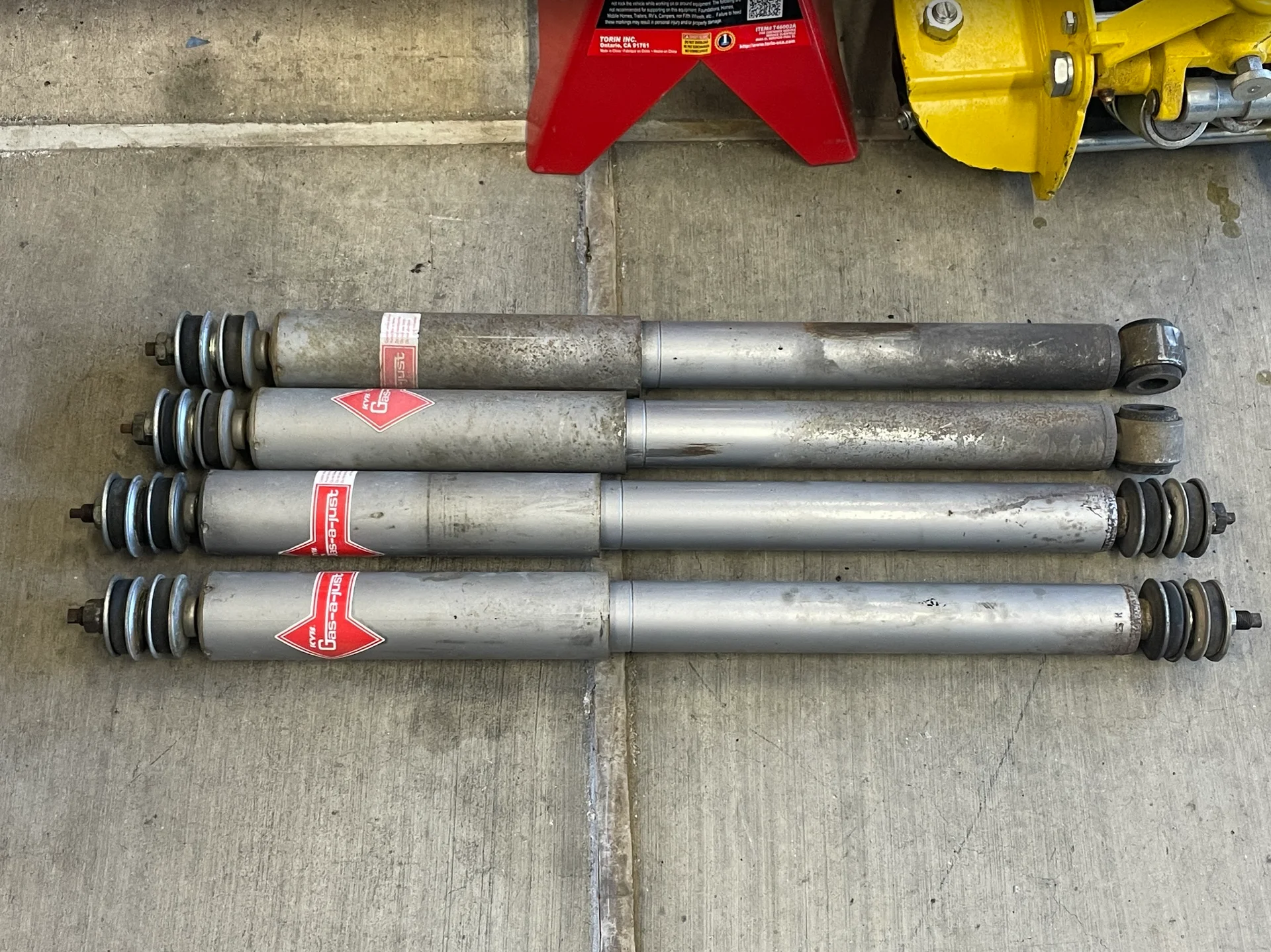

Anyone want a set of KYB shock for an 80?
