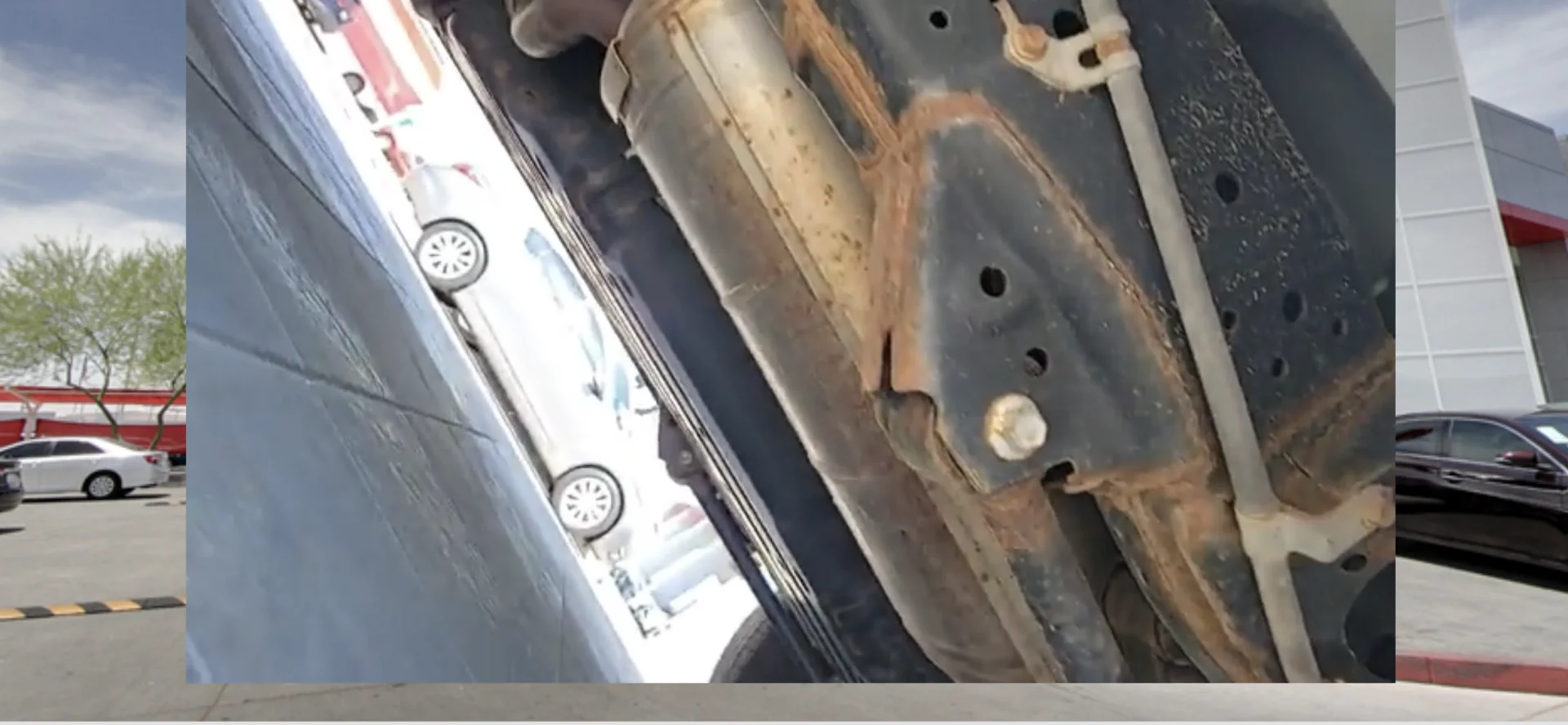

I have been looking for a LC for a couple of years now and always seem to be too late to grab the good ones that occasionally go up for sale in Phoenix. I am not desperate for a LC as I have a 16 4Runner trail premium as my DD and I love it but always have had a soft spot for LC's. I found a '16 LC at Camelback Toyota here in PHX that at first glance looks decent until I got the Sales guy to send me the undercarriage pics.... The truck was originally from Pittsburg PA which immediately turned me off as I know all about the damage to cars in New England from Salt and whatever else they are using to spray the roads in the winter. The dealer is offering the truck as a Toyota Certified vehicle. It currently has 74k miles on it which is nothing for a LC but I wanted to get some opinions from others on the amount of rust/salt damage and if this is pointless to even consider. My biggest concerns are the KDSS lines and fittings on the frame and I was also reading on this forum about the KDSS valve on the canister rusting on LC's for owners on East Coast and Midwest. Several of my friends who have 80,100, 200 series are telling my no F*&^%$# way don't buy it and not that I don't appreciate and value their input but just wanted to get some others thoughts on if this 200 is a lost cause.
Video from TONY TORRES - Camelback Toyota - https://vidmails.com/v/t8u35M8NL6 frame/rust issues are at 1:40 in the video and they only sent me the drivers side images

I can not imagine having a vehicle from PA when you live in AZ. More damage is done to the undercarriage in the first winter in PA than a lifetime in AZ. But that's opinion and you really need to go crawl all over the vehicle and judge for yourself.

I don’t think it’s a lost cause. It‘s treatable rust. I’d make the decision based on other things. I have no knowledge of how hard these are to find in AZ, but they must be a bit scarce if a dealer is getting them from PA. It’s a big plus to me it’s a CPO.

Wire brush on an angle grinder and some Boeshield and you are good to go. Overpay for a rust-free example or buy a new one are other alternatives. Everything is a trade off. The previous owner likely didn’t do annual maintenance on welds - most normal people don’t. Land Cruisers operate around the world in extreme environments. To the best of my knowledge, frames rusting out is typically not what does them in. There are companies that take all of the rust off of 40 frames, galvanize them and they’re good to go for another 50 years. That rust in the video, especially if addressed now, will not affect your time in the vehicle (or the next couple of owners). Your money and decision, but these rust related hand-wringing posts always crack me up. I recommend driving it. See if it feels solid or is creaking like it’s on its last legs. You might find it to be a nice runner. The CPO should cover the KDSS and other systems.

Lol… wire brush and boeshield aren’t fixing LCA or exhaust bolts seizing and breaking.
I watched a different video. Front and rear LCA bolts are galvanized and look to be in good shape.
Having said that, it’s still over-priced in my opinion.
I watched a different video. Front and rear LCA bolts are galvanized and look to be in good shape. View attachment 2713205View attachment 2713206Having said that, it’s still over-priced in my opinion.
The bolt heads often look fine but the non-galvanized inner bushing sleeves are actually rusted solid to the bolt and subframe. Not to mention the exhaust.
Point is, on a rust-free vehicle, none of this is an issue, even if you can address the frame rust on a rig with elbow grease and special treatments.
