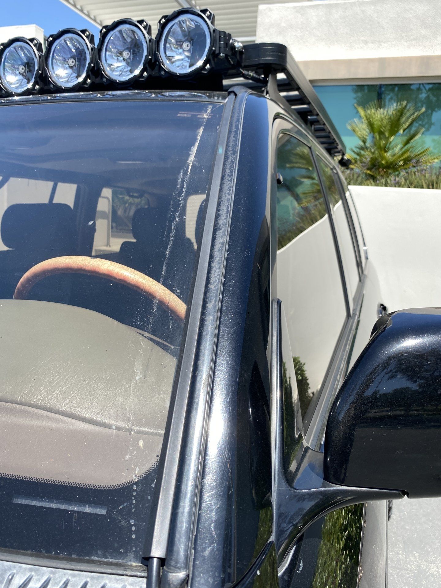

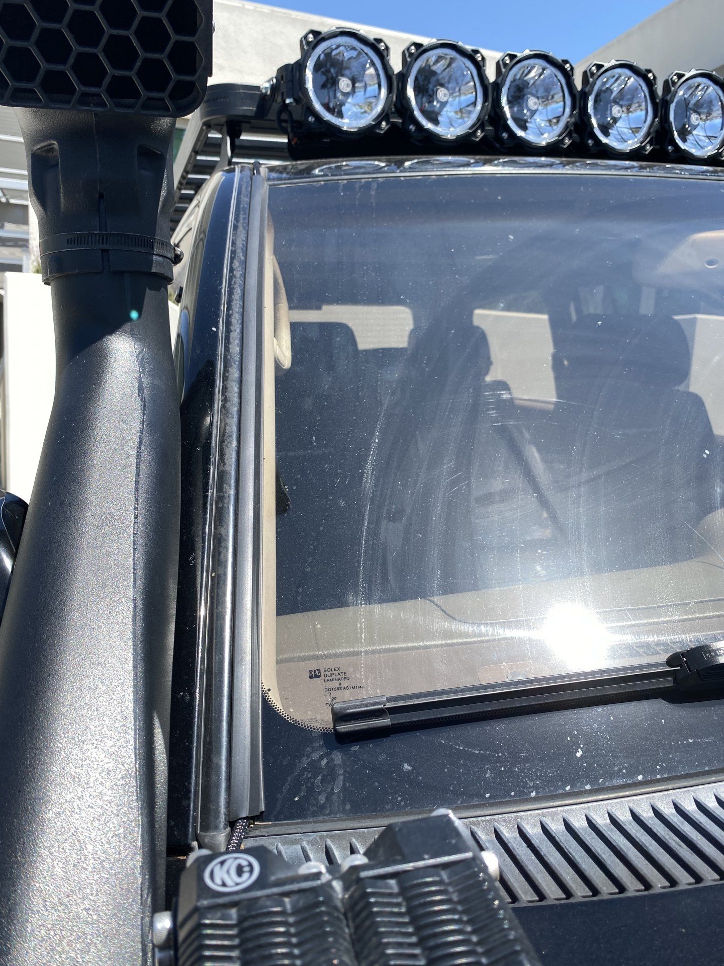

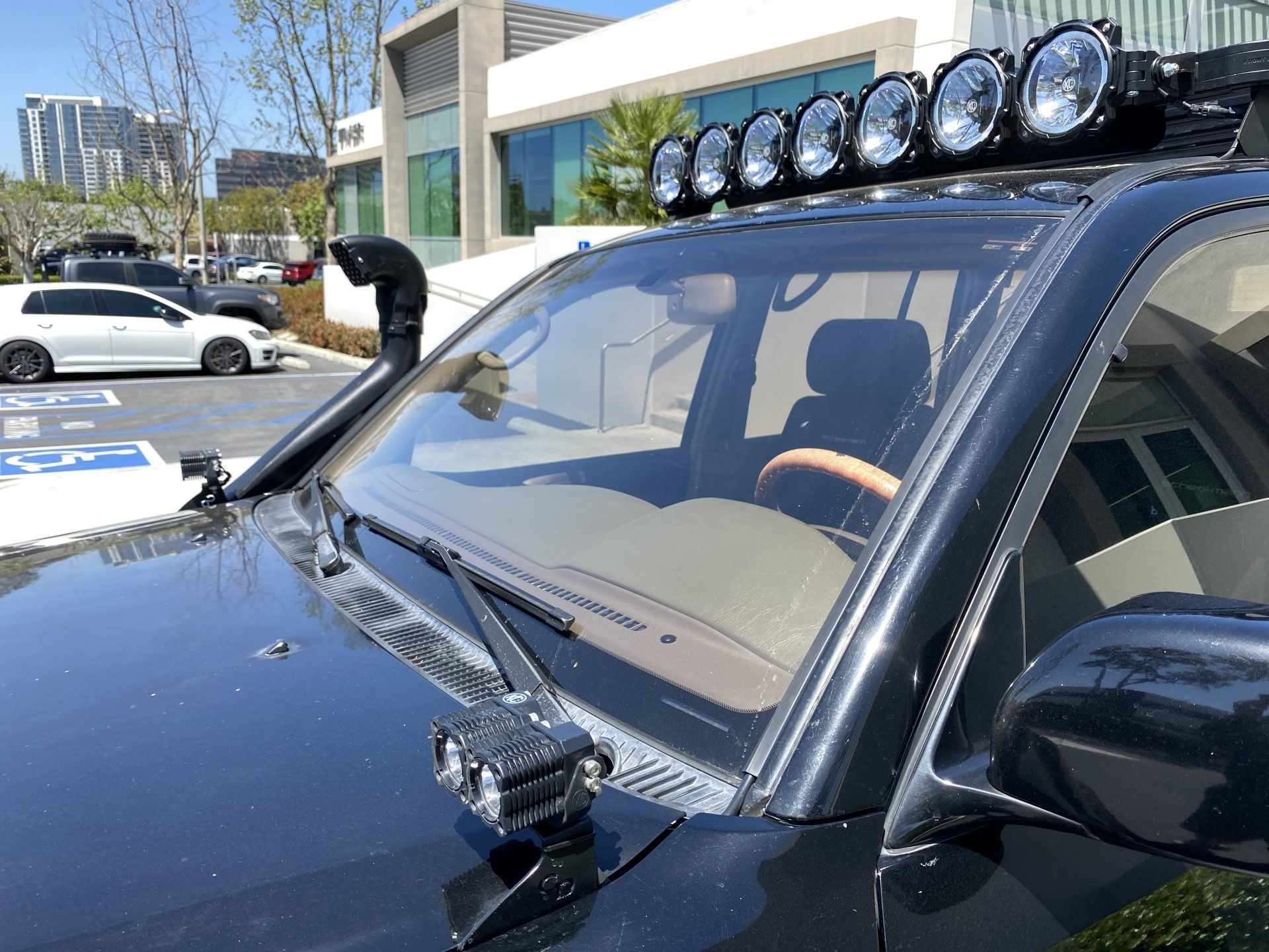

I used some braded sleeving and these cable clips. You can't see it from inside the vehicle, and I really don't notice it from outside. The adhesive on the clips does seem to be genuine 3m VHB.
I do live in SoCal, so water and snow aren't something I need to worry about very often. I do have a drip loop in the engine compartment, so that when water does follow down the sleeving, it won't go back to my relay box.
Right now I only have a single 14 gauge wire going up to the rack for camp lights. Plenty of room to add a 2nd though.
**please forgive the dirty windshield.
