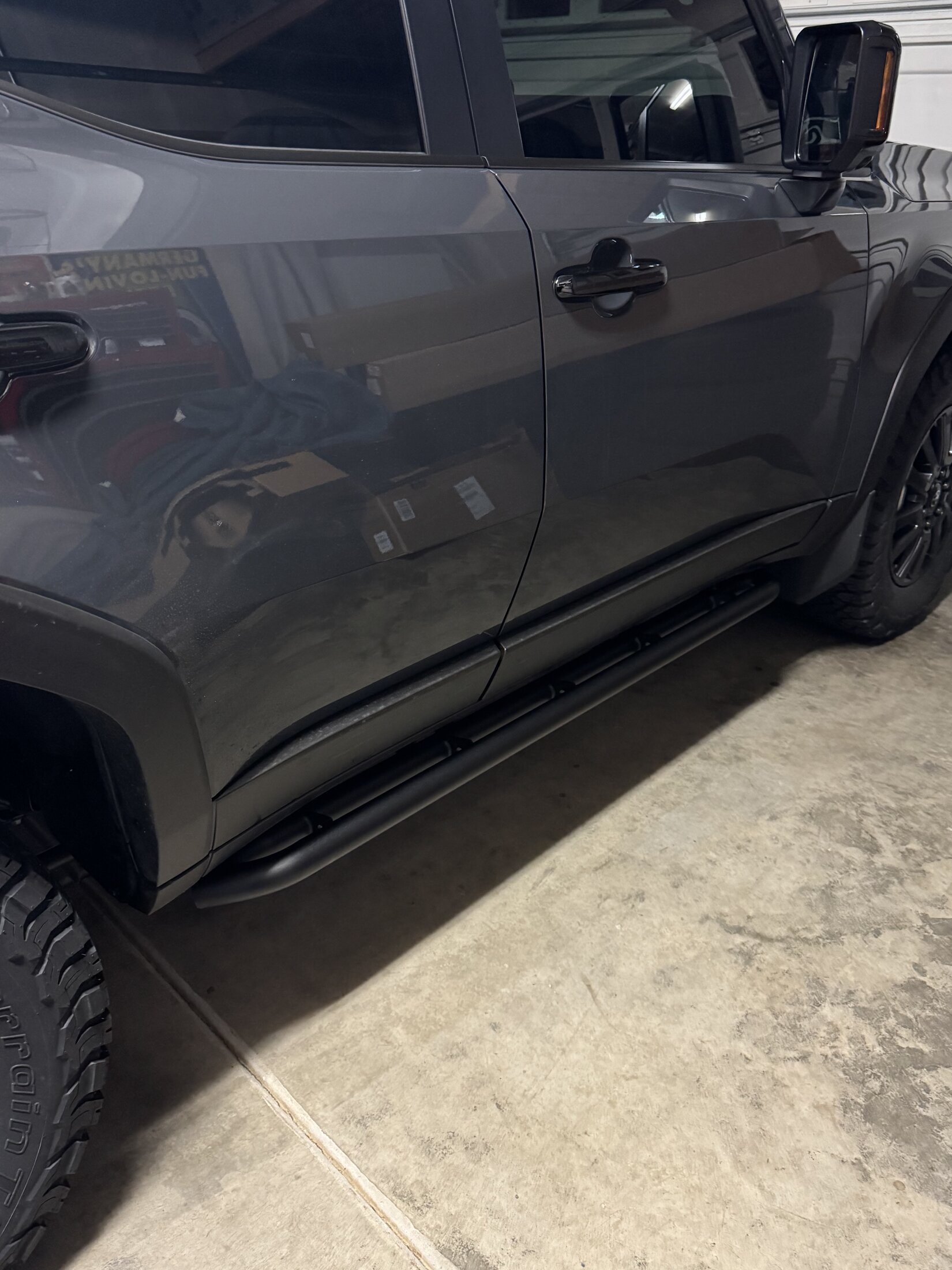

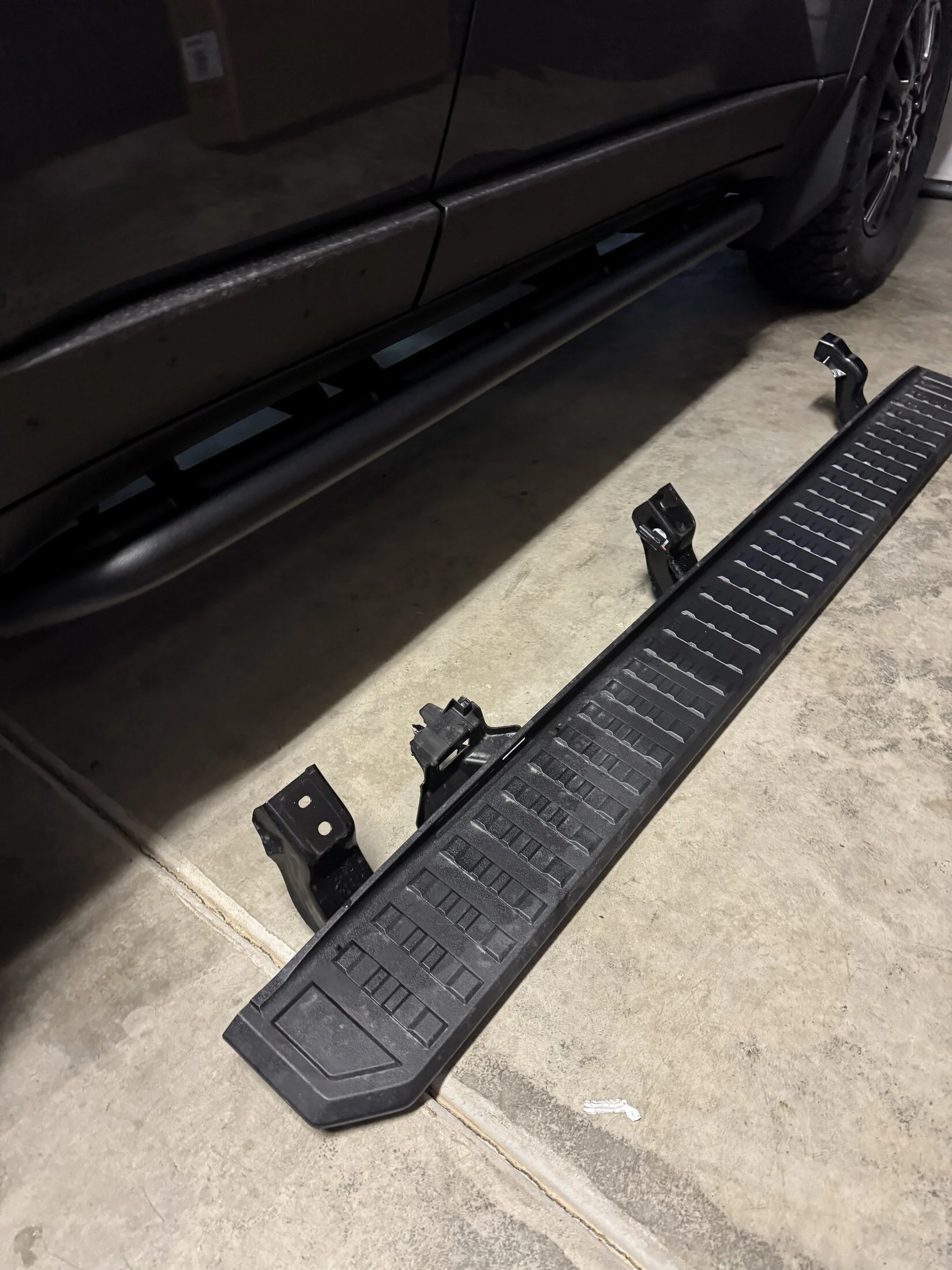

I just installed the Toyota OEM Rock Rails (PT228-60240 & PT228-60241). I took the OEM running boards off, huge improvement IMO.
I agree, that looks much better. I’m looking to do the same. How much did you pay for your OEM sliders? Also, did you buy them new or second-hand?
I bought new from TOYOTA @ $402 each plus tax. Super easy bolt onto frame install.
Anyone have any experience using the OEM sliders? Guessing they are not DOM tubes, but I am also not rock crawling with the 250 like I am with the 40. Just want to feel confident that if I am in a position where I take a hit, I can replace the slider and not have it bend into the body.
