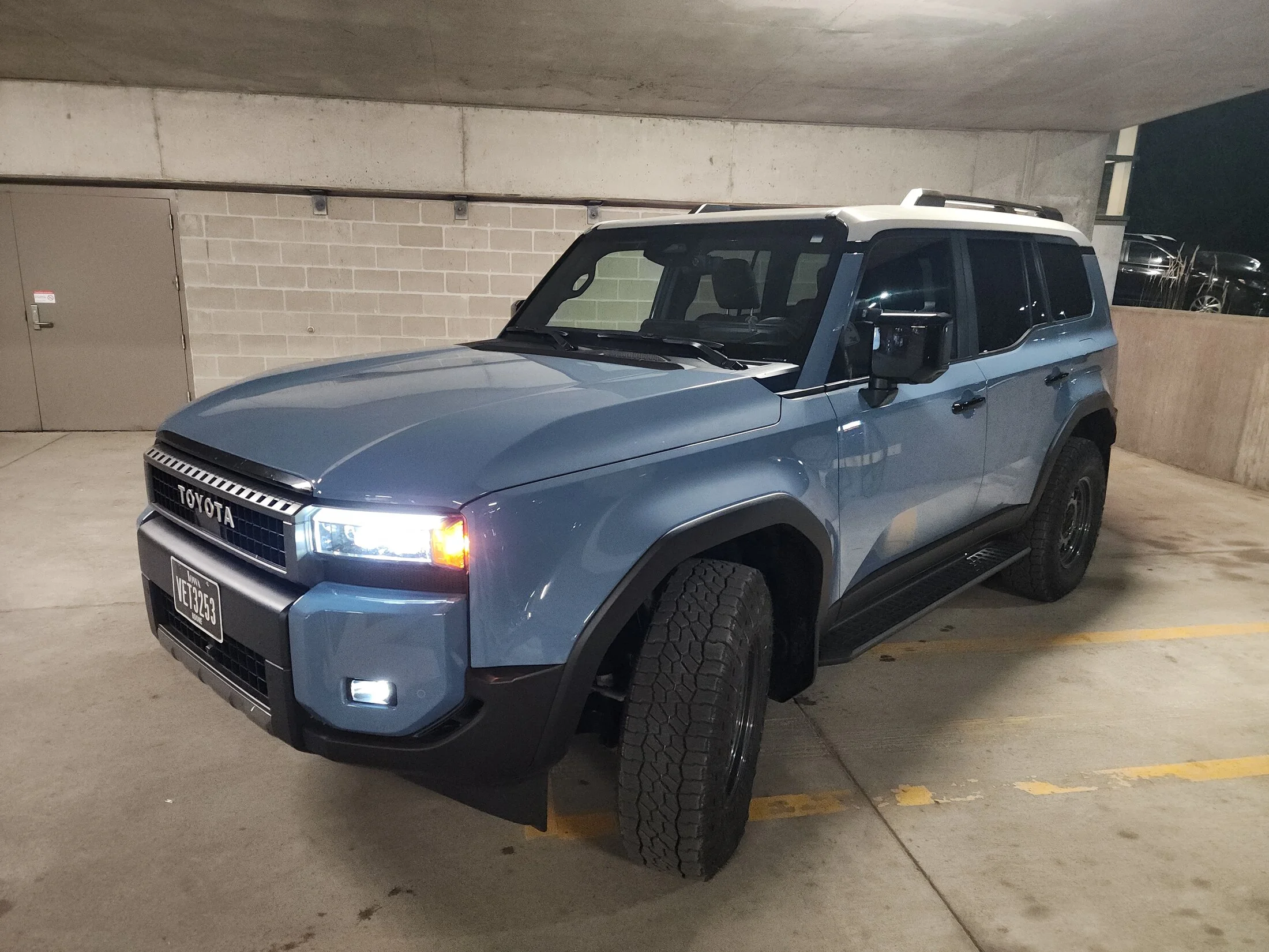

35x10.50r17 with +40 offset probably fit stock height without any cutting.

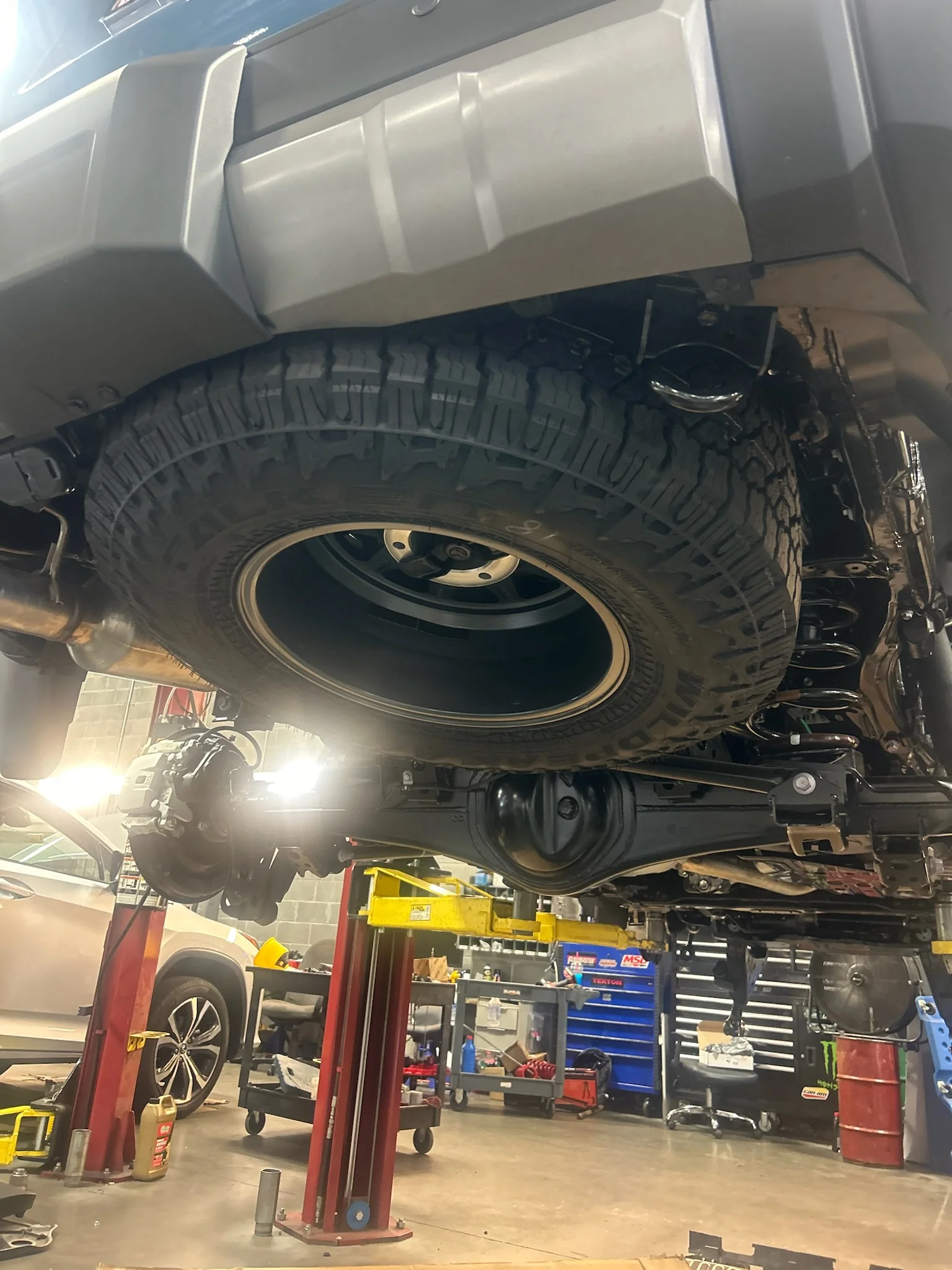

Just to confirm. does the 255/80R17 tuck into the OEM spare location under the truck?

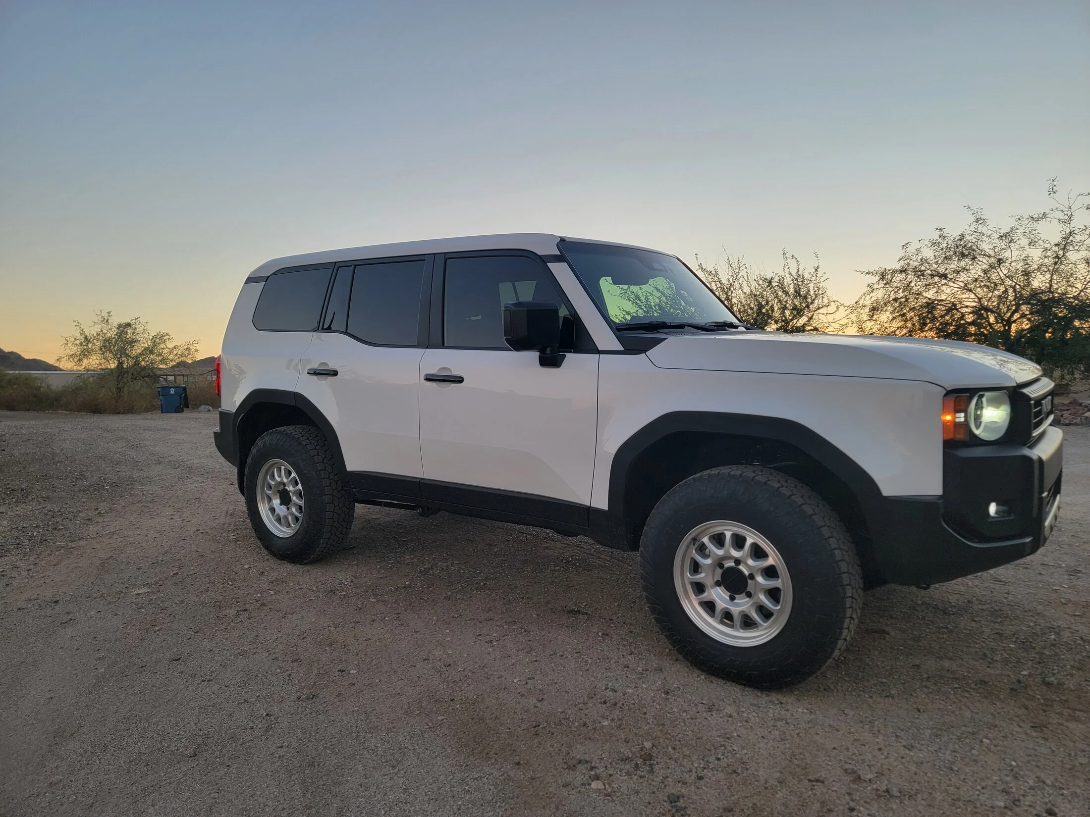

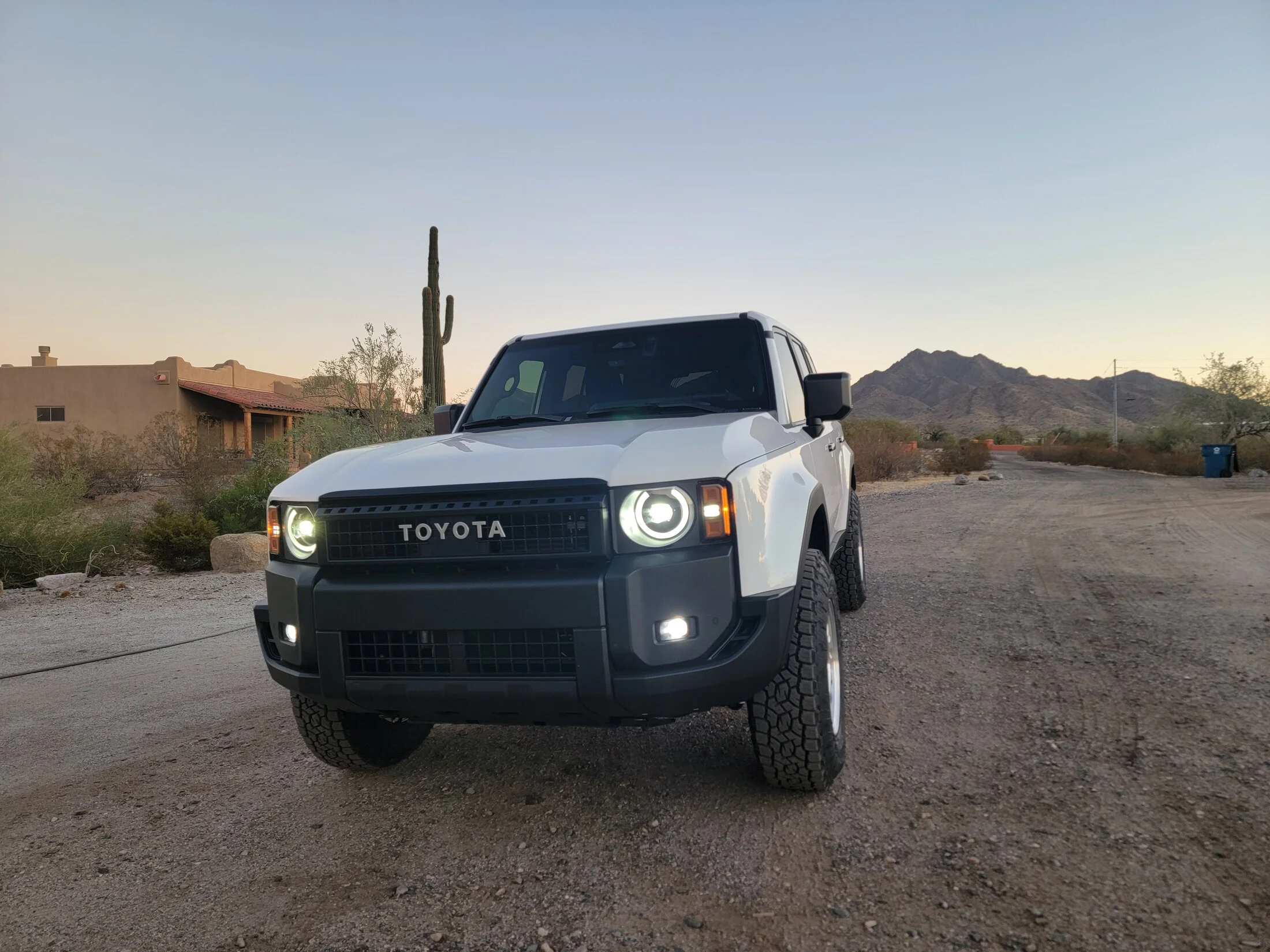

Another 255/80R17 on RRW RR5-H Flow forms 17x8.5 +25mm
