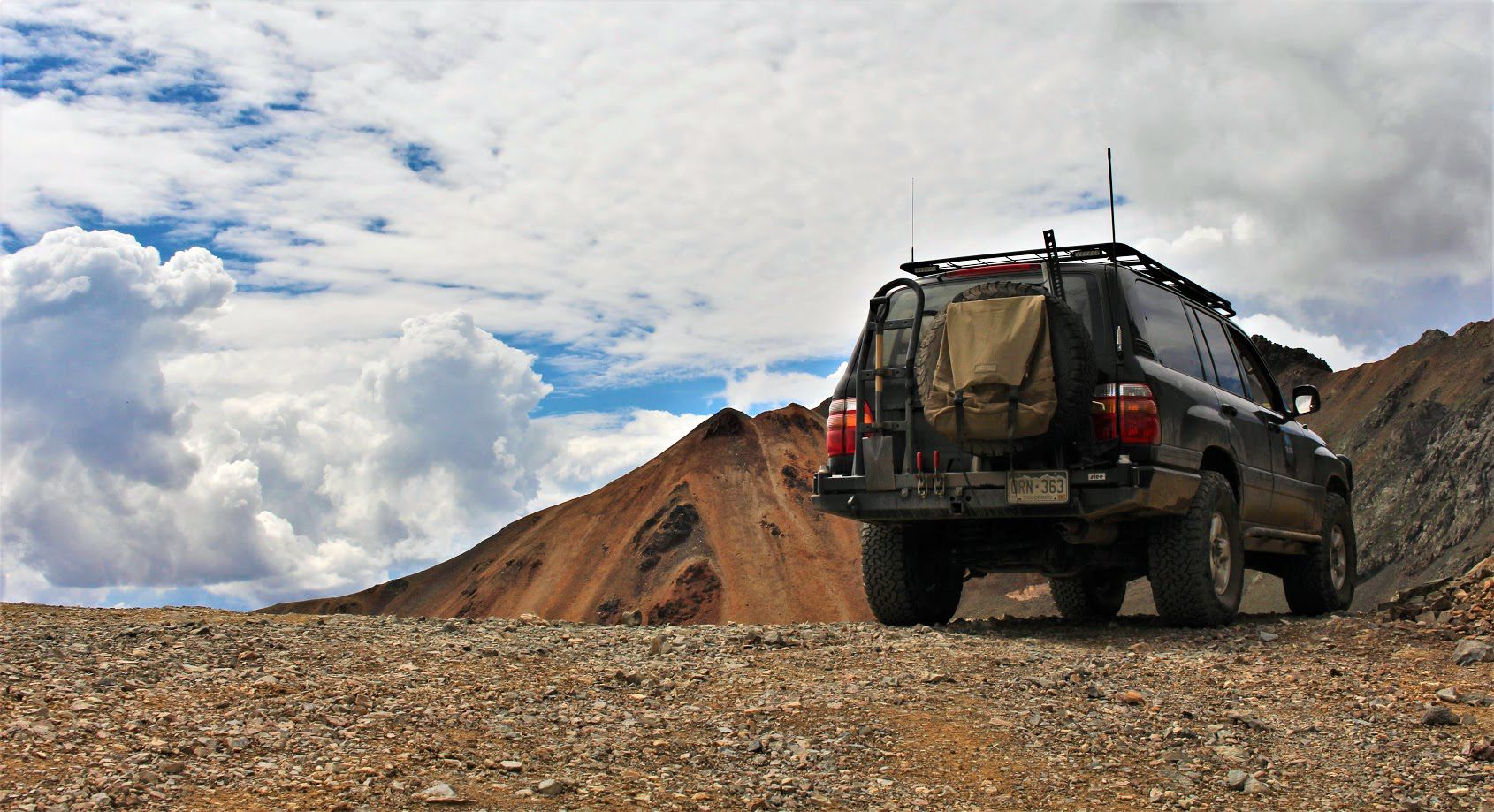

Hey 'Mud I am going to add a half or full sized shovel to my kit. I have been rocking a folding alpine style for years (for snow) and although its got me out of a pinch a few times I am thinking about adding a beefier option. Looking for options on a 100 series obviously. Look for a year round full time solution.
Who's got one... and where did you mount it.... and how did you mount it? If I can't get access to it quickly (under a minute or so) then I don't want to carry it in that way or in that spot.
Also...
1/2 sized or full sized?
Wood, fiberglass, other?
Pointed, flat tip?
D-handle or straight?
I have a rear tire carrier and a roof rack as a starting point but I am open to ideas.
Post up a pic, that'll help... your long drawn out explanation doesn't do your mad shovel mounting skills any justice.

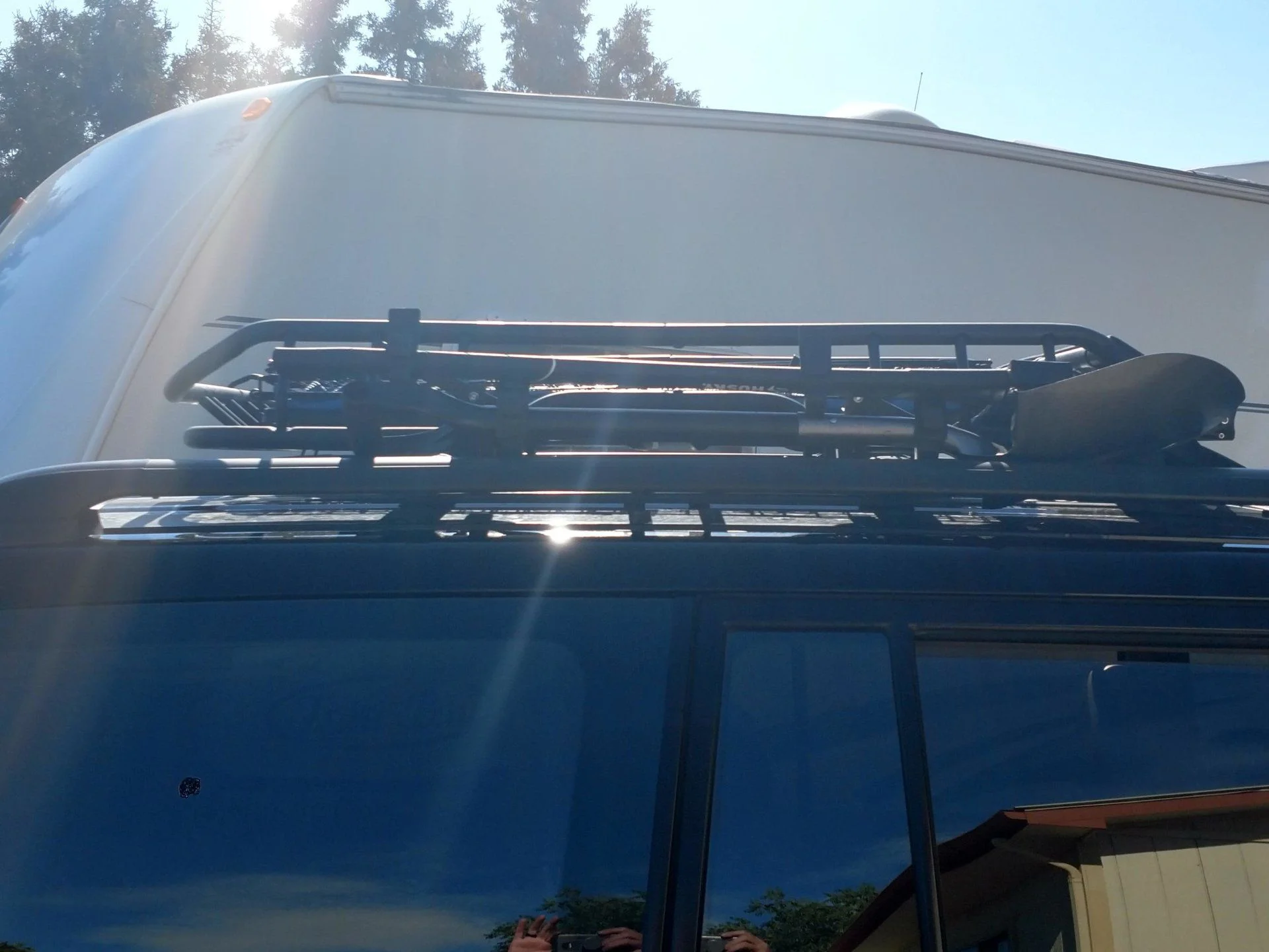

Short shovel home made mount using Quick Fists.
sorry for the crappy pic.
I've always used Quick Fists to mount shovels. They're affordable, easy to access and easy to mount. When it comes to recovery stuff, I try to limit what I put on the roof, as much as possible. If you have a tire carrier already, that's where I'd mount it. You can also mount it to a Hi-Lift if you carry one.

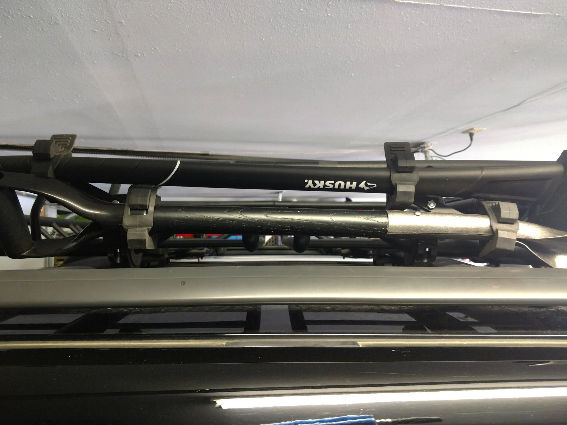

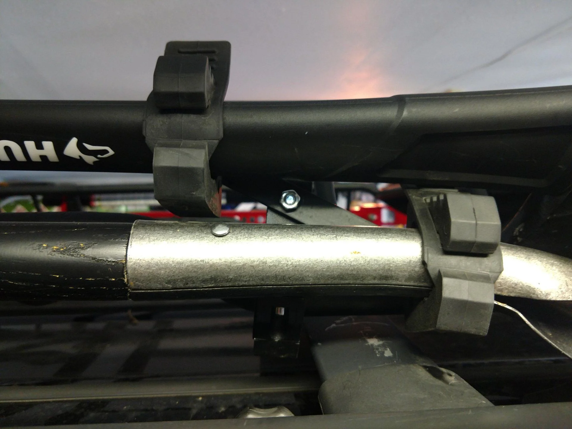

Quick Fists mounted to Gamiviti rack and I use a Kobalt fiberglass shaft D-handle shovel. I have a smaller "camp" shovel mounted to my sand boards via 2 small tension straps.

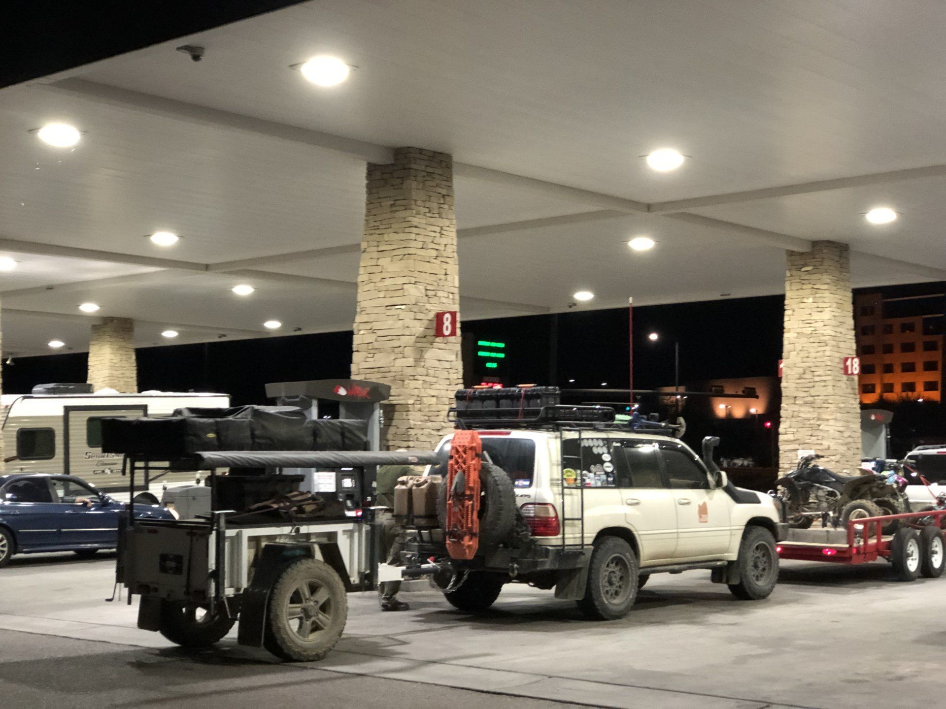

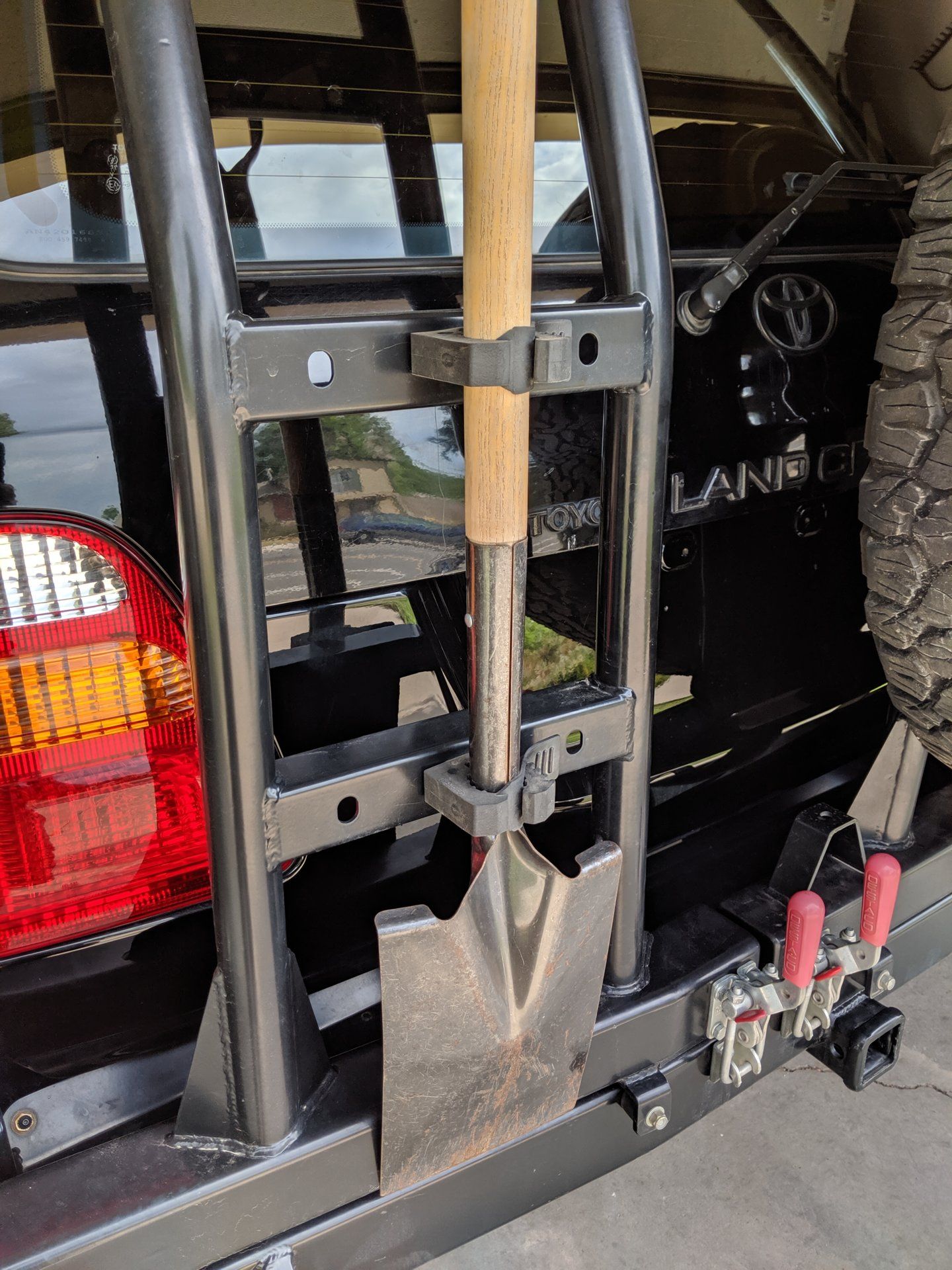

Those are all great questions man and this is a debate I had with myself for far too long. I ultimately ended up with a shorty, flat tipped shovel that I bought from Home Depot for around $20 and mounted on my ladder with quickfists. I know it looks totally HashtagOverland, but its super quick to get too when I need it and it's very sturdily anchored. I know you don't have a ladder, but you could mount it to your tire carrier rather easily, I'd expect.
All of my recovery gear is in the way back anyway, so its no extra steps to walk around to grab it if I find myself in a predicament vs grabbing it off my roof... Plus I can still park in the garage without hitting the garage door.
I've had a few folks ask why I went with a spade shovel instead of a digging shovel. I went the the flat tipped for two reasons:
The first is, I hate digging, its the absolute worst and takes forever. I would rather winch if I have anchor points available or have someone tug me out if I'm with other vehicles. Also, the terrain that we typically travel is extremely rocky and digging is near impossible, so your essentially scooping material away from your wheels/low spots, not digging.
Second, a flat tipped shovel works extremely well to cut into snow banks to widen a trail. The majority of the times I've used my shovel (which is more than I thought it would have been) have been to cut into snow banks to make the trail more passable.
Just my two cents. Post photos of what you end up doing!

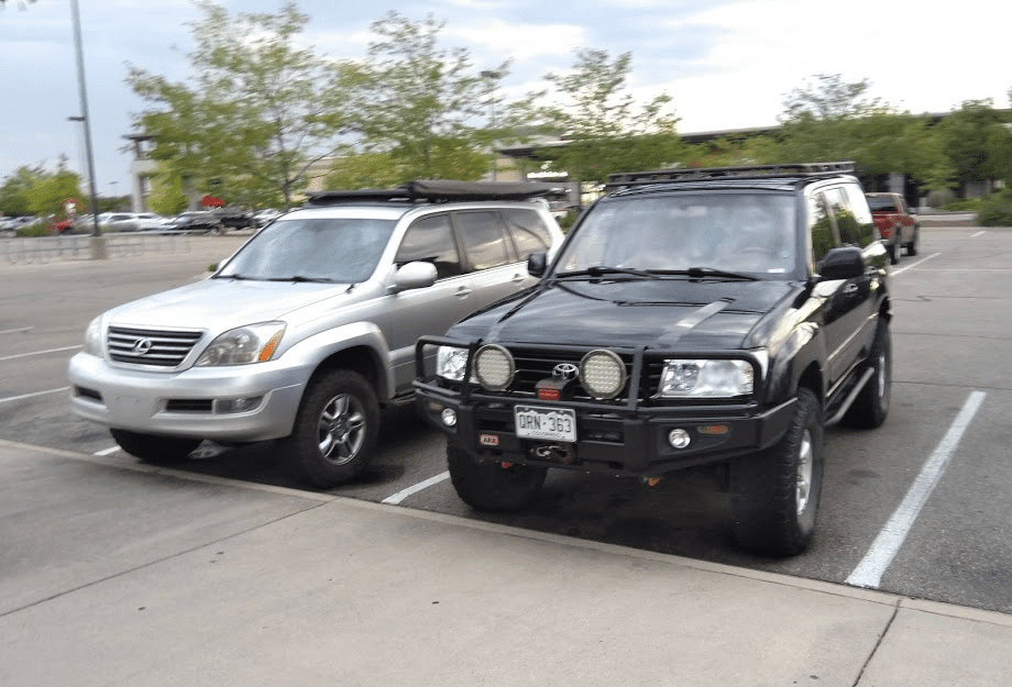

Hah! No way brother! I saw the GX last night and was like, yup! I'm parking next to that guy! Totally did not expect to see photos. What a small world.

When I used the quickfists + dusty environment... the shovel always twisted/slipped a little. Drilling a small hole in the handle and installing a pin on the quickfist could prevent that, I suppose.

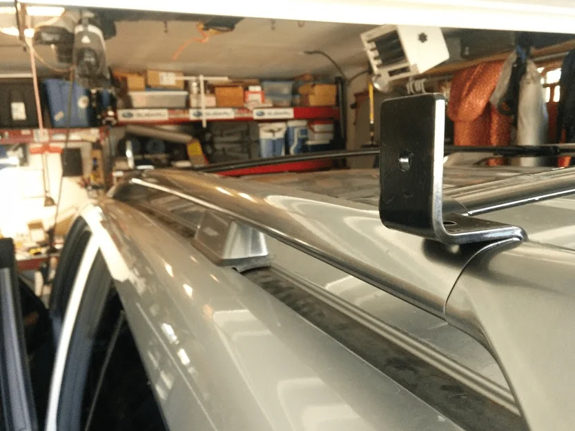

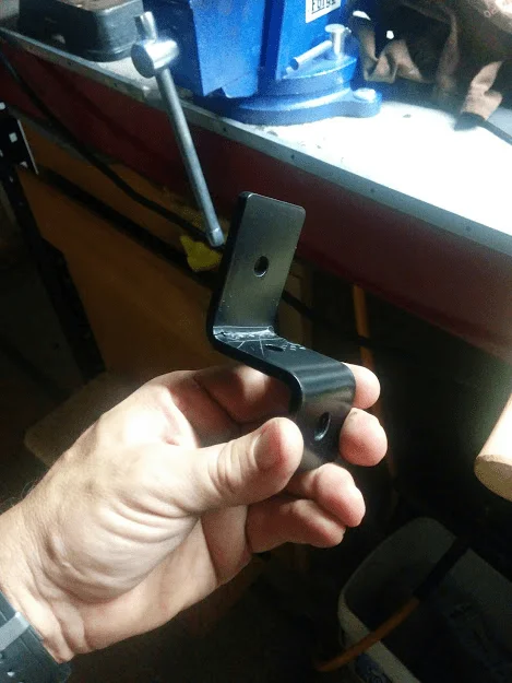

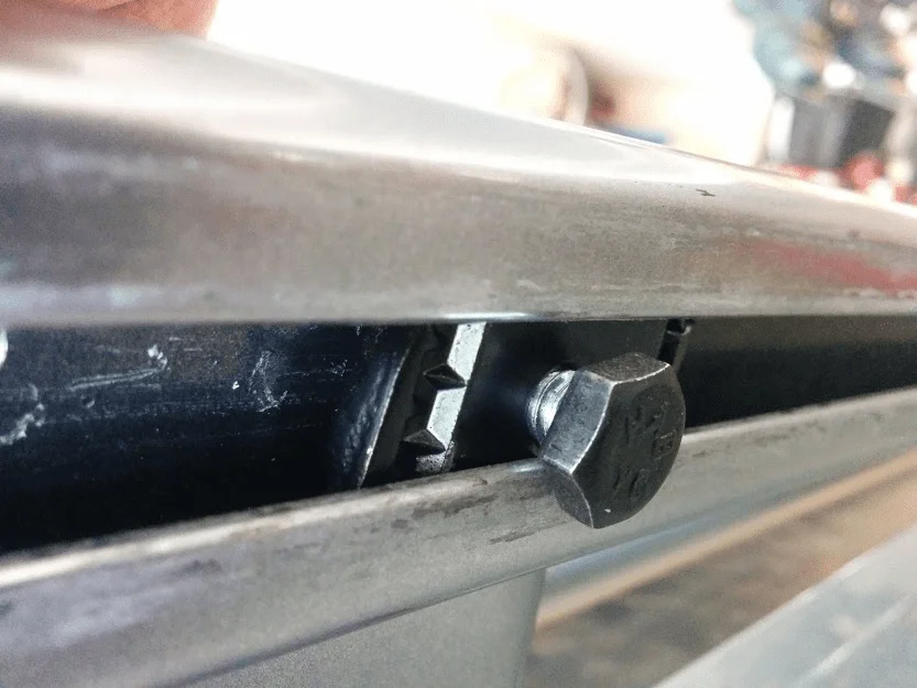

This applies to a LC100, the factory side rails have slots that fit superstrut/unistrut camming nuts (you might need to shave the 3/8 nut a little with a grinder). For my GX, I had to take off the back cover and slide the nut into the slot, but 100's siderail slot is deeper so I think the nut sill just drop the nut in from the side.

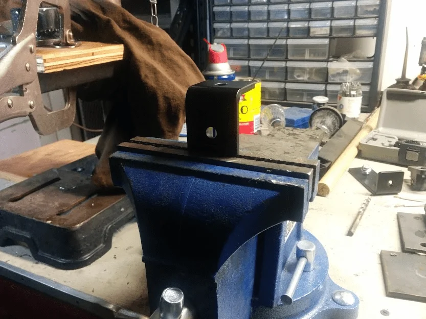

this is how i originally mounted a rhino-Rack awning to my factory side rail I took their bracket and bent another 90deg into it.
something similar would work for a shovel and quickfists.
HD has some 1/4" thick zinc or galvi 'L" braces that could be fine.
