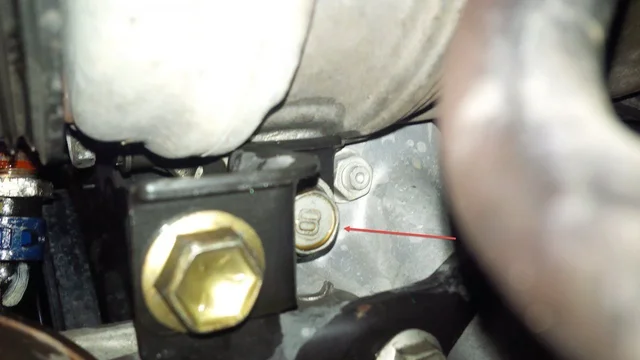

I need to remove this piece.
Is this the right bolt?
As far as the spark plugs? Do they need to be removed when aligning the belt?
Can't tell on the bolt rom the photo. Are you using the fsm? It has drawings of all the parts, bolts, and nuts and steps in order.

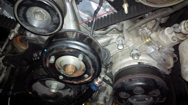

Trying to remove the LH [driver side] pulley to replace the [cam?] seal i moved the pulley to the left out of TDC. I moved it back to position. Did i mess up?
NOTE: the belt is off already.
If it just moved a few degrees then you moved it back you'll be fine.
