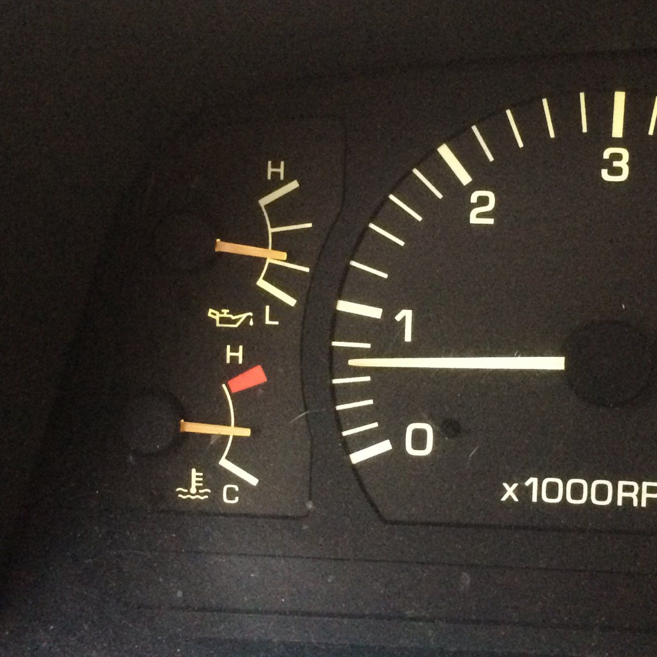

The stat is only a few months old (OEM) so it may be something else that I need to dig into. My temp gauge is not coming up to 09:00 and the heat seems a little cooler than normal.

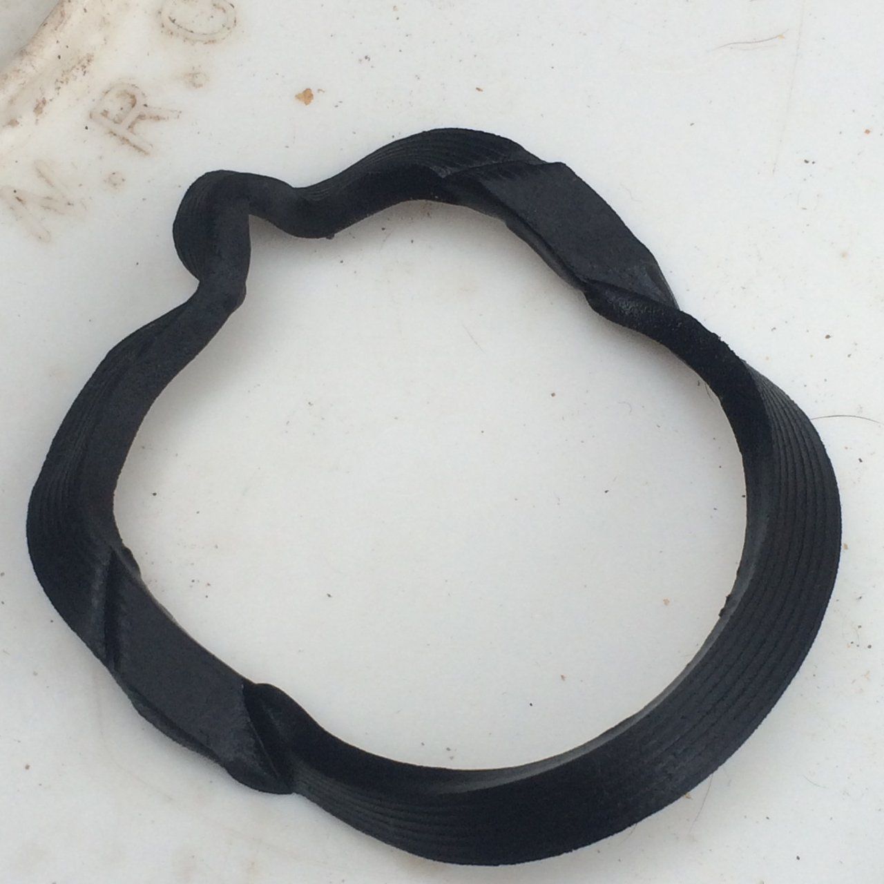

Had everything in properly, gasket looks a bit knackered... Can you order just the gasket?
Yes. They are a few bucks.
Could I pick one of these gaskets up at an auto parts store or would it make sense to order an OEM?
Personally I buy OEM. But if you're on a road trip and can find one at a parts store to get you by then do so. Most toyota dealerships can have them the next morning if you order it first thing.

I can't believe how knackered my o-ring was. I knew there had to be an issue with the temp gauge only rising to a 1/4 and then the heat not being so hot.
