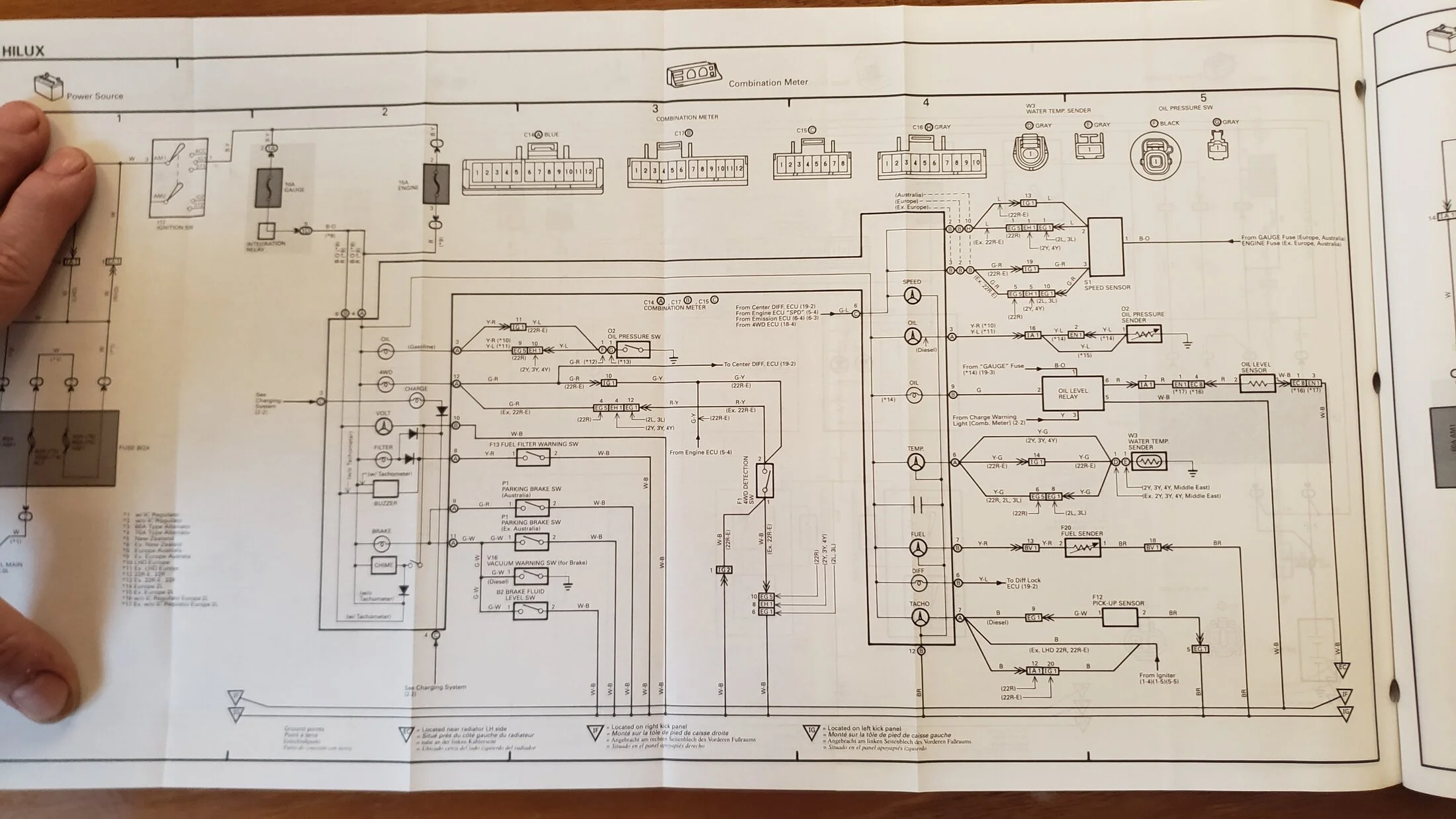

im planning on changing my instrument cluster from the very simple one with only speed, fuel and engine temp to one with oil pressure, voltage and RPMs,
i think i got everyting sorted out apart from rpms so far
for the oil pressure i need to change my oil pressure switch for oil pressure sensor but i still need to verify to thread on this, so if anyone could help me i will be really gratefull

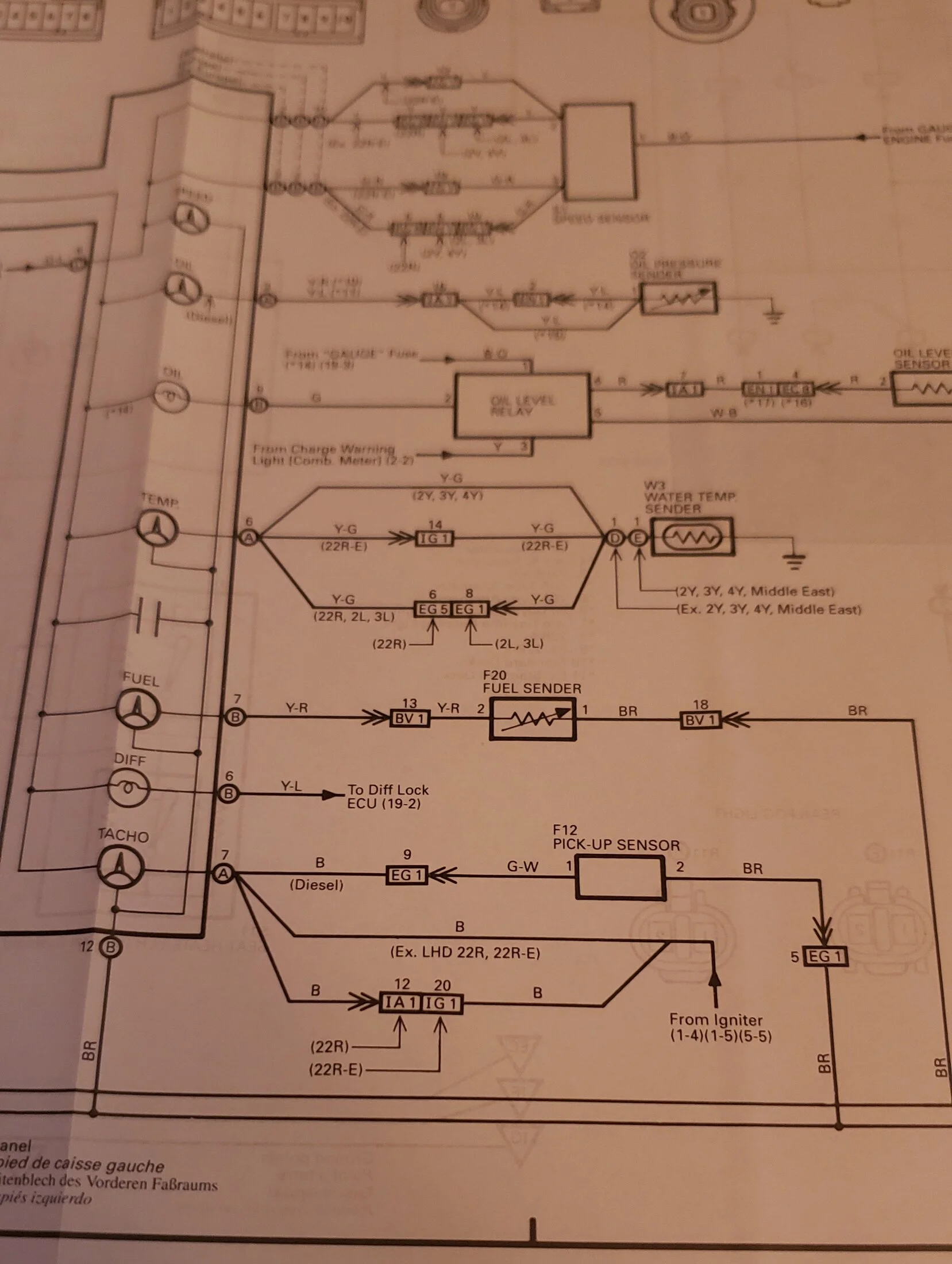

next thing is the rpm, first i need to verify whether my pump has threded hole for the sensor because from what i read already there were some pumps without it and the wiring, from the sender there goes 2 wires and my question is if the polarity matters so i wont fry the rpm gauge in the instrument cluster
thanks in advance for all your answers,
it appears that the pickup sensor is just a magnetic pickup.
might double check it for diode when in hand
