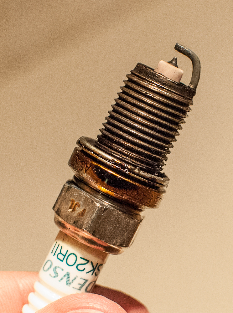

- The base of the plug had some build up on it, almost like stuff was blowing through the threads and being deposited on the base. I've never seen this before. I'll post a picture of it shortly.

Here's a photo of the #7 sparkplug and its deposits.
You should check ALL the plugs. Yes, it's going to be a bit of a PITA, but it will help you eliminate plugs as an issue and/or possible resolve the issue.
Yes, all the plugs will be replaced eventually. But since it's just the one cylinder that's been causing problems and I've had little time I haven't done the rest yet.
