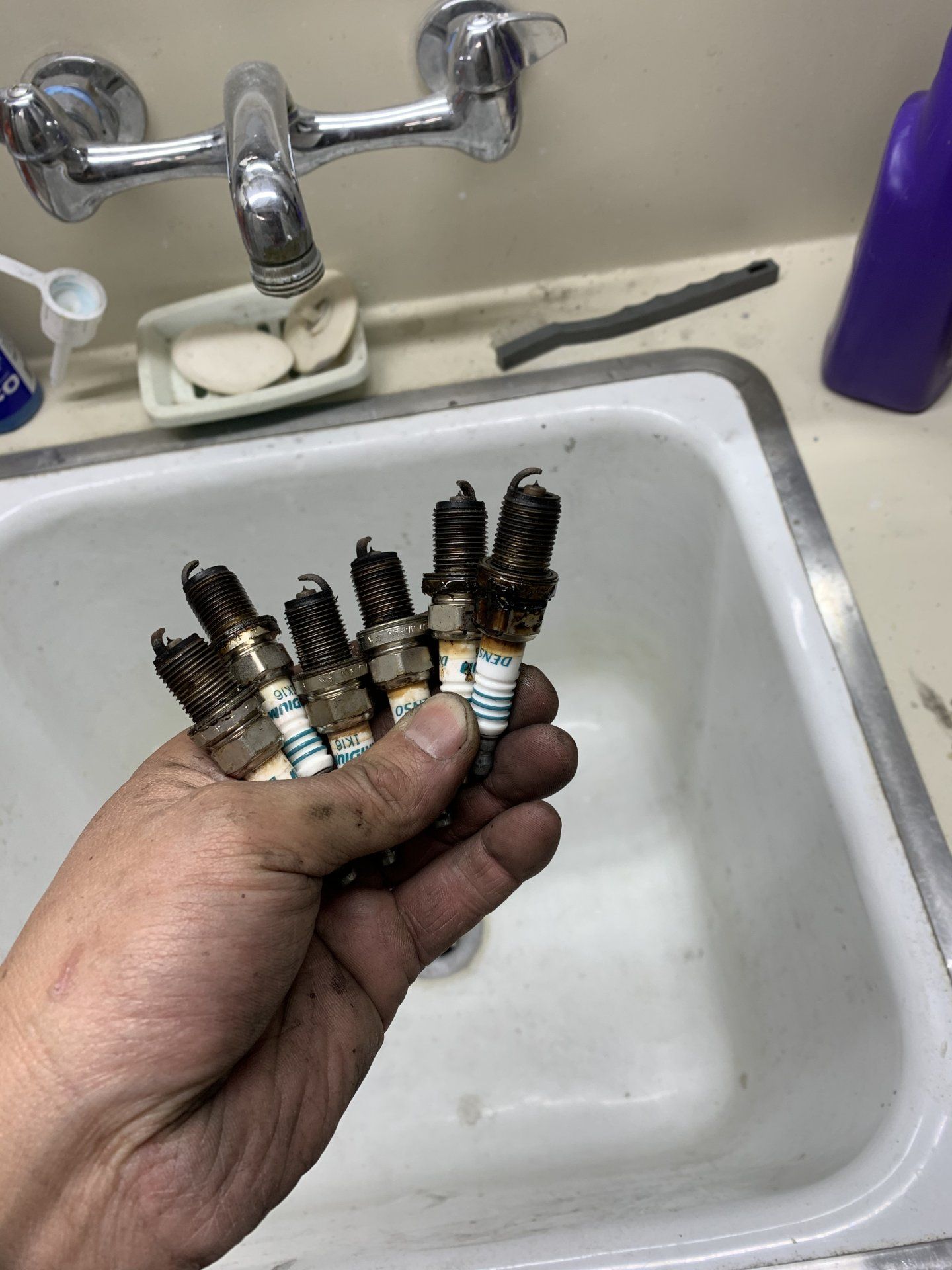

Interesting regarding the oil. I did notice some of the plugs were oily, luckily I took a pic. Looks like one was really oily but the others look reasonable. So clean out the spark plug boot with electrical cleaner and maybe wipe the plug galley to remove as much oil as possible. I definitely didn’t see any really wet oil, so I don’t think there’s a valve cover leak, at least not too bad. Any suggestions on how to clean?
Oil in the tubes indicates leaking tube seals which are fit onto the valve cover. There should never be oil in the tubes.

#6 tube seal is shot if your plugs are in order in that pic.
So valve cover, spark plug tube seals, throttle body gasket, and PCV valve grommet are in your near future. May as well do the PCV valve and both valve cover hoses at the same time.
