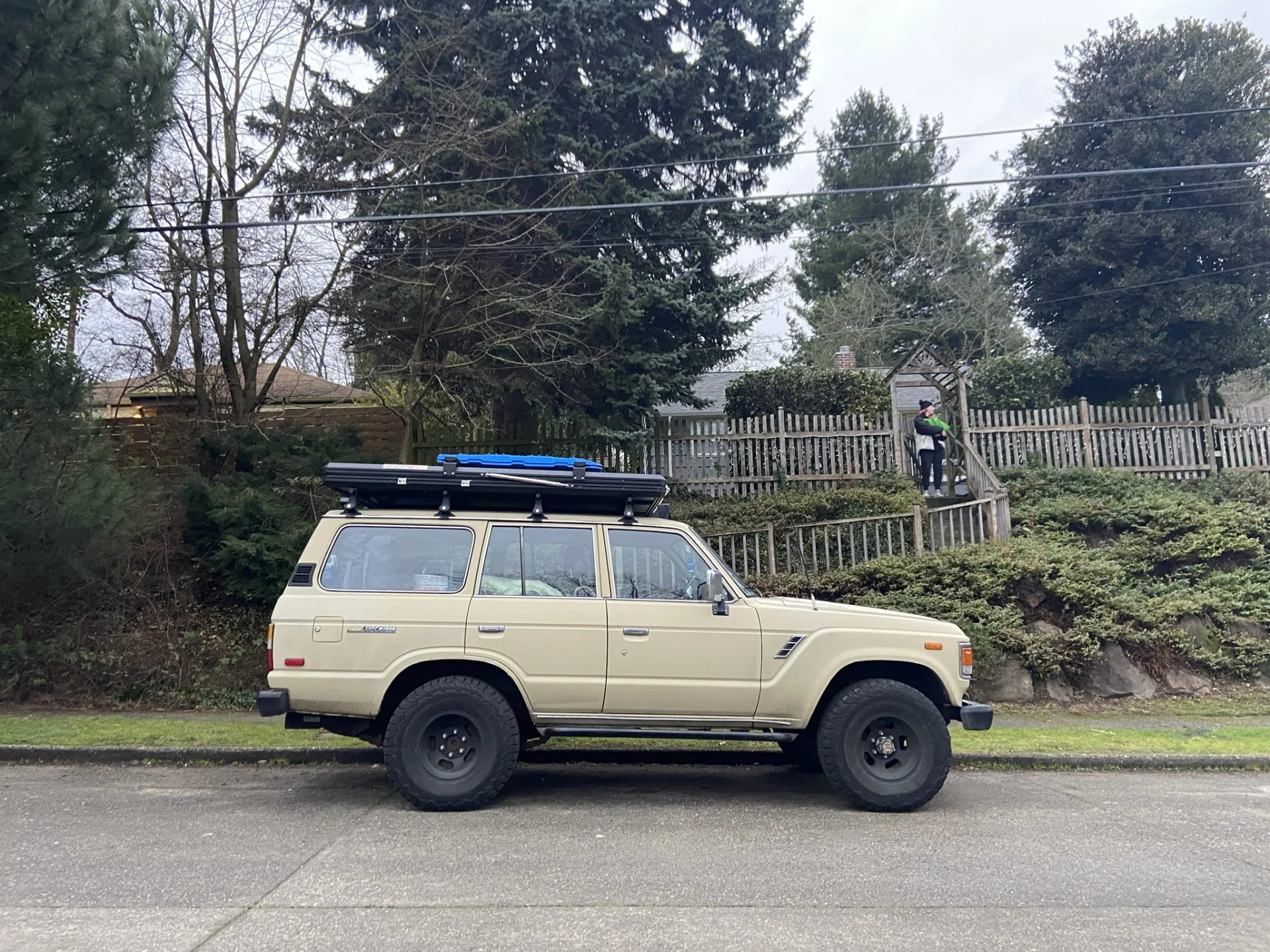

But to answer your question I use an ARB full length roof rack like in my profile picture.

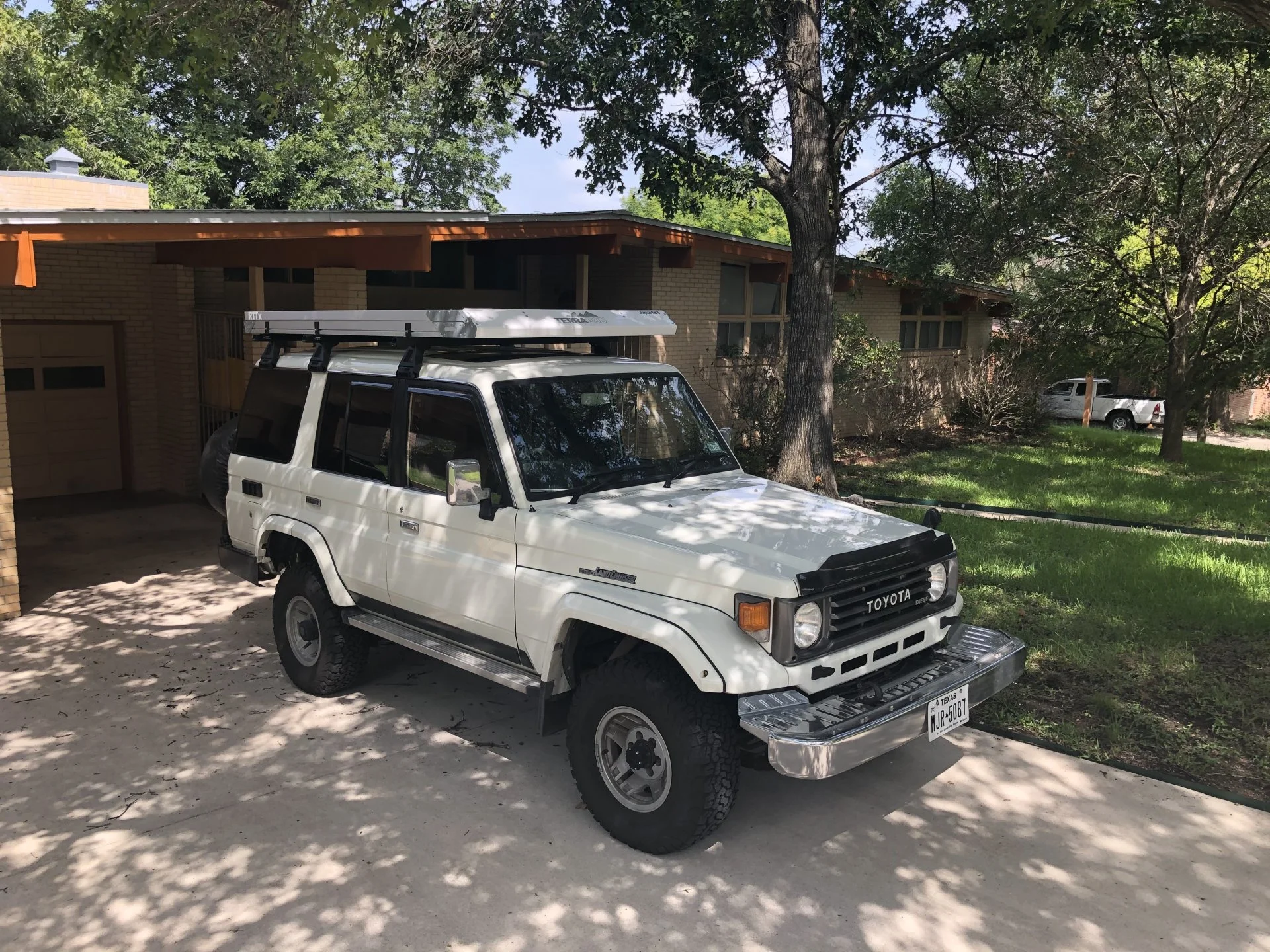

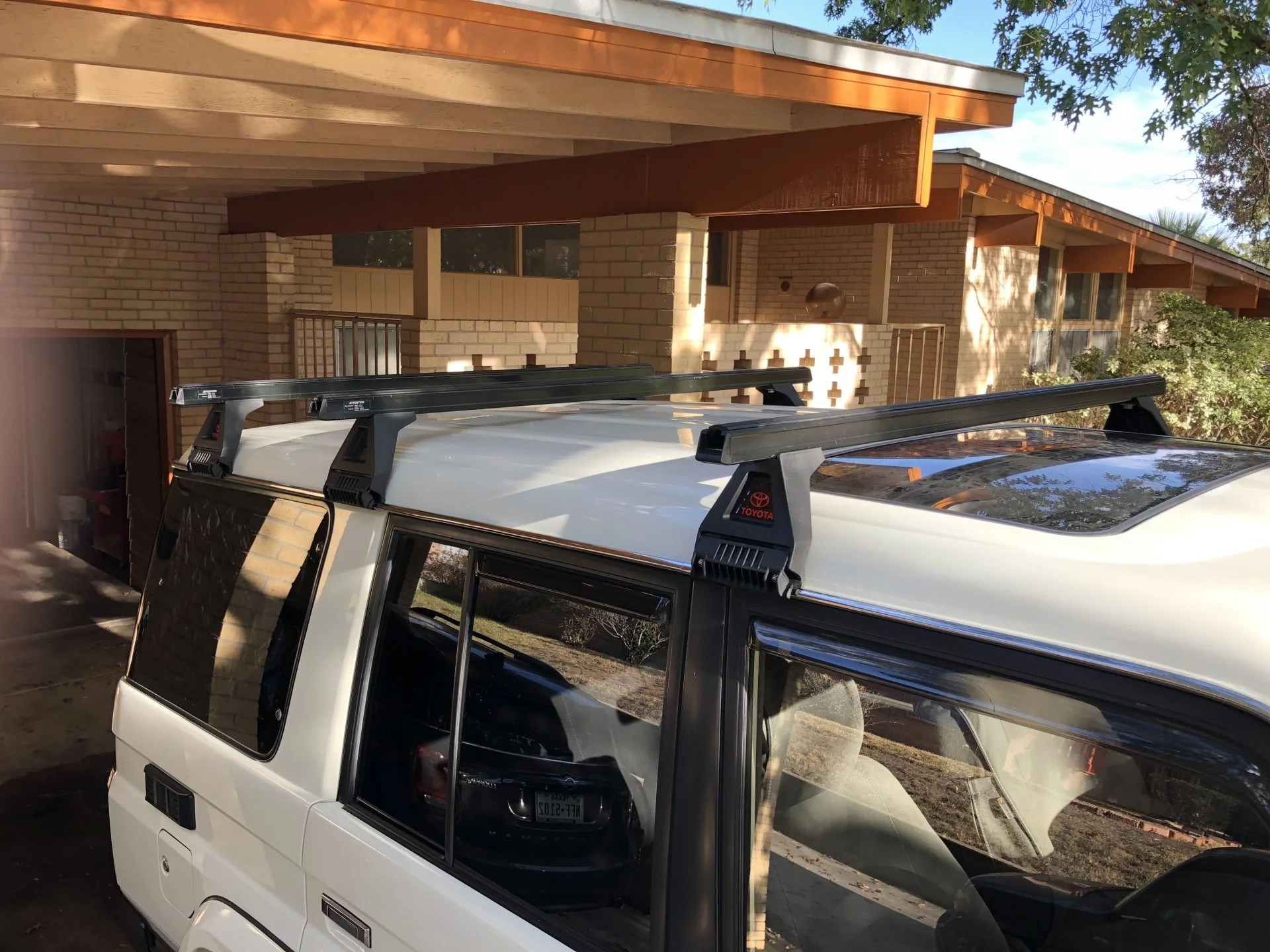

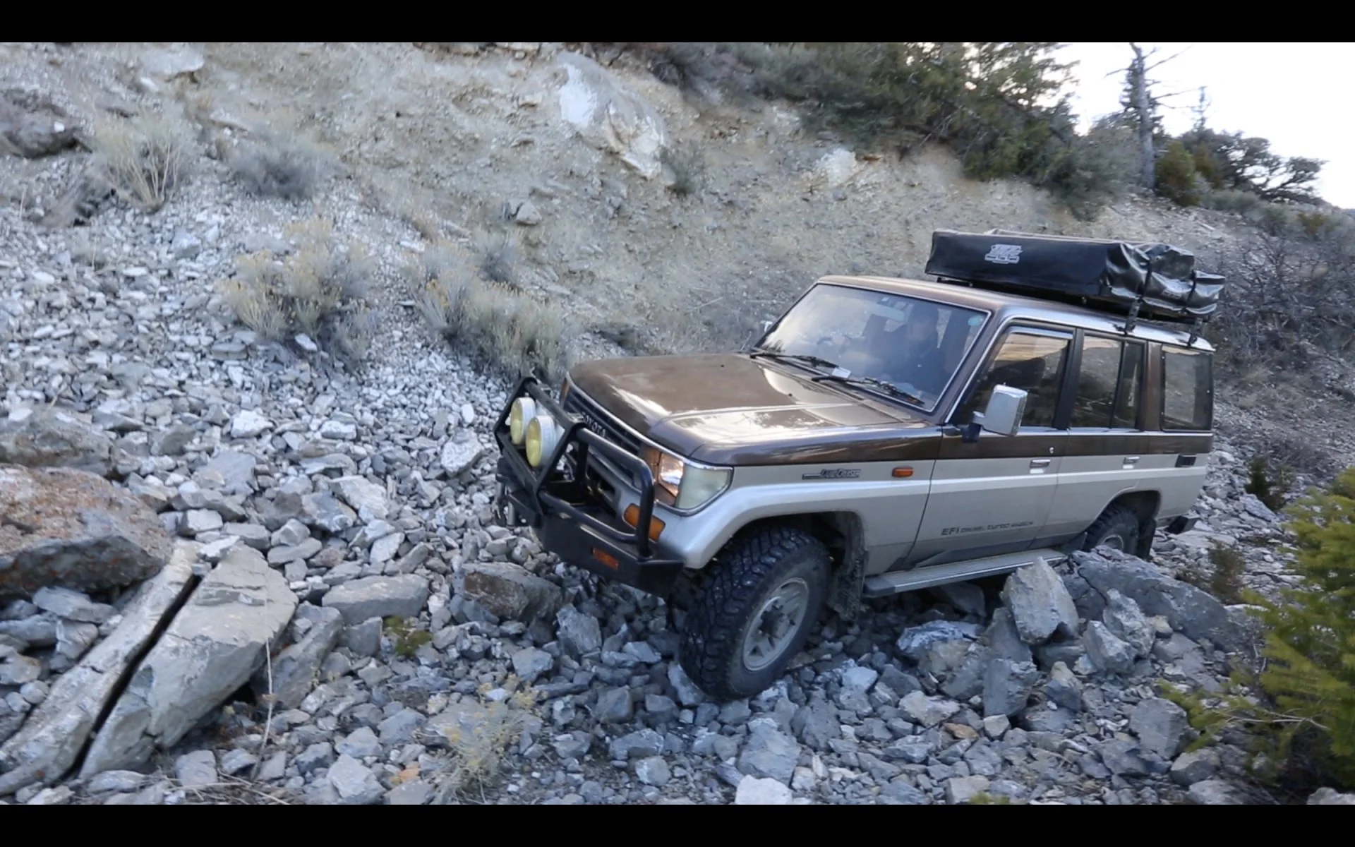

The Rhino rack heavy duty RL150 bars and gutter mounts work nicely on the 70 series so I am sure it would be the same on the 60 series. No damage to gutters at all as there is rubber padding.
(To be honest, I agree with some of the comments about RTT now that I own one...they are a PITA to store, remove/install, and eat your MPG....so I have since removed mine)

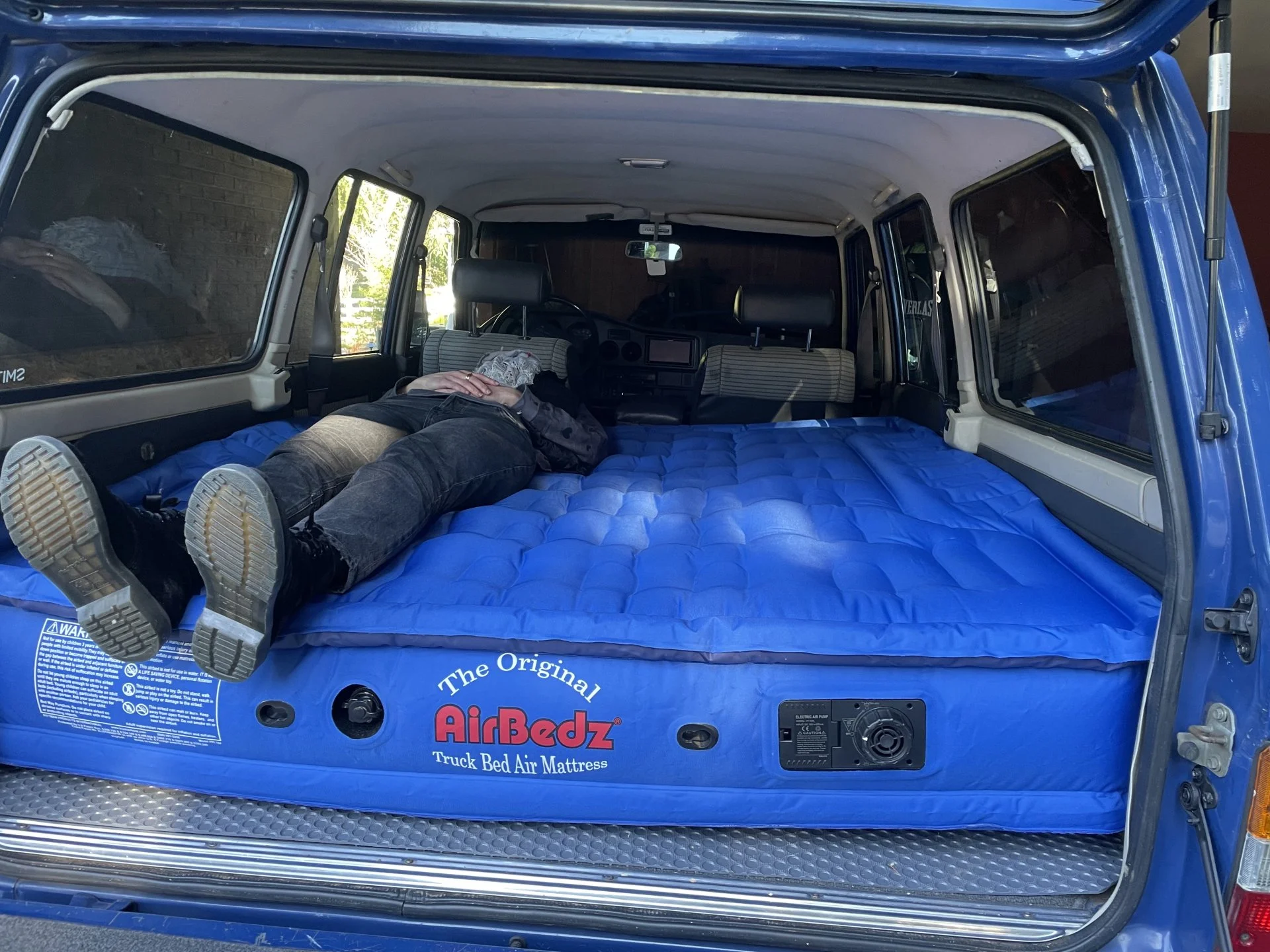

Ive thought extensively about this but i think the height a platform takes away would cause me to feel veryyyyy claustrophobic. Im leaing heavily towards just an air matty in the cargo area and its going to be this 1. Until i find the camper trailer i want. (which ive narrowed down to a Hybrid) personally id rather have a large bed (imma large guy) Than the added storage space of a platform...for now.

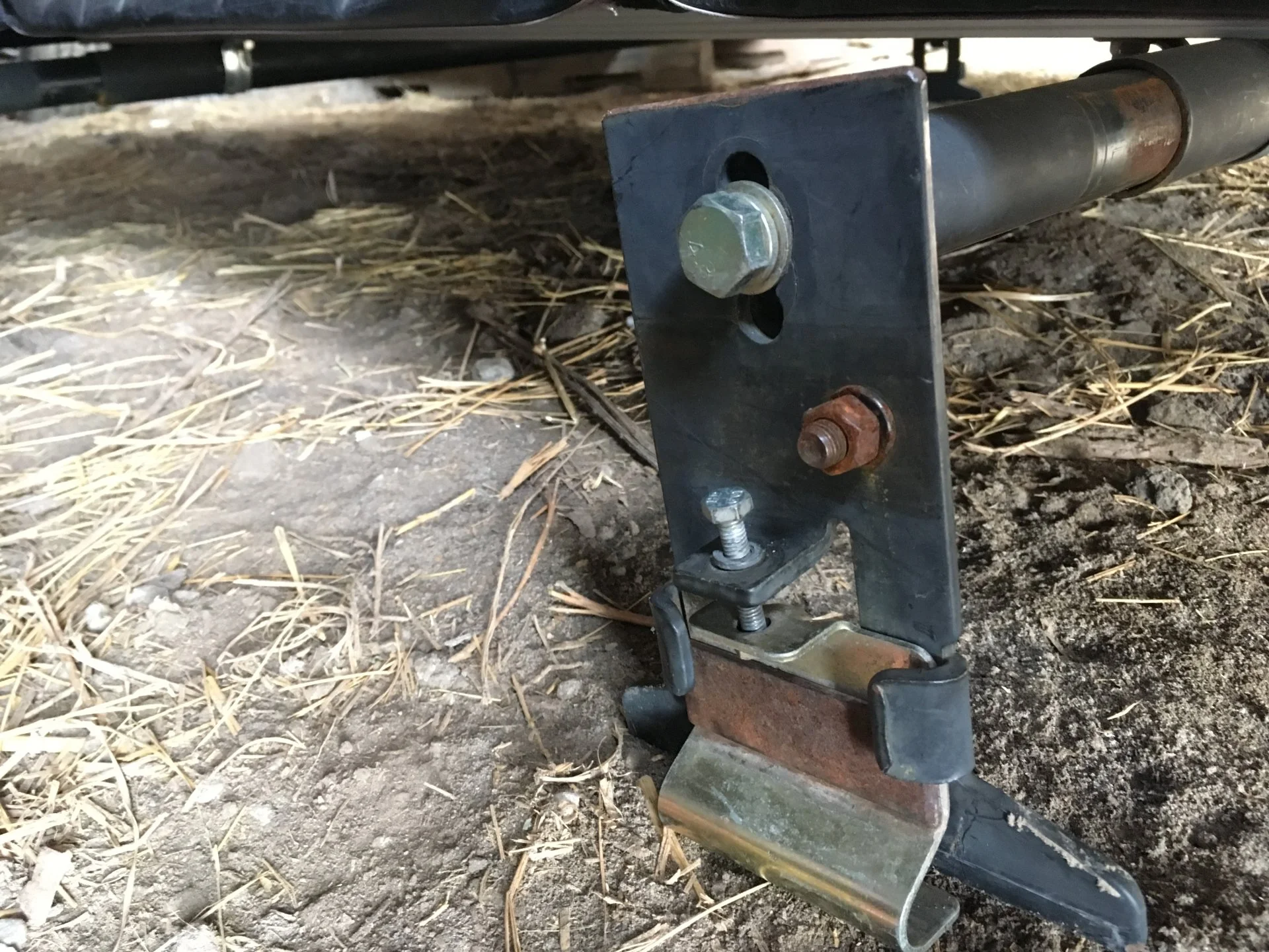

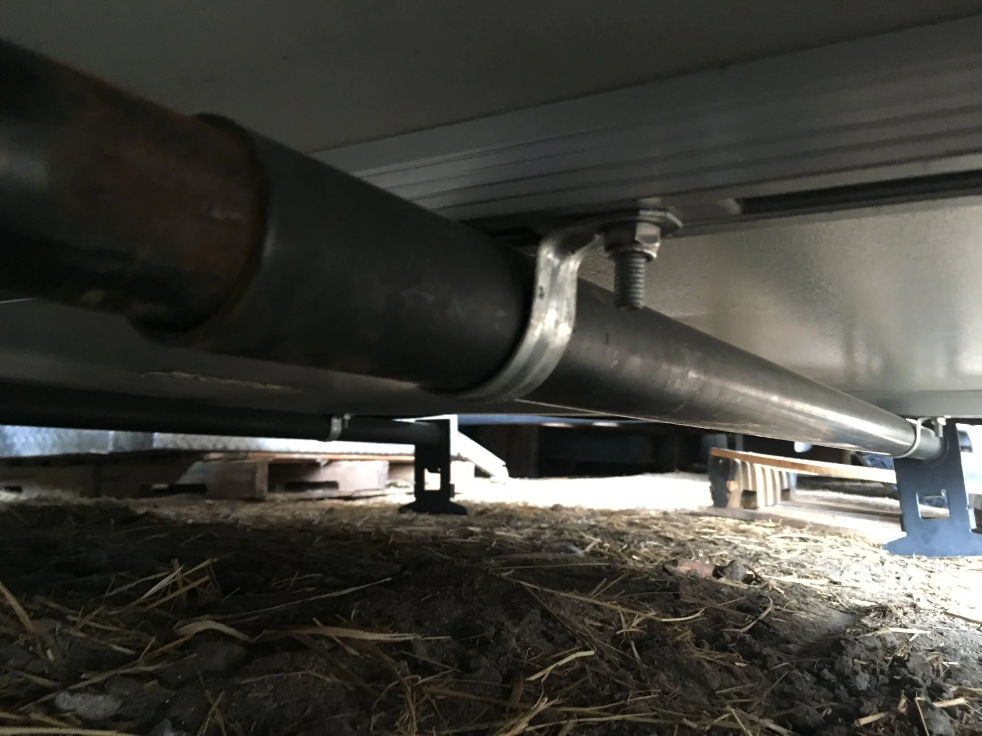

I bought a set of cheap ladder racks for commercial vans to mount my RTT. They cost about $65 for the pair a few years ago and required a few simple modifications to work with the tent, but overall for the price they’ve been great. The claimed load rating is 600lbs for two bars, and I can confirm they’re very stout. I used them on my Mercedes 280GE and FJ62, HDJ81 and LJ78 LandCruisers. A simple set of pipe straps from a hardware store made a very secure way of bolting the tent to the bars.
