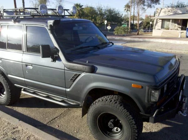

I just ran mine down the passenger side B pillar kinda ugly but it works
if you look close at the first mount you can see the wires .... there in plastic and just slid in to the door and down to the plastic molding

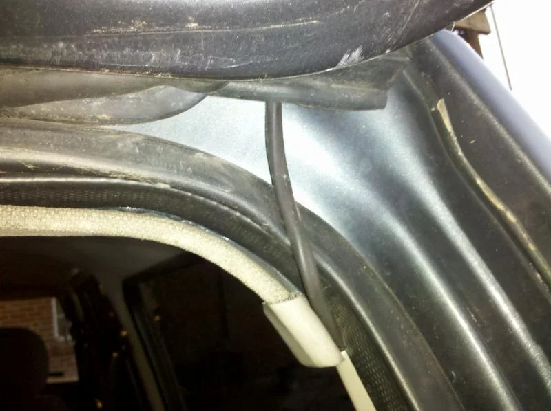

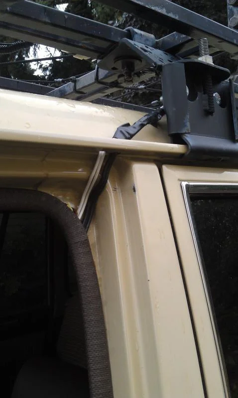

What I did was
I ran the wires thru the tubeing & then down the rear gutter mount,
dwn the rain gutter with a lil silicon glue to keep it dwn & in thru the back hatch.
All wires that are exposed are wraped in shrink tube.
You can only see a small bit of wire as it goes over rain gutt & into the Rig.
Hope this helps you out:cheers:
