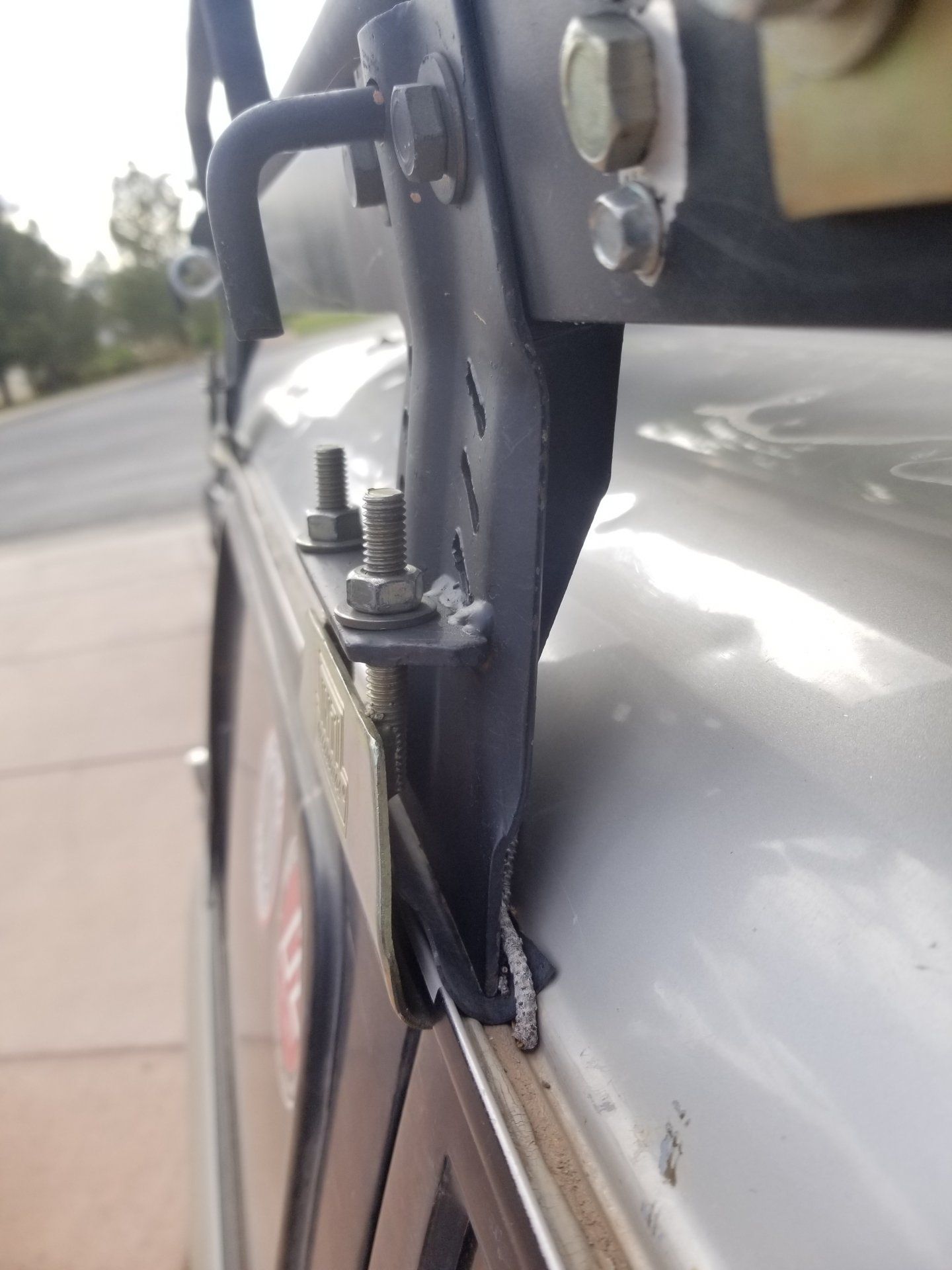

Hello everyone,
I got some smittybuilt gutter mounts which i put on my con-ferr rack. However they seem to keep sliding and i have to pound them back into place. Anyone else has/has issues or has/had a solution for it? I’m considering pinning them from underside of the bracket into the gutter but I would prefer not to do that.

I don’t think that would work because then the bracket wouldn’t be parallel with the roof rack

I’ve got 8 gutter months and i use the s*** out of my roof rack. It’s just that the bottom surface of the gutter is angled up compared to ground, so the bracket has a tendency to walk up.
Maybe i can bend the gutter down ?
I don’t think that would work because then the bracket wouldn’t be parallel with the roof rack View attachment 2646565
That's a much clearer picture of the mounts, thank you!
If you're loading the rack heavily, it pushes down in the center and kicks out the outside of your bracket.
I would give a guess that you are actually overloading your rack based on the number of brackets you have on the truck. Just because you can get it up there doesn't mean it's not too much.
What I was thinking was this was a full length rail type rack that sits in the drip rail.
The bracket pivots on the inside leg of the bracket (next to the roof line) and when you load the rack, it pulls the top toward center of the truck, which will kick out the "foot" of your bracket, causing what you are seeing on the bottom.

I think it would make a lot more sense to try and bend the mount instead of the gutter.
I have put some pretty serious weight on my oldschool INTI rack and it has never budged. This rack is supposed to be a pretty legitimate rack for heavy loads and it only used 6 mounts.
The mounts for my INTI rack are quite similar in design to yours but they seem to have a different profile under the gutter and they utilize 2 bolts instead of 1.

The biggest difference between yours and his is that your has the rack further out toward the drip rail so there is much less overhung load. Your load is nearly straight down, where his is inset 2"+ from the drip rail.
