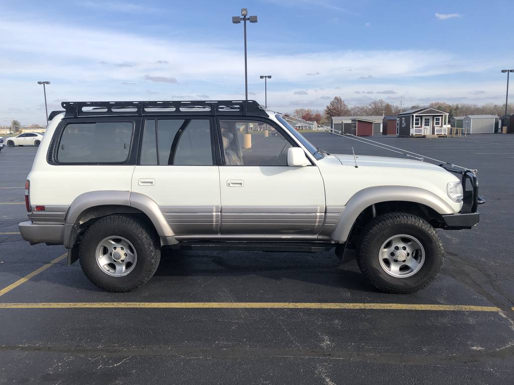

I really like the Bowfin Cruisers rack on my LX. It's similar to the Prinsu and many accessories fit or can be adapted. The feet are good and sturdy. They are a bit hard to source, though. When available, they're posted on the webpage on Wednesdays from what I've heard. Then they go fast and what you usually see is Out of Stock. I got mine by buying the truck under it, as it was owned by the sister of the Bowfin Cruisers owner.
One thing I didn't like about the BC, the Prinsu, and similar designs is how there is virtually no inside lip above the crossbars. I drilled a series of holes one inch below the slots that the crossbars usually mount in. This will require that the roof skids originally installed on the roof underneath the port installed Toyota rack be removed, if present. Here's a view:
While the rack mfgs like to sell all kinds of special tiedowns to secure loads to the crossbars and strapping things down will secure them, I prefer to start with having a substantial lip to keep stuff from sliding off. The roughly 1/4" you typically find just doesn't satisfy me. This is particularly the case with rack loads subjected to being tossed back and forth on the trail.
Although the lower roof line of the newer racks is nice, especially if you have clearance issues to getting into your garage, I tend to like the old school looking racks with actual side rails. Like @greentruck said, the benefit of being able to know the load is secured outweighs my desire to have the new hottness.

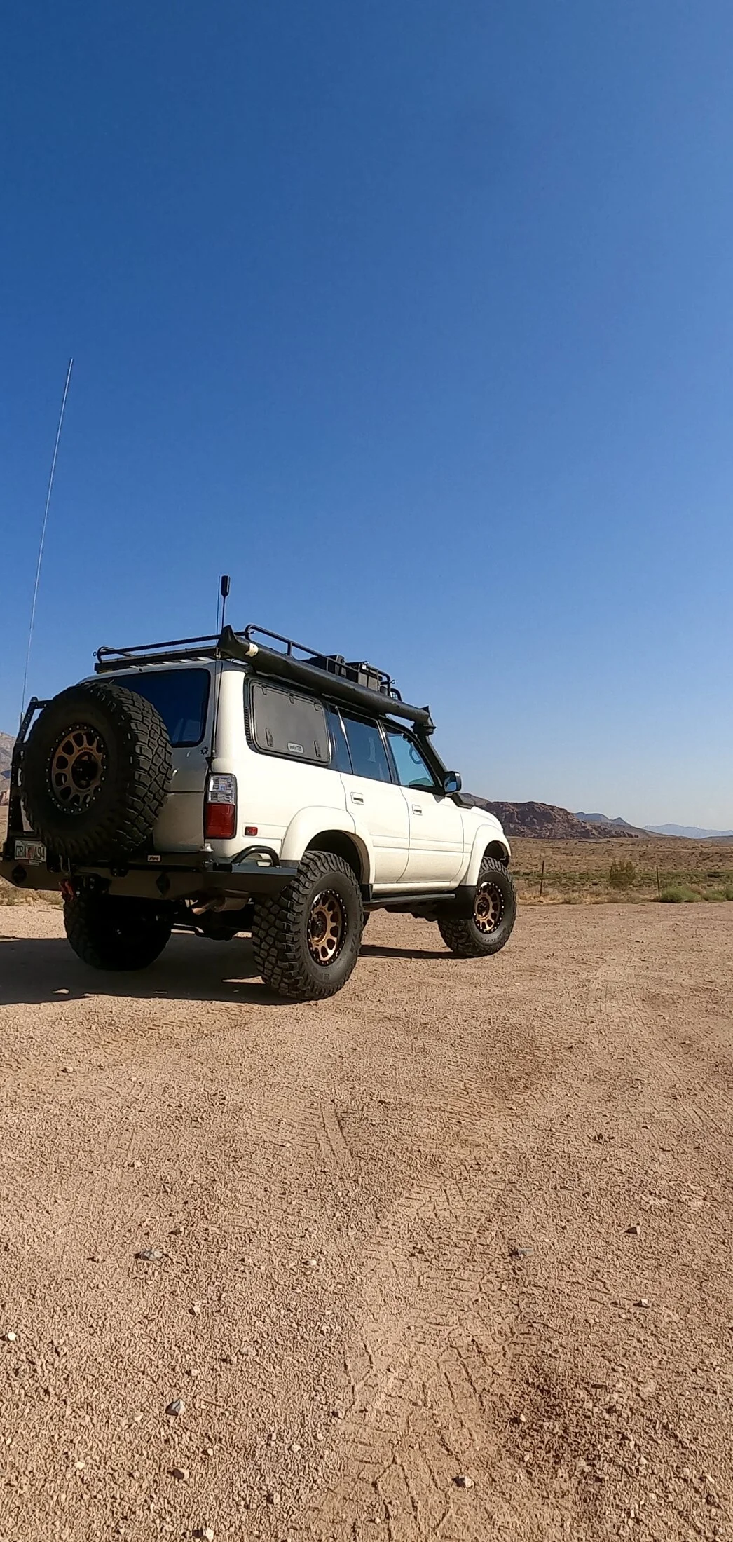

Just returned from a trip to High Rock Bay in the UP. I didn't weigh it, but I'm sure I had around 300 to 400 lbs up there. I was concerned about effects on handling. While I'm sure that emergency handling would be significantly impacted, normal operation saw virtually no effects. Just gotta remember that stuff is up there, which is helped by a small card I slip in above the instrument cluster with a note reminding me I need at least 8' of clearance. With an unloaded rack, I have about 1/2" clearance to get in the garage. With it loaded...:bigtears:...well, don't try this at home. Started using the rack for shorter trips into the boonies because, while I love my M101 CDN, it still a trailer that needs drug around.

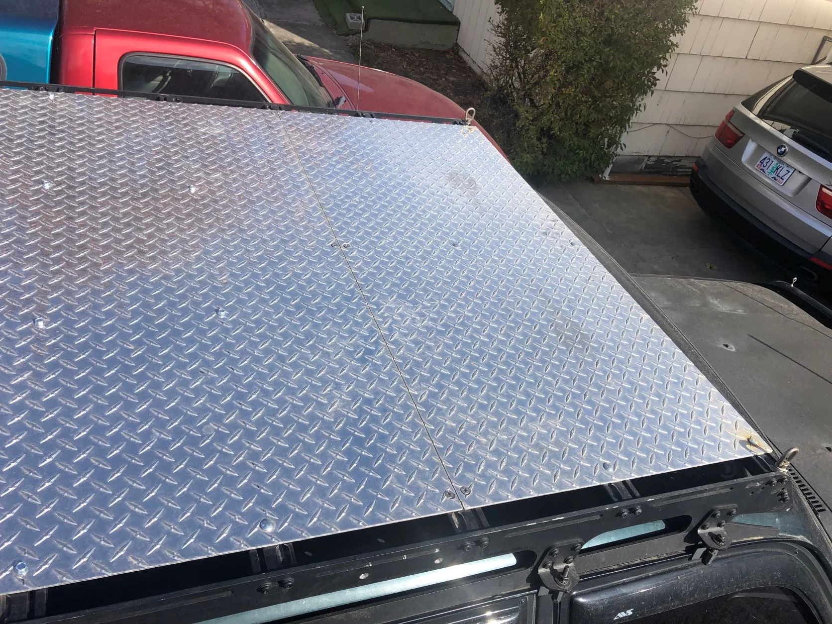

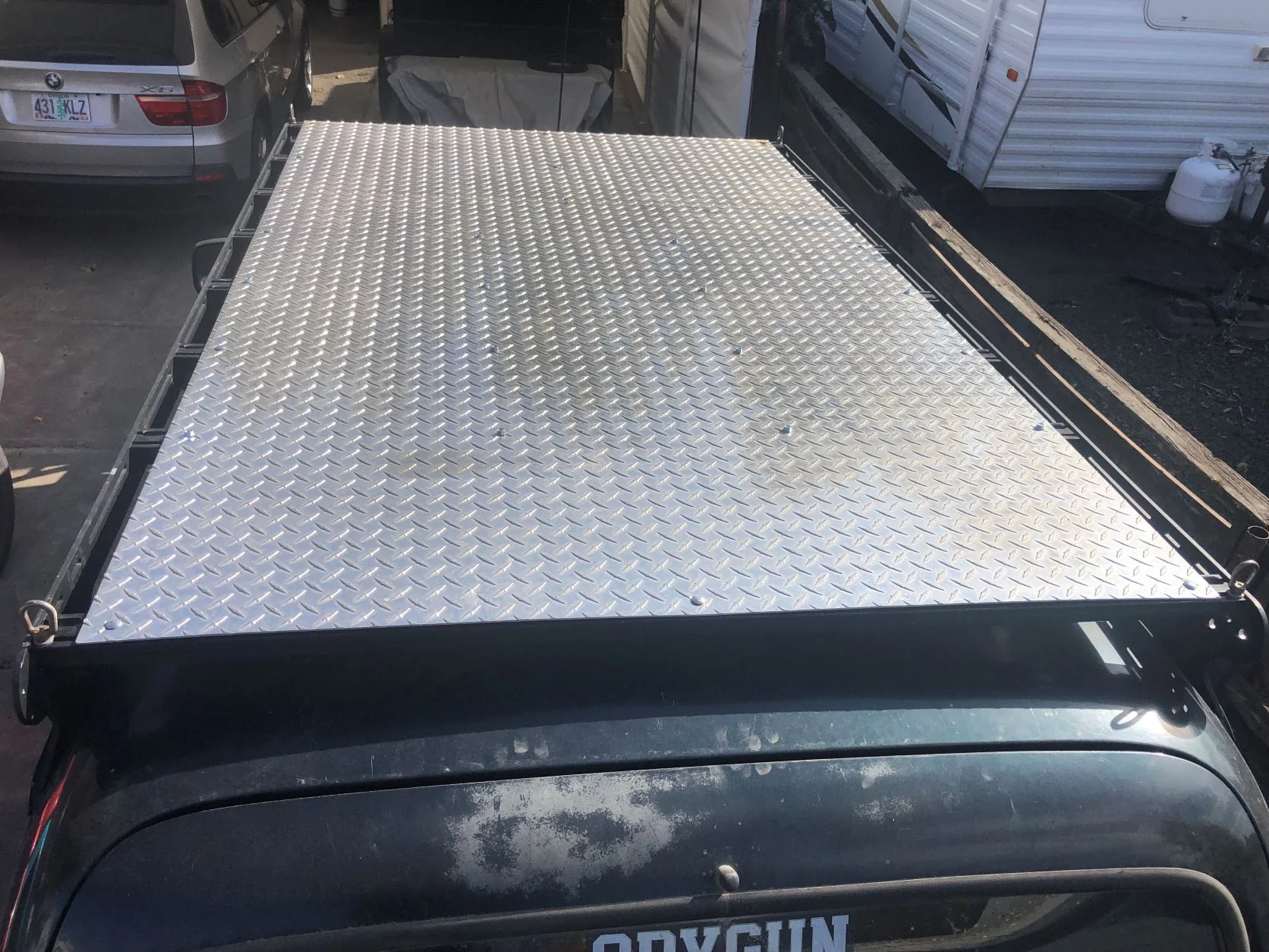

You reminded me by saying about the width of your Bowfin and carrying a sheet of plywood, what I did with my Prinsu (being they're almost identical in looks and size, except mounting methods). One of the benefits that my hardshell RTT provided was moisture and sun protection for my roof and sun roof. So after I sold my RTT I was concerned about the exposure to the weather of my aging sun roof seal. I got a 4 x 8 sheet of diamond plate aluminum and fitted it to my rack. I only had to trim the length for it to fit. I also made a joint so I can remove it above the sun roof temporarily, if desired. The protection benefits of the RTT returned, plus I can stand or even sleep on it (under the stars) if I dare. Or even store gear, like the rack was designed...lol. Here's a couple of pics for clarity:
Nice work there. Some folks use their racks for viewing or videoing platforms and this is a great solution for that, also.
A potential improvements would be to slot that sheet in places so that a strap hook could be used in the middle of that sheet. These probably wouldn't be primary tiedowns, because the AL might bend, but would help tidy up some of the strapping if needed.
