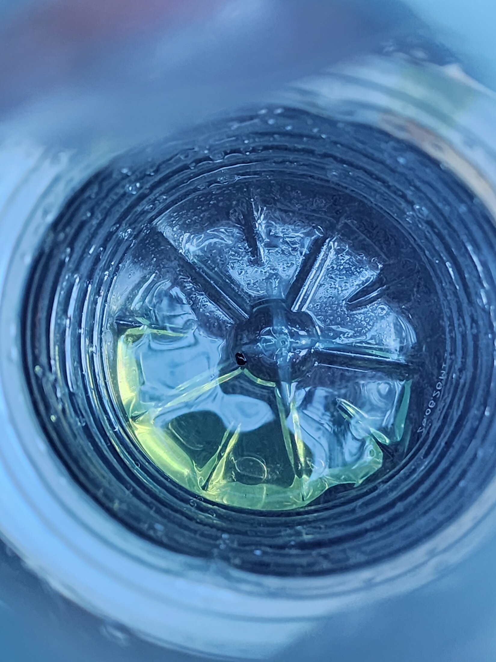

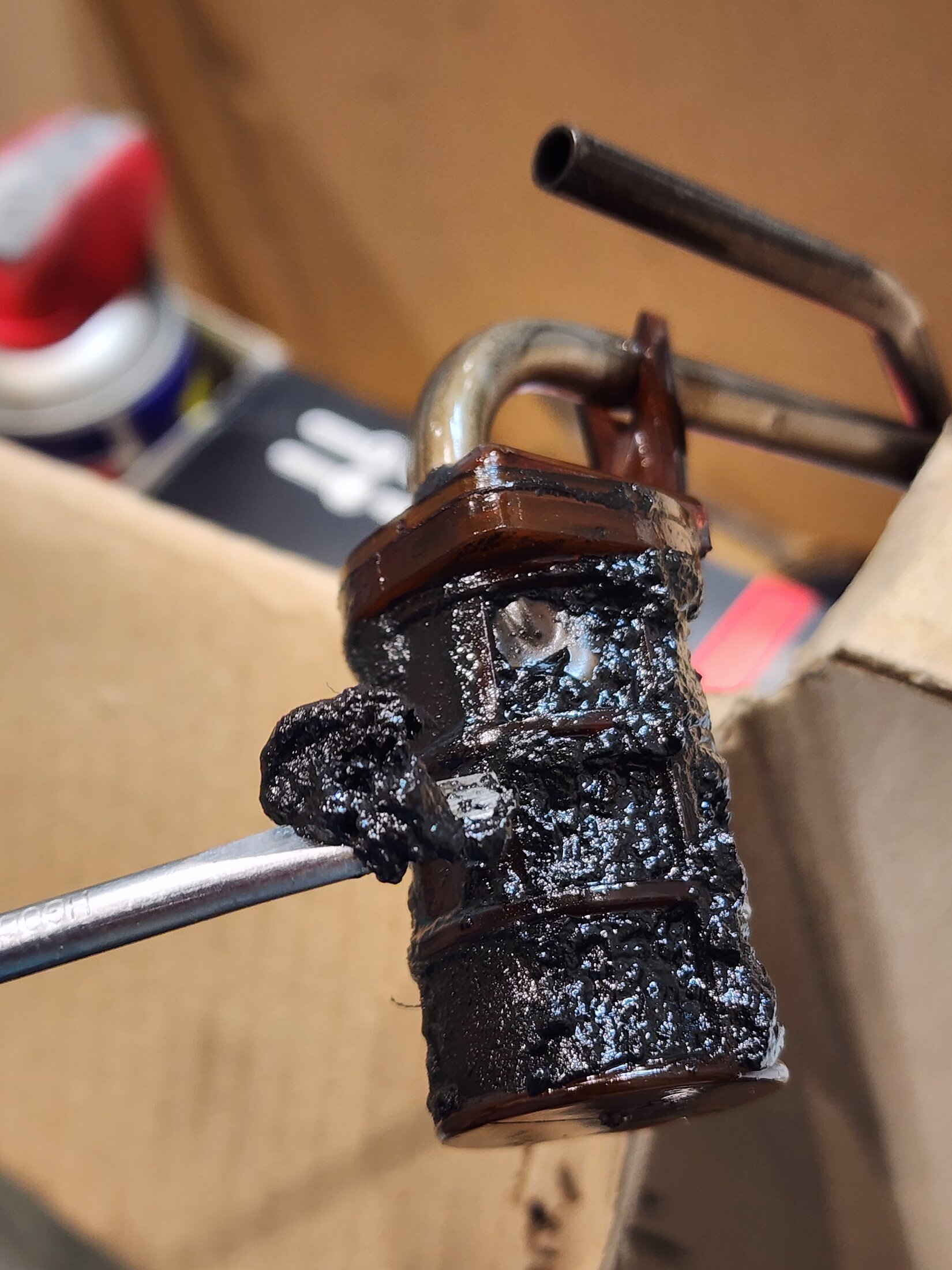

Whilst working on the engine I noticed some dirt pass though the clear fuel line, this lead me to flushing the lines and cleaning the fuel tank where I found the root cause!
I'm not quite sure where this gunk came from, it could be something to do with the glue that was used around the injector but would that get into the fuel system and fed back to the tank in the return idk
View attachment 3896178View attachment 3896183
That looks like diesel pest to me. Basically microorganisms that grow in diesel tanks that have been sitting for a longer time. Root cause is biofuel that's added to most modern diesel brands in Europe.
It's an infection, so it will grow back over time, if not treated. I recommend to swap the filter (likely you did that anyways already).
There are diesel additives available to sanitize the fuel system.
Cheers Ralf
Cheers Ralf
Thanks Ralf, I think you're right, I've had a look into this a bit further:
  • What it is: Commonly called diesel bug, diesel pest, or fuel fungus, it’s not a single organism but a mix of bacteria, yeasts, and fungi that grow at the interface between diesel fuel and water in tanks.
  • Root cause: Modern diesel in Europe (EN590 standard) contains up to 7% biodiesel (FAME). Biodiesel absorbs more water than pure fossil diesel, creating a better environment for microbes.
  • Symptoms: Slimy sludge, filter clogging, reduced engine performance, and sometimes a sour or rotten smell.
I need to use biocides to kill existing microbes and fuel stabilisers help prevent growth..
I did change the filter but wondering if it'll be all around the fuel pump. Its running fine now but the main filter was quite quite manky. The additives might help clean it.
There are only two approaches to cure this, depending how severe it is..
A) Taje apart the entire fuel system and clean & disinfect or replace each line & item in touch with diesel.
B) Clean out tank, flush lines change filters and, if it runs reasonably well then: Proceed as needed.
I guess, you are on B.
Make sure you flush the system: You not only need to kill the fungus, but also remove the slush from the system. Tank flush is a must.
In use, make sure you have a good turnaround of diesel, so no new stuff grows. Use the disinfectant additive on regular bases.
Expect the filters to clogg up again soon, as remaining fungus material will be flushed from the lines (regardless how well you flush the system). Special issue is the filter at the tank suction pipe, as this can't be changed easily (Thus tank flush is important). Also check on the little screen that may be in the IP feed line.
(And: Be careful. Flushing tank and lines with diesel is hazardous! Use PPE and don't blow up yourself).
Good Luck
Ralf

Yes, I've completed B and running for 3-4k km now, cycling through fresh fuel. It's generally all good, but I have notice a very very subtle power different on some days, but could be something unrelated or nothing at all. I thought an additive would be worth a go.

I would recommend doing a proper job of cleaning out the fuel system. I had bad diesel bug in my BJ60 - I removed the tank and cleaned it with an alkaline degreaser (something like over cleaner or dishwasher tablets might do the job). I flushed the metal fuel lines with the same, and replaced all rubber fuel hoses (which were due for replacement anyway). There was also staining inside the injection pump and fuel filter bracket. Just cleaning the strainer in the tank and flushing with fuel is not going to get rid of it.
