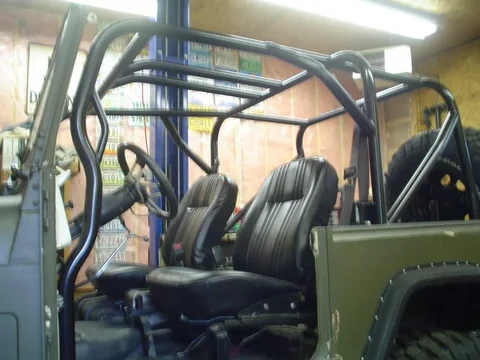

And look @ that clean garage floor. I'm jealous.
Thanks for the pic Tom. I was about to snap a pic of my dogs cage just so we would have a cage pic on here.
I have seen Clints in person, it's lookin great
Go with a bench if you actually want someone to ride back there.
I need comfort for my kids....anybody have a bench seat to sell?
is that a car lift I see????
Smartest tool my money can buy, really very affordable considering what it allows you to do and the time savings. Just need a 12 ft ceiling.
The only problem with clean is that it takes time. A good clear coat on the concrete pays for itself real quick.
If I'm not mistaken the rear set from a Chrysler minivan would fit in between the rear wheel wells. You just have to fab up a mount for it.
Recovered in black vinyl that might work:hhmm:....not recovered could possibly equal total :hillbilly:.
Phil, Do you know someone who has done this? That seat has to be a dime a doz at a junk yard.
Talk to Rod, the guy who I am doing the 43 cage for now. He said something about putting a bench in his 43. I think he said econoline van....thats way better than a caravan seat. I would try to find a low back bench, so it doesnt look so funny.

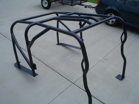

Three coats of powder coat later.......
It's hard to tell from the pics.
Do you have a sufficient straight bar from front to rear at the top?
If not, we'll be winching you off of trees when you get them jammed between the bars.

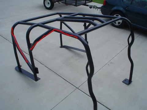

I figured the 2 angled tubes on each side will push the trees off. I marked in red what I visualize the path of the trees to be. With that, if I am still being winched off trees, I won't be very many times because I would be adding tubes.
