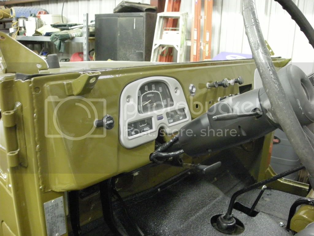

pics, of my front dash :
Very nice cruiser, I like the look with no dash pad. :idea: and I know we are talking about an FJ40. ;)
My old cage had straight A pillars, the problem with it was that you couldn't turn the window cranks with the door closed. Just something to keep in mind when you design yours.
Also consider a spreader bar across the front at dash height, it makes the cage a lot stronger.

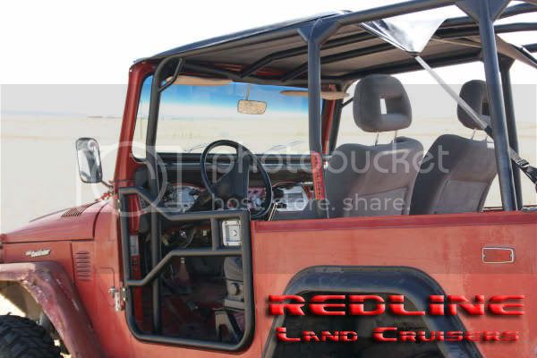

Our (Redline Land Cruisers) Cages do not have the Radical bend around the dash. your window cranks still work, it will still clear the Hard Doors and should look good without the dash Pad, you will have the option of putting the dash spreader a little lower than the following photos show

Our Cages Uses DOM in the Main "B" Pillar, and HREW for the rest of the design, Where Metal Tech uses DOM in their "A" Pillar, and HREW for the Rest. They also use 2" Tube, Vs. Our 1.75".. This allows us to get away from the large bend on the A Pillars, and have a Straighter, (and we believe stronger) design.
one other difference is 6 Cage Tie points in the Redline Cage, vs. the Large Mounting Plates and 4 Tie's of the MT Cages.
