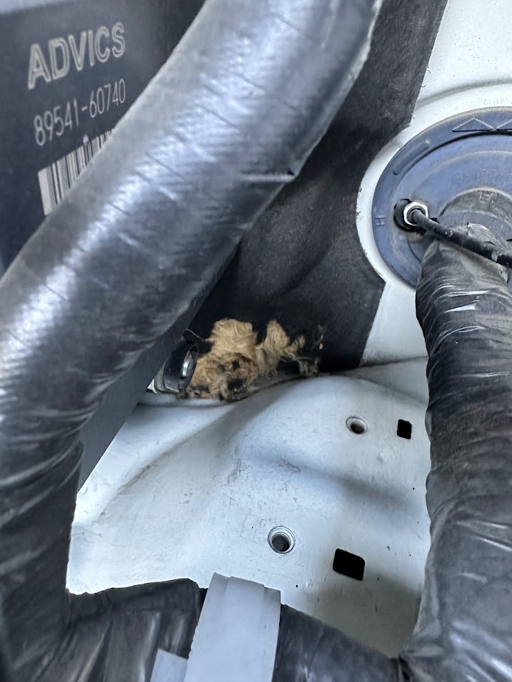

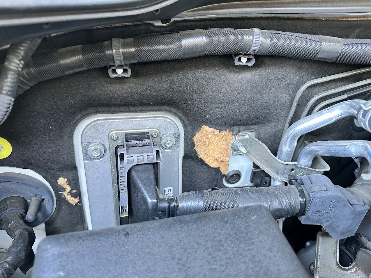

Hello All, recently discovered rodent attack under the hood. So far, they managed to damage the engine cover (just the foam) and firewall insulator. I can probably get the new engine cover.. but wonder what to do with the firewall insulator? Is there patching available to help firewall insulator so it does not deteriorate further?
I have taken the following actions to fight off Rodents... sprayed engine hood cover/engine cover and firewall insulator with peppermint oil based solution, and placed two bags of Grandpa Gus's rodent repellent, is there anything else i can do to prevent this from happening in the future? Your inputs be greatly appreciated. Thank you.

Thank you. I will look into all that as well. Really looking for inputs on how to repair/patch the firewall insulator as well.
I really don’t think the firewall insulation is a problem. It is likely more for sound damping than for thermal, and such a small portion of it being incomplete will be negligible in the big picture.
I’d consider removing the loose stuff, using a marker or something to make the remaining hole less noticeable then drive on, personally.
