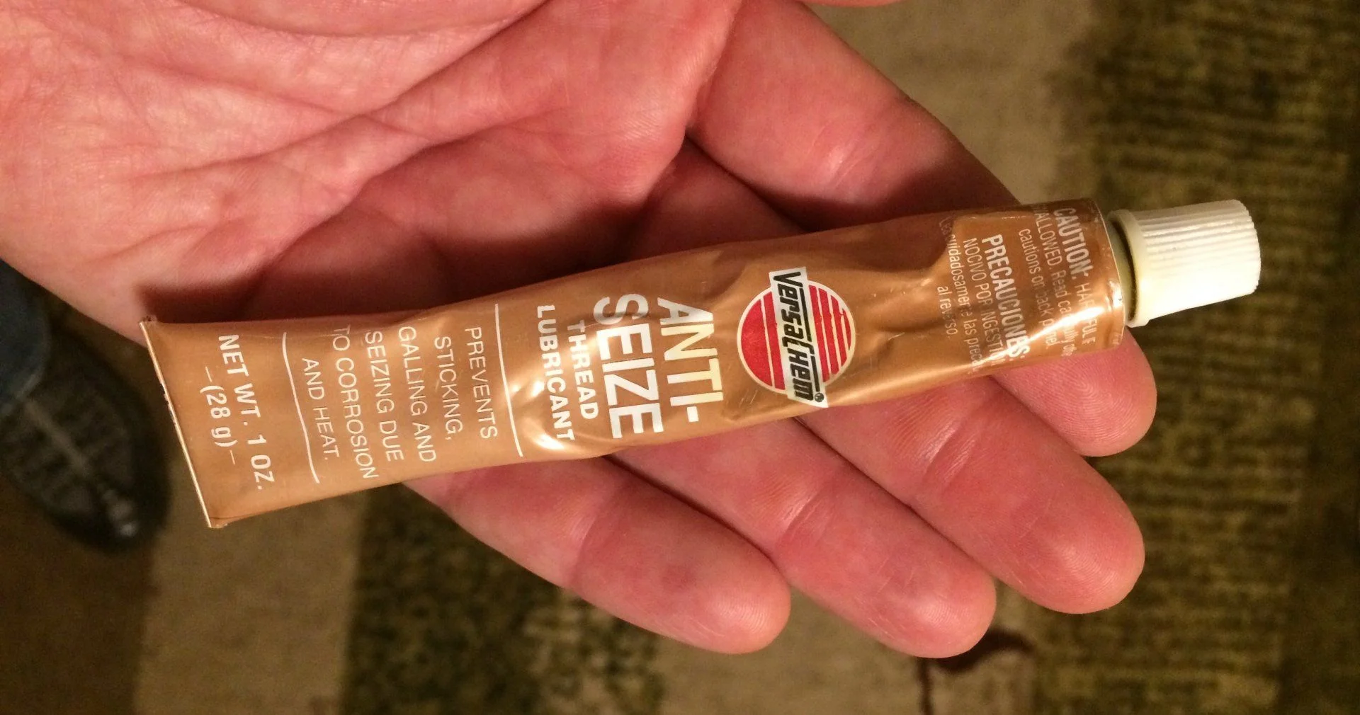

Is there a trick to preventing the RW rims from sticking to the hub? I know someone else had this problem but I can't find the thread. Last time I put mine on, one of them was a real pain to remove. I know I am using the right torque on the lug nuts. Do I need to sand/clean the inside of the RW wheel? Lube? Thoughts?
I had that same issue with my RWs early on. Had to use a pry-bar to get the fronts off...so similar to your problem.
I used this on the recommendation of my tire shop...and it worked a charm.
For good measure, I wire-brushed the crud off of the hubs and wheels first...then spread a very thin coat of this...
***...being careful to stay away from the bolts themselves, of course.***
Good news is...this stuff does NOT travel (run or spread) as it's almost metallic and white thick.
-I even checked several times just to be certain, and it did not move or spread. Works extremely well for the weird, sticky metal reaction between RW and hub.
You can find this at most auto parts stores.
After the corrosion on my previous Lexus' wheels, I used this on my new RWs and the mounting points still look new. It works great. Also good on the threads of any fastener that may see water or moisture- such as license plate screws which are notorious for rusting out.
