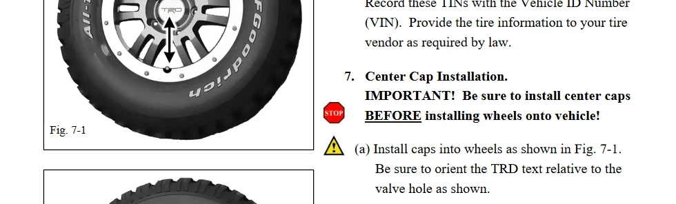

I understand the reason for 7, because of the unnecessary (and very thin) metal clips that like to pop off when the center cap is inserted. I removed them immediately after getting my Rock Warriors. I have found the center caps have plenty of tension on the wheel with the combination of the plastic clips and overall size of the center cap. If you have one handy, the best tool to put them in is a rubber mallet to protect the finish.
Perfect, thanks for all of the responses. So it sounds like:
- Install center caps when wheel is off the truck. The ones on the wheels that I bought were pretty much destroyed, so I bought a set of 4 OEM caps on eBay for $68 including shipping.
