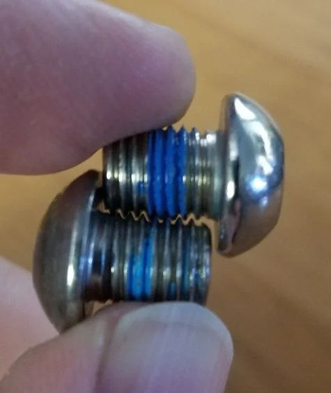

FYI, that Part# is incorrect.
The correct Part# for a set that fits the 17" TRD Rock Warrior wheel on the Tundra/Sequoia/Land Cruiser platforms is PTR45-34073.
HTH
I am glad I saw this. I ordered based on the other number. Huge price difference between the two.
I thought they were the same. And they are almost identical, but the PTR18-35093 bolt is about 1mm or less longer. I didn't think that would matter but it does.
I just tested it without the washer and it bottoms out. Won't seat the ring completely. 5x more expensive and less material.
Wonder if maybe thats where the lottle plastic
washers some ship with come in?
The only set of screws I ever ordered came with them.
My advice is pick that worthless loctite off and anti seize the hell out of them.

I don't think they are thick enough to make a difference. I was able to freely slide the ring back and forth with the one bolt cranked to the bottom.
Ya, prob true. The washerd are pretty thin.
