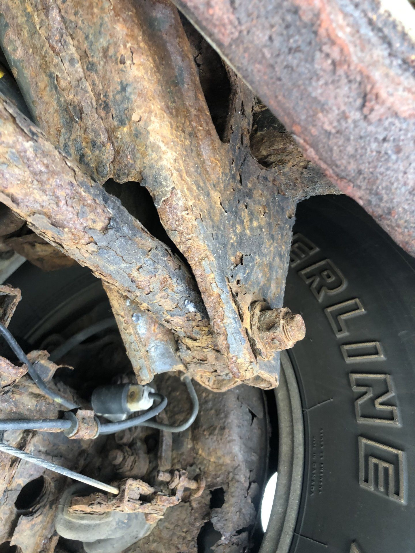

Bought my first 80 this weekend, and after getting it on a lift I returned it today. Seller was an honest guy. I don’t think he knew how bad the rust was and I got all my money back.

So the rusty rig... having lived around that kind of stuff up north... that is just irresponsible rust!

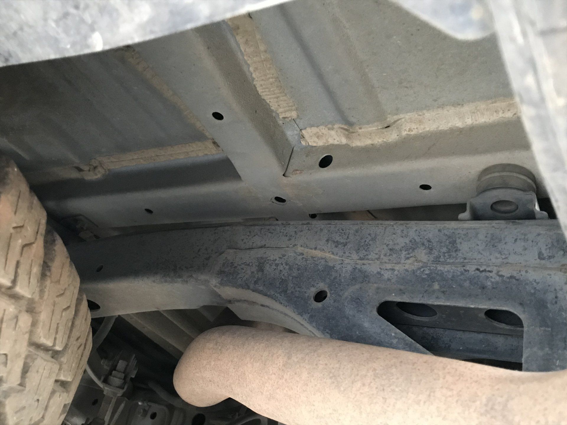

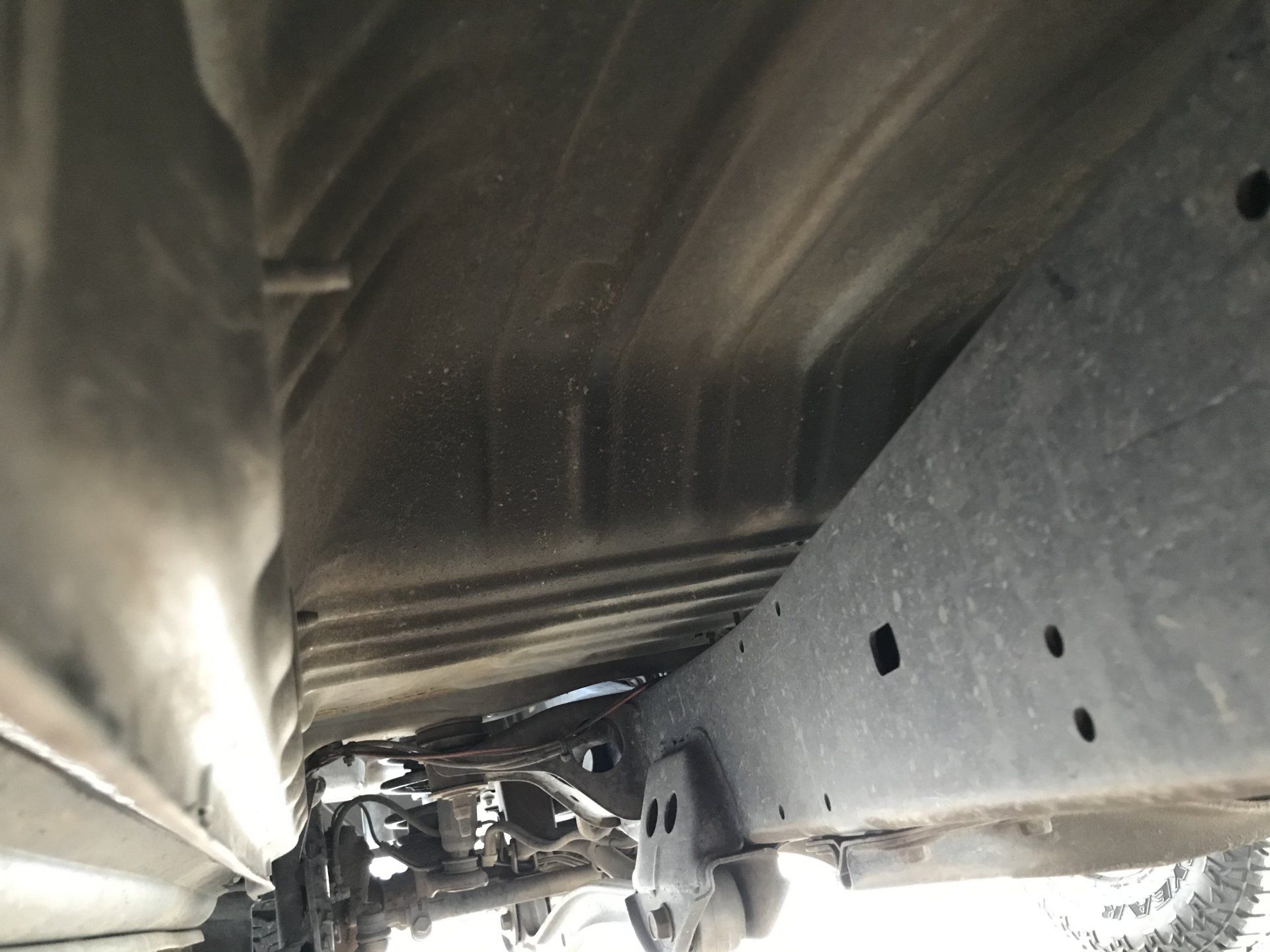

Great news, the 96 ended up being a good buy. Still has issues, but they’re all fixable. Terrible repaint for sure, but it was because the owner was a bit of an idiot and thought the oxidation required new paint. Two small rust areas on the body (front of hood, behind drivers rear door. Frame has minimal rust in some areas, no rust in most. The rust stain that was showing under the driver’s door was just paint rubbed off the bottom of door jamb in a small area. Looks to be feet dragging getting in/out since there are no sliders. Easy fix. Interior is about 85%. The dash has a few cracks (anyone ever tried the filler/coating method?), couple small stains, but the rest is great. Sunroof seals nicely and operates fine. Needs rear brakes, tires, and the center console compartment is busted. Overall I’m really looking forward to this project.
