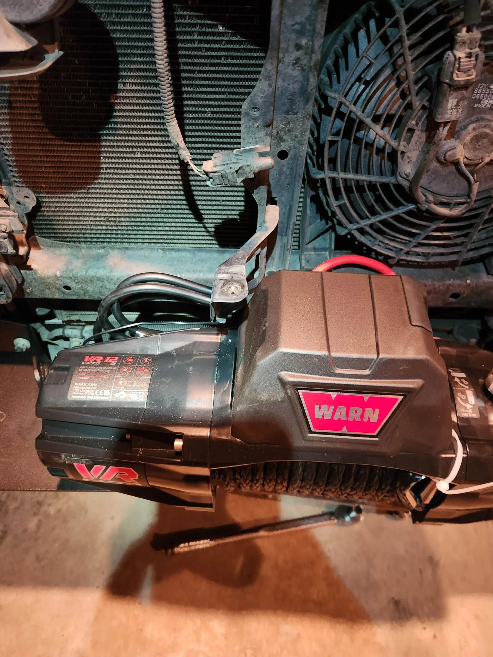

Starting my install tonight: mounting a Warn EVO 12S and notice the vertical sheet metal piece that the grille attaches to interferes with the controller. I see 2 options:
  1. Move the controller somewhere else, or
  2. Bend the sheet metal piece at the bottom of the vertical out of the way and just use the bolts on either side to connect the sheet metal crossmember.
What you guys that have already installed like?
Move the controller is reversible.
I have an LX, so had quite a few items to work around, this is one of them, but in my install the bumper hit that crosspiece, on a TLC the bumper doesn’t, so it’s just winch controller.
In my Lx install, I fanned a new crosspiece and mounted the controller to it, behind the grill.
If you have a tlc, you can just mount that controller above the crosspiece.
@grinchy So I took your advice, but can't decide where to put the controller. If I mount it behind the grill above the crosspiece seems like it would be hard to reach up to connect the cable...
I can trim off the bottom part of that crosspiece support without completely removing it and put controller back on top of winch...
Anybody got a really cool spot for Warn controller in 200-series front end with this winch??
If you have the spot between the air filter and firewall on US passenger side open that works well.
My controller I could orient so the plug in was accessible thru the grille. This all varies by truck and winch type so it’s hard to generalize
