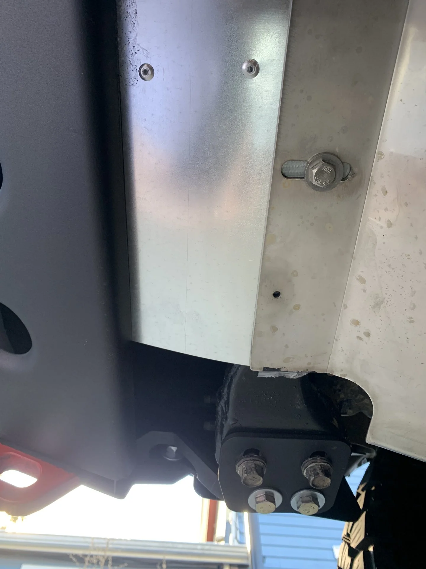

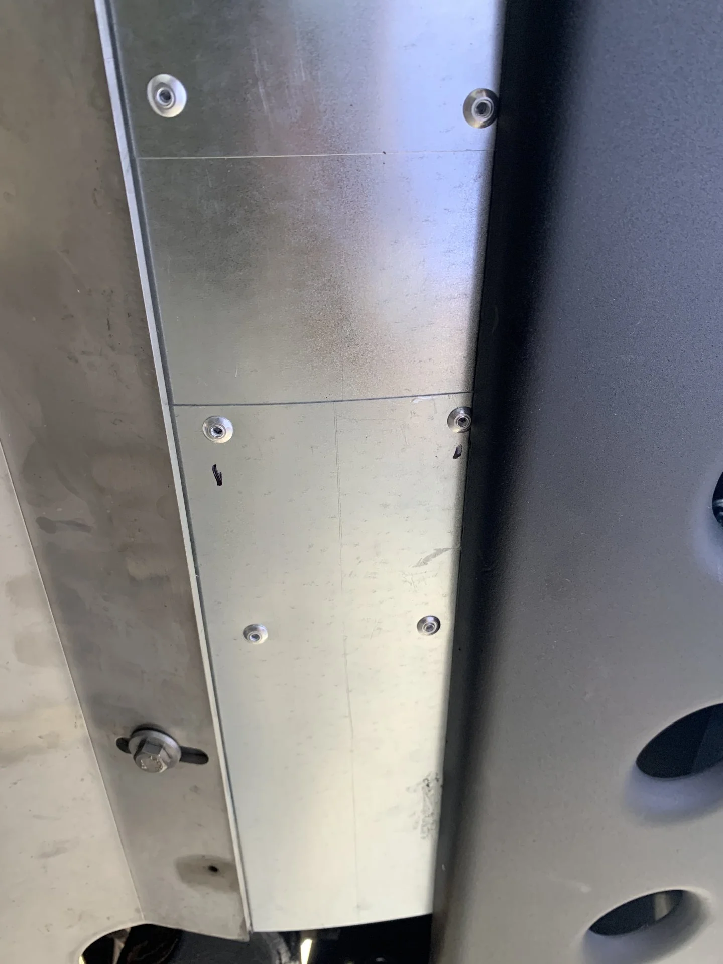

I have a <budbuilt>front skid and this bumper. There is a small 3 or 4” gap which would probably never be an issue. I just put a small filler piece made of galvanized shingle in it’s to deflect the random small branch that might somehow get in that area.

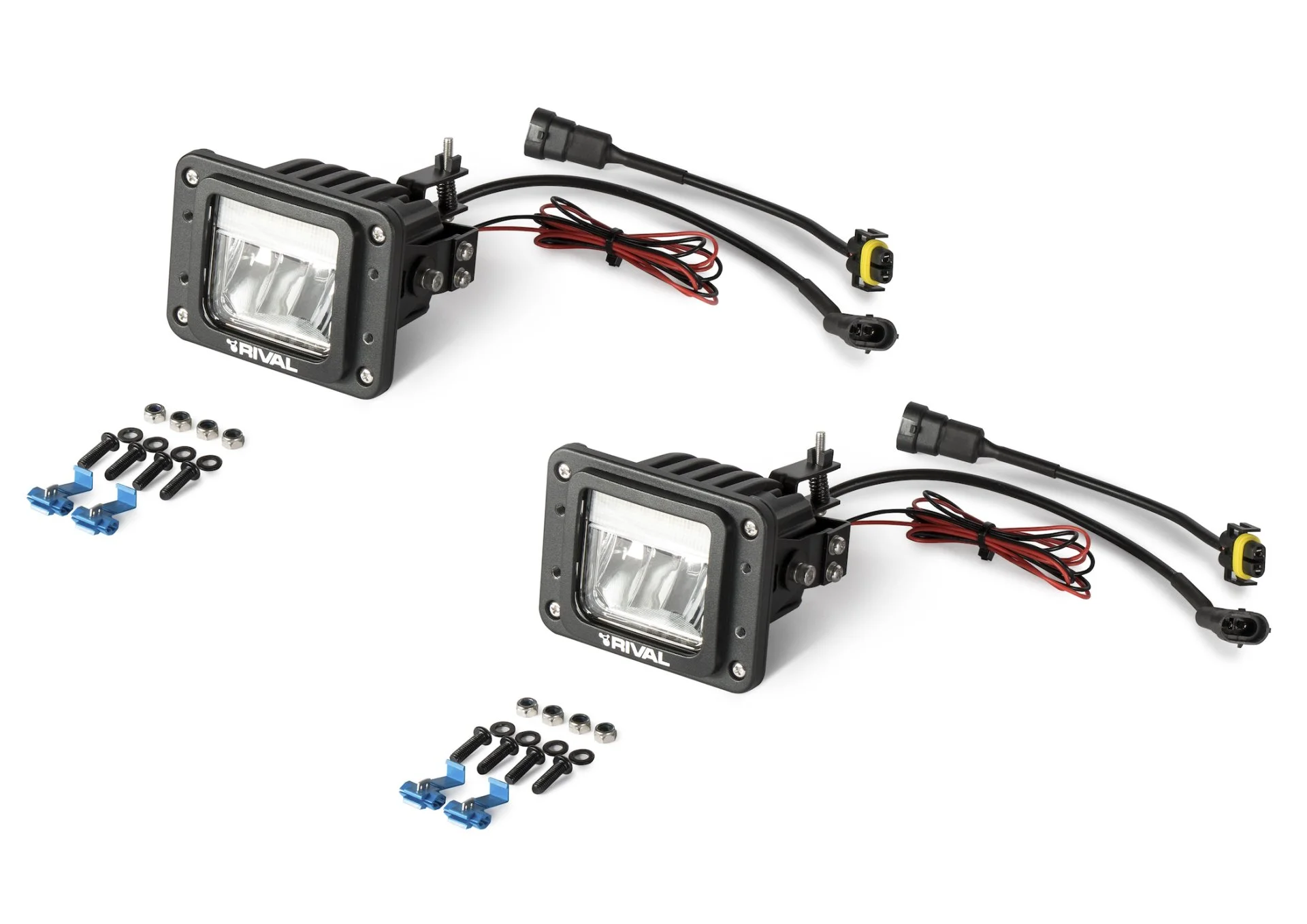

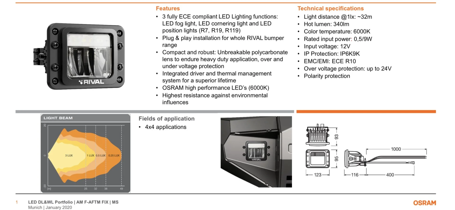

Looks like my next order. Can you tap into your existing harness to your original fog lights? Thanks
On Toyotas they are plug and play (Jeep folks have issues with it mostly).
Here are more pictures and specs:

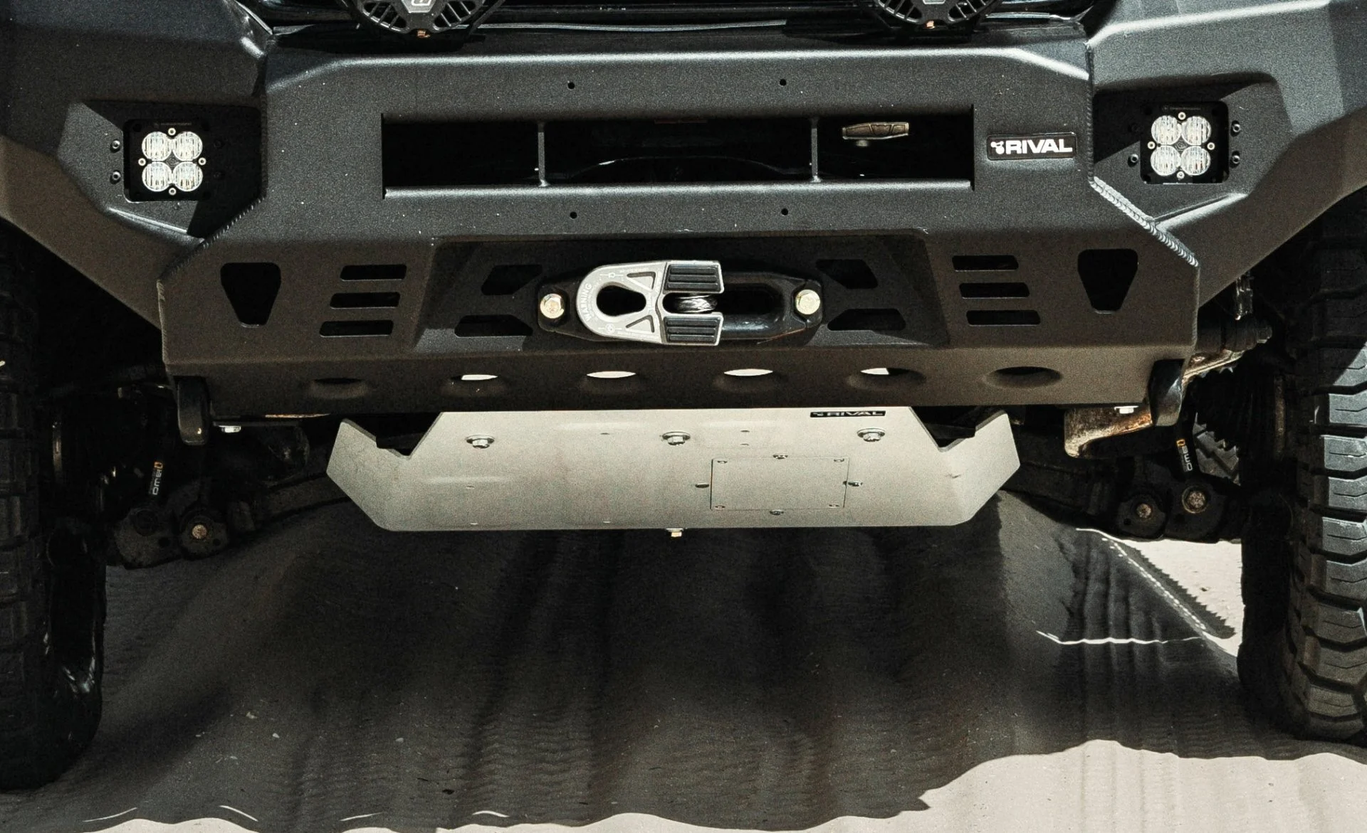

@RIVAL 4x4 are there any skids that you would recommend or not recommend that integrate or at least not obstruct?
I kinda wanted the Slee Skids for my 200 to protect and also cover some of the cats.

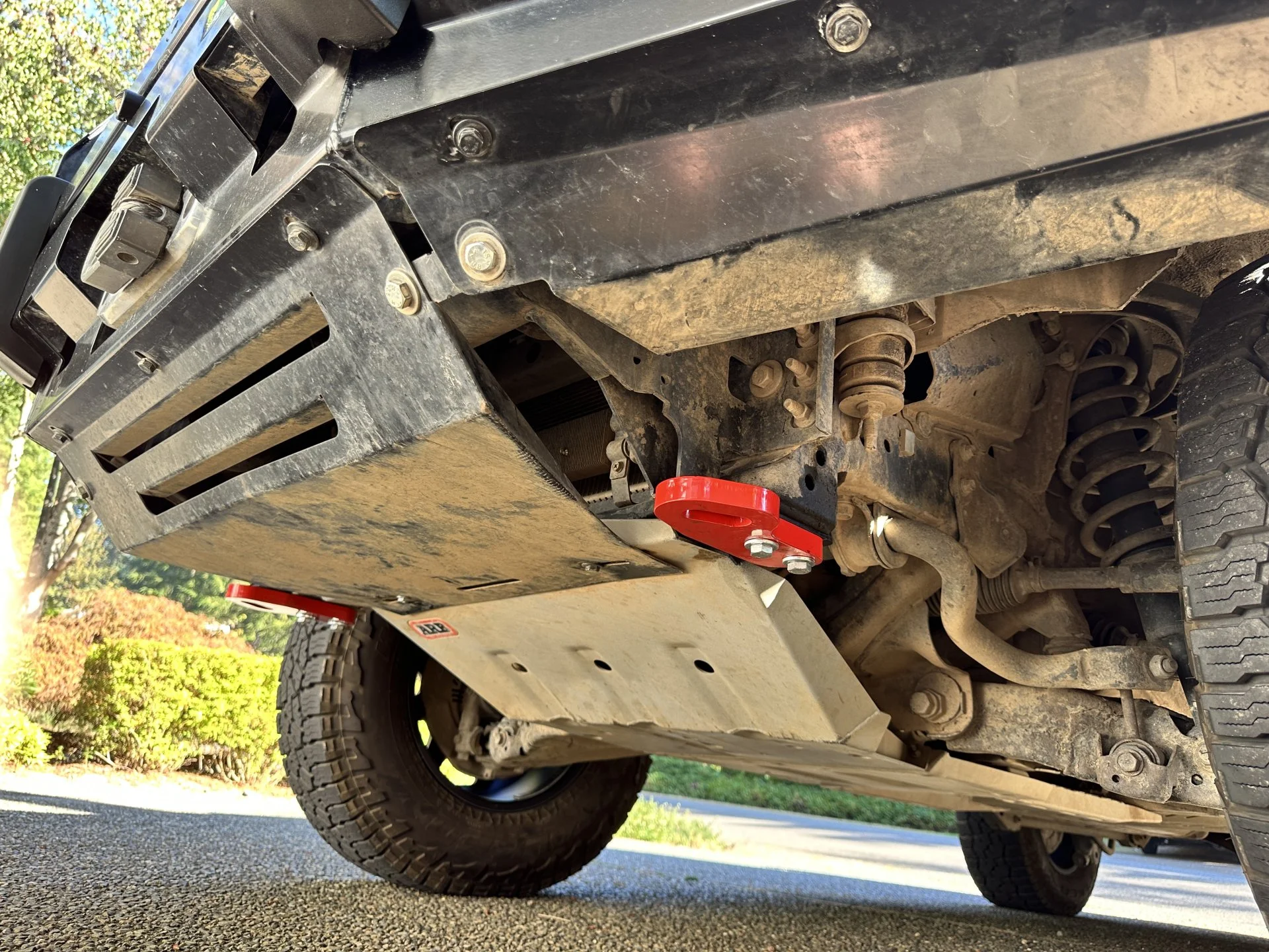

Our 1/4in thick aluminum skids are matching but should admit they are not as wide as some manufacturers do.

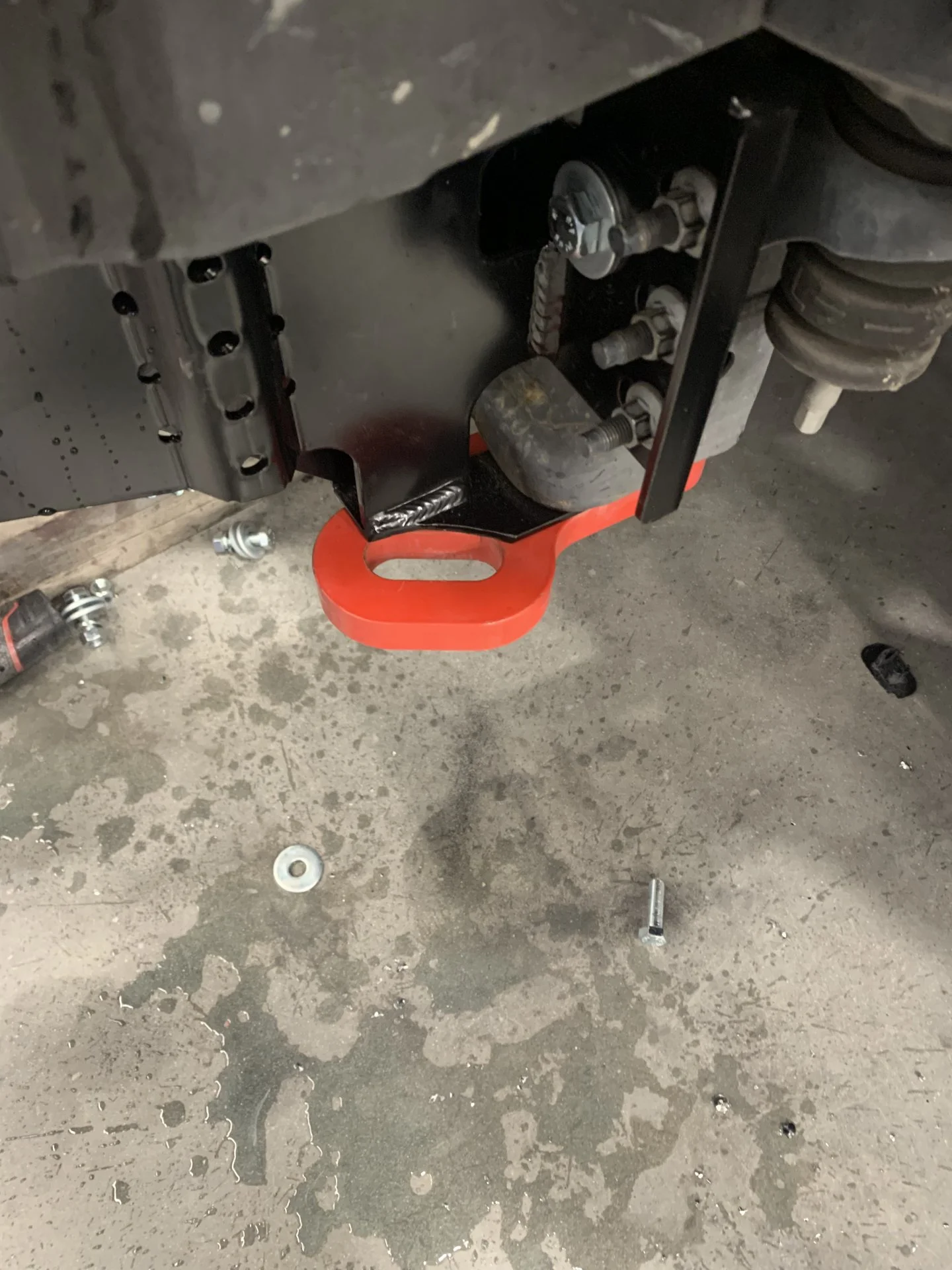

For what it’s worth you can run a standard recovery on the iron man if you notch the bracket
