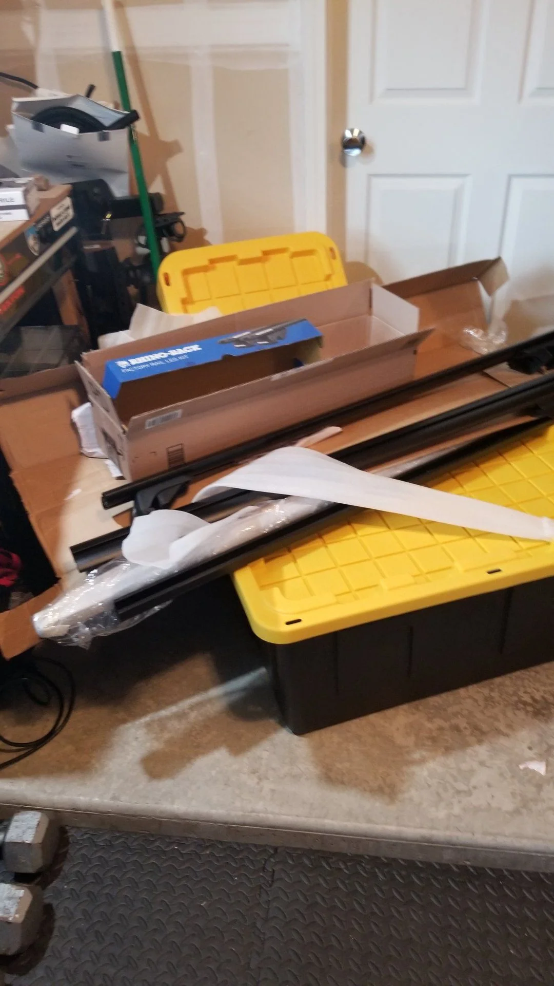

Well, got everything in....Rhino pioneer rack at 60x54 (wish I'd gone 49 wide), sx100 vortex feet, and the Rhino Rack SXB conversion kit. In spite of the sxb kit claiming compatibility with the vortex feet, they are not. So now I have an email i to Rhino Rack asking for assistance on whether or not i can just switch crossbars, or I have to come up with another solution. Good thing is I got it all thru Amazon so free returns.

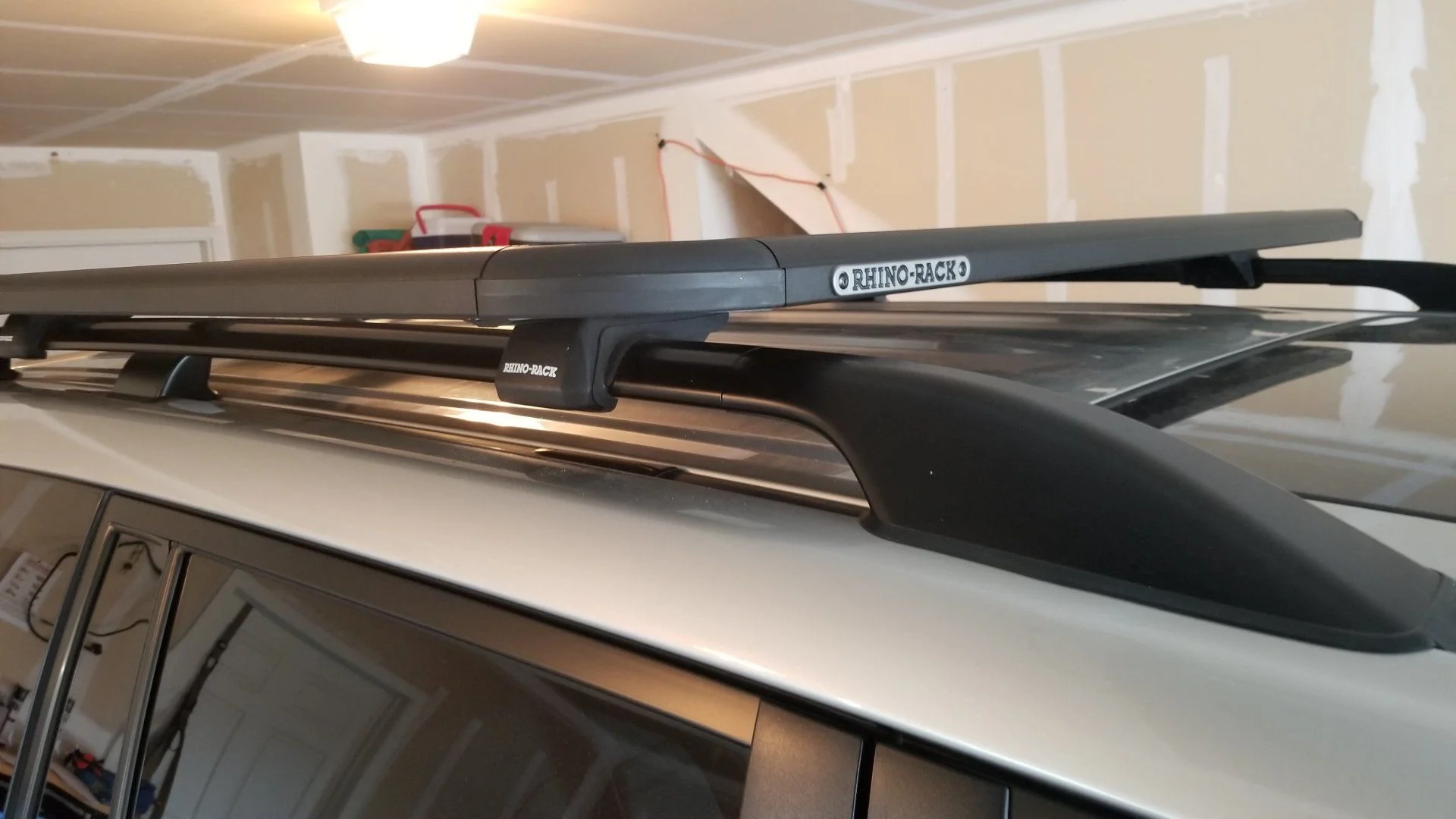

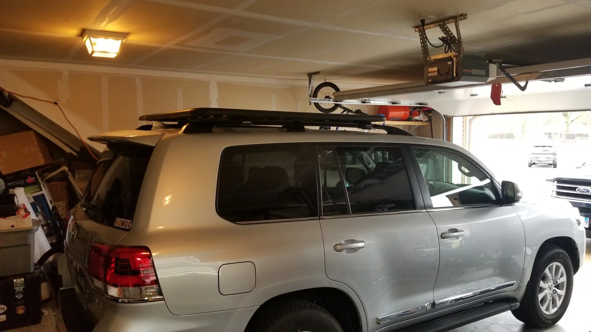

So finally got around to installing the 60x54 Rhino Pioneer rack with Vortex SX100 mounts on the stock rails...
After alot of trial and error with part numbers and fitment, I got what was needed....the sx conversion kit, vortex sx100 feet, and of course the 60x54 rack.
I had to navigate 3 sets of instructions simultaneously to succeed but it worked out. And since I am the only man in the house with 4 little girls and a pregnant wife, and no buddies around at 7am to help, I had some AFG engineering to get the rack up on top without damaging anything . The most tedious part was lining up the vortex bars on the rails.
I had to navigate 3 sets of instructions simultaneously to succeed but it worked out. And since I am the only man in the house with 4 little girls and a pregnant wife, and no buddies around at 7am to help, I had some AFG engineering to get the rack up on top without damaging anything . The most tedious part was lining up the vortex bars on the rails.View attachment 2641248
No driving or use impressions yet but will post back on noise, etc....I do have a Rhino wind deflector coming this week. We will see how that works out.
Looks like a great setup that takes advantage of the stock rack. I like it. Please let us know how you like it after some driving time. I'm most interested to hear about wind noise.

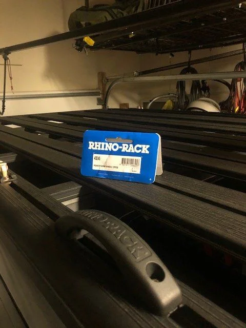

I also found a couple great additions were some black seat track pieces and the Rhino Rack handles.
I originally thought I wanted a narrower platform to stay more in line with the width of the roof, but now that it is on, I like it and you're right, a place to hold on too is great. And actually, the stock rails now act as integrated hand rails.
How much taller are the aero bars above the factory side rails? Looks like maybe an inch and a half?
thanks!
