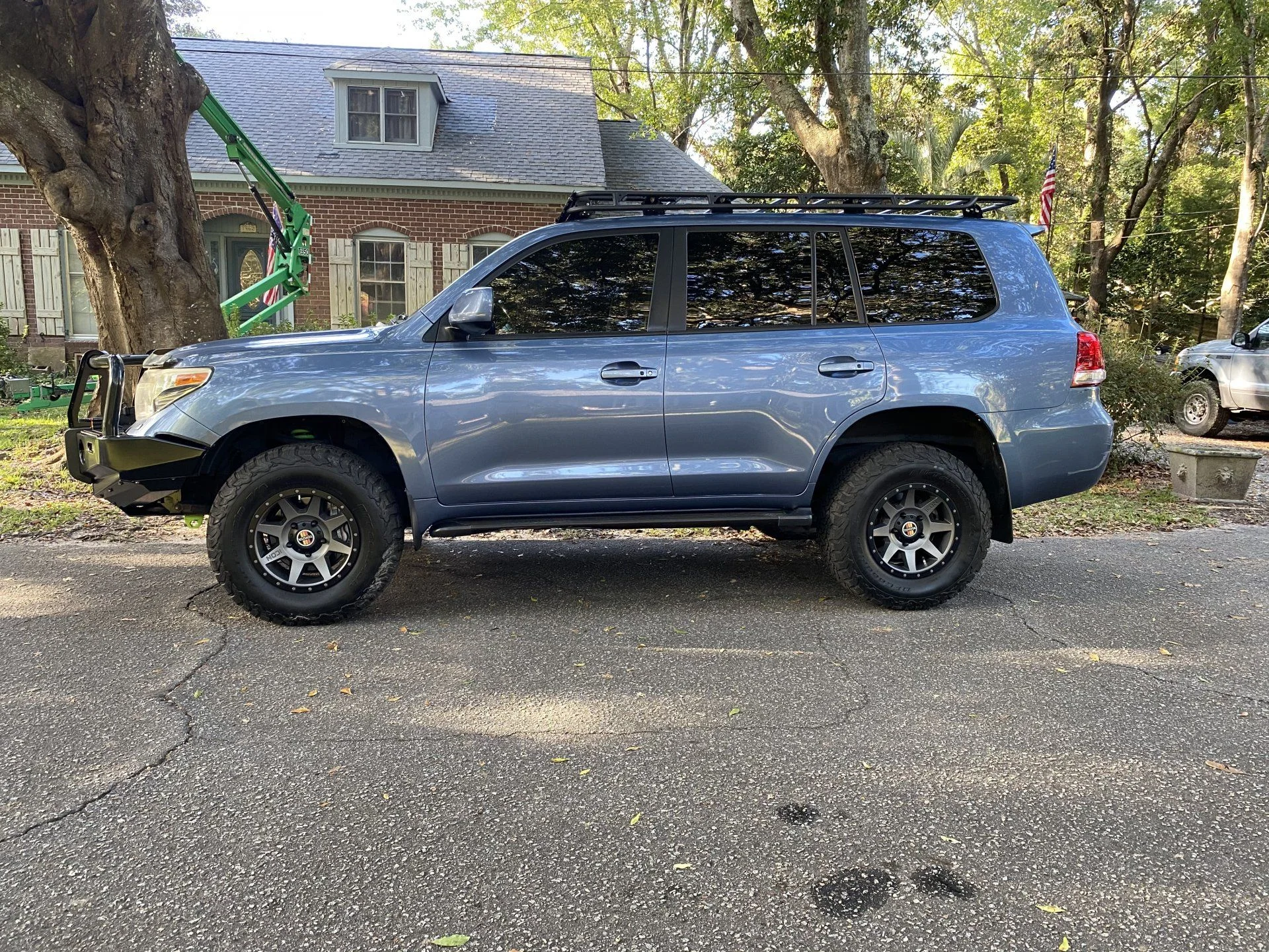

FWIW I ordered the Rhino Rack package with the SX attachments to the factory LC200 side rails. I'm not planning to carry an RTT and I like that I don't have to remove the OEM roof rails to install it. That was the decider. TY @catastrofe for recommending Rhino Rack. I will of course post pix. ALSO, I ended up ordering from Backcountry Racks. Zero Tax, Free Shipping and less than the MSRP on the Rhino Rack site.

have you installed? pics?
You'll love the Rhino Rack, I recently installed one on our GX and I couldn't be happier. Take your time assembling the platform and get the support bars exactly where the instructions tell you to which shouldn't be hard with the clearly marked lines on the underside. I have yet to see another rack with this kind of attention to detail, top notch stuff for sure. I look forward to seeing the end result on your 200 as I will likely be looking for a rack for our 200 later this year.
