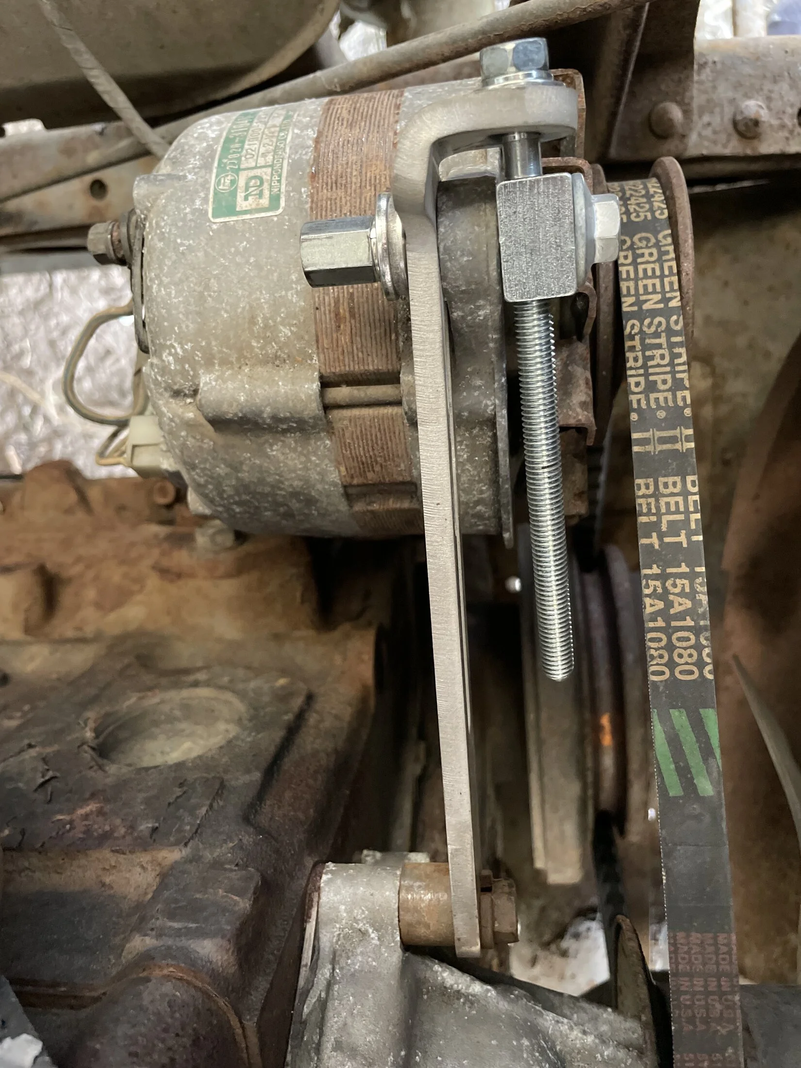

OK everyone, I need my work double checked. Thanks to @GA Architect I'm equiped wtih the knowledge to look up parts for my 75' RHD FJ45.
I have 2 part numbers that I found through the Toyota online parts catalog.
99343-11060-77
99343-11070
I believe I can order both of these from my dealer that gives a mud discount but which one is the correct one for my application?
can someone enlighten me as to the correct choice?
Thank you.
Current belt is waaayyyy to long.
Current belt is waaayyyy to long. View attachment 3905923
either your pulley is worn or that is the wrong size belt, or the belt is worn
see how far down into the pulley the belt sits, it should be about flush with the edge of the pulley, not sunk down in
how does the belt look on the other pullies?
Oh I know the belt is not the right one. It was a left over from somewhere that I used to get the rig up and running. It’s too long and as you point out too skinny. It’s fine for in the driveway making sure everything is operable but I need the correct one so I can start driving her. Tough to decipher which is the appropriate one from the interwebs. At least for me it’s tough.
