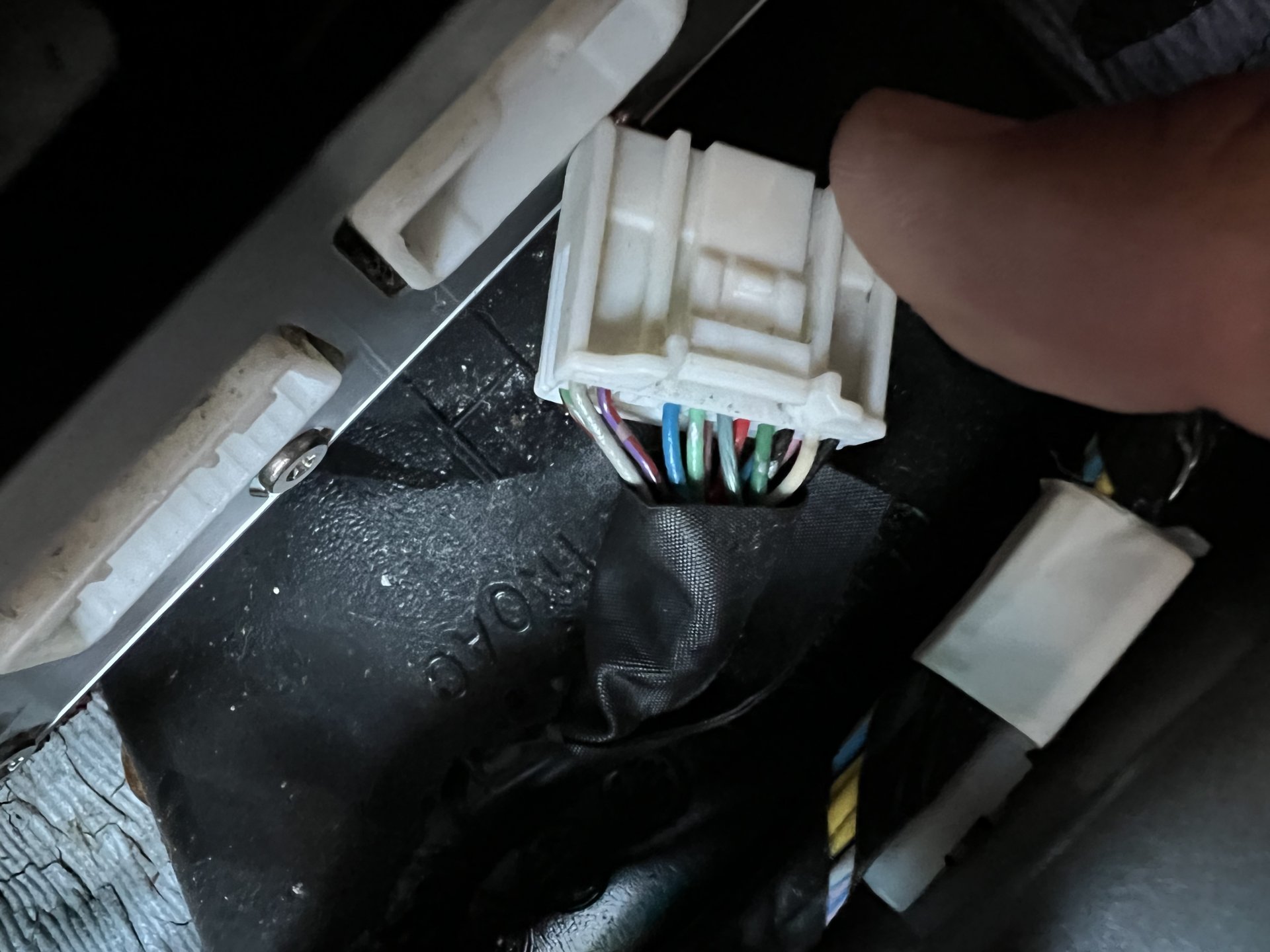

Having a weird issue with the rear lights on a 2006 GX470 while installing a rear camera. Everything seemed fine as I was figuring out the wiring connectors in PS rear quarter. This area is really tight due to rear AC.

I did not change anything with regards to wiring. I was still at the early stage of just trying to identify which wire in rear PS quarter connector was reverse. And yes, I regret now not just tapping both right at the socket. Still may go that route. Mainly I forgot there was no reverse light in brake/turn signal housing.

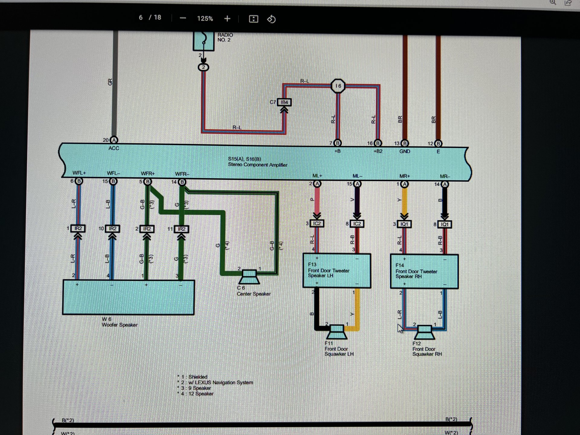

I’m having the same problem after installing a subwoofer amp. The Skar amp has an ‘on/off’ trigger that is just a voltage sensor. I tapped an accessory power line that was going into or out of the Mark Levinson factory amp. Worked fine for a day or so, then the A/C stopped working - throwing a ‘not connected’ error on the nav display. A day or so later, I lost my turn signals and reverse lights?
I’ve checked the voltage on both sides of thr accessory power line that I had tapped for the amp’s ‘turn on’ voltage sensor line. Everything reads 11.6ish volts in any segment.

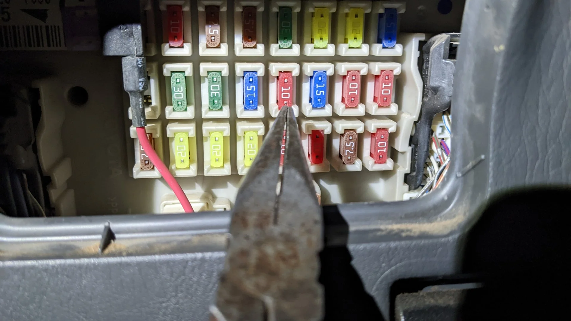

I ran into this when doing Prado tails swap this weekend. Check this fuse...
Ig1 no. 2 fuse
This was my problem as well!
I made the same diagnostic mistake: I used a continuity tester on the fuses while they were still plugged in and that particular fuse tested out good while plugged in. Doh!!!
TLDR - remove every fuse and test it because testing it while it’s plugged in can give you a false positive result!
Great Scott man! Ig1 - I ran myself around for ever this afternoon and your one post solved my issue - 2006 V8 4Runner - Mint condition until I started monkeying around with the reverse camera install. -- Thank you for your spot-on post!
