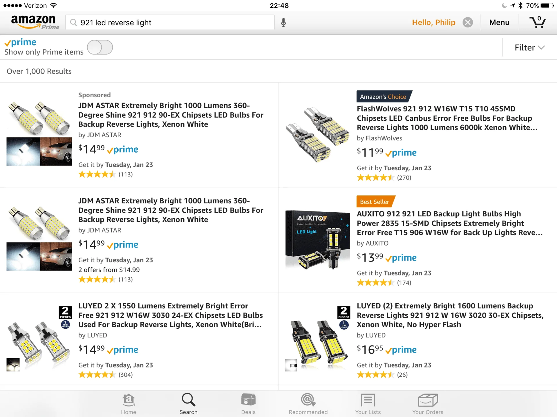

Those look interesting, but my LX470 wants 921 bulbs. I don't think these will work and I can't find a 921 equivalent on Amazon.

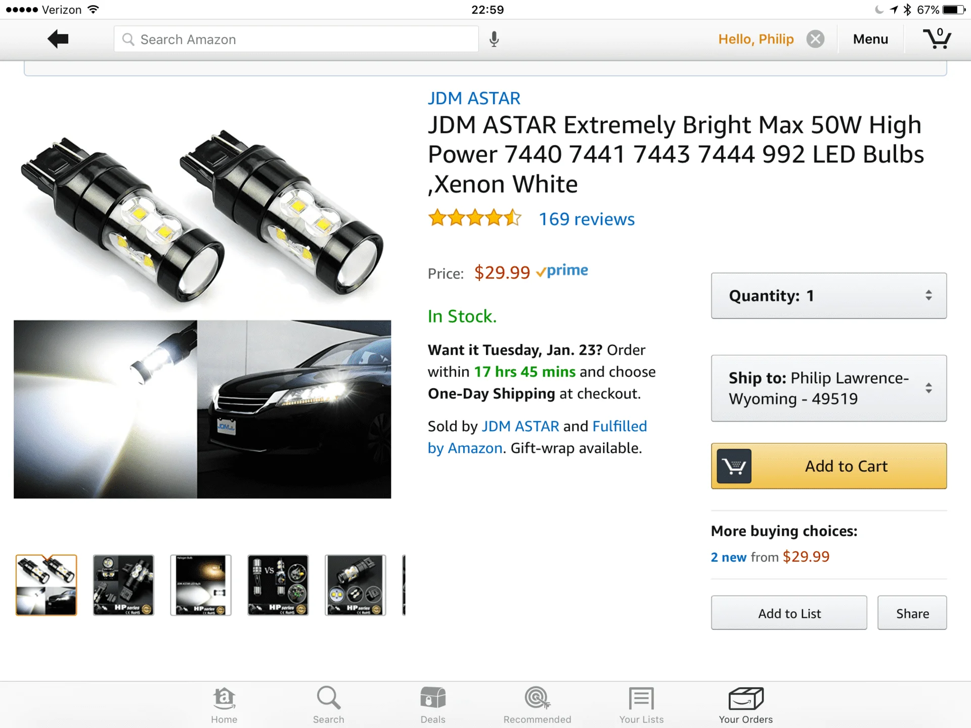

Here are the ones I installed in my truck, I am pleased with them. Put them in my wives van too.
I installed the JDM ASTARS listed above and have been happy
Pfran has a pair of reverse lights that helped me out significantly, worth trying that before you go too crazy.
I tried his Cree bulbs for a while. They were very spotlight-ish and didn't illuminate the area directly around the vehicle.
These are what I have in right now. They look very bright for other people to see my vehicle, but aren't providing enough light to show anything in the rear view camera or through the mirrors on a dark night.

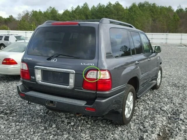

On the '03+ LX, do any bulbs reside here? If none, perhaps supplement your existing reverse lights with more?

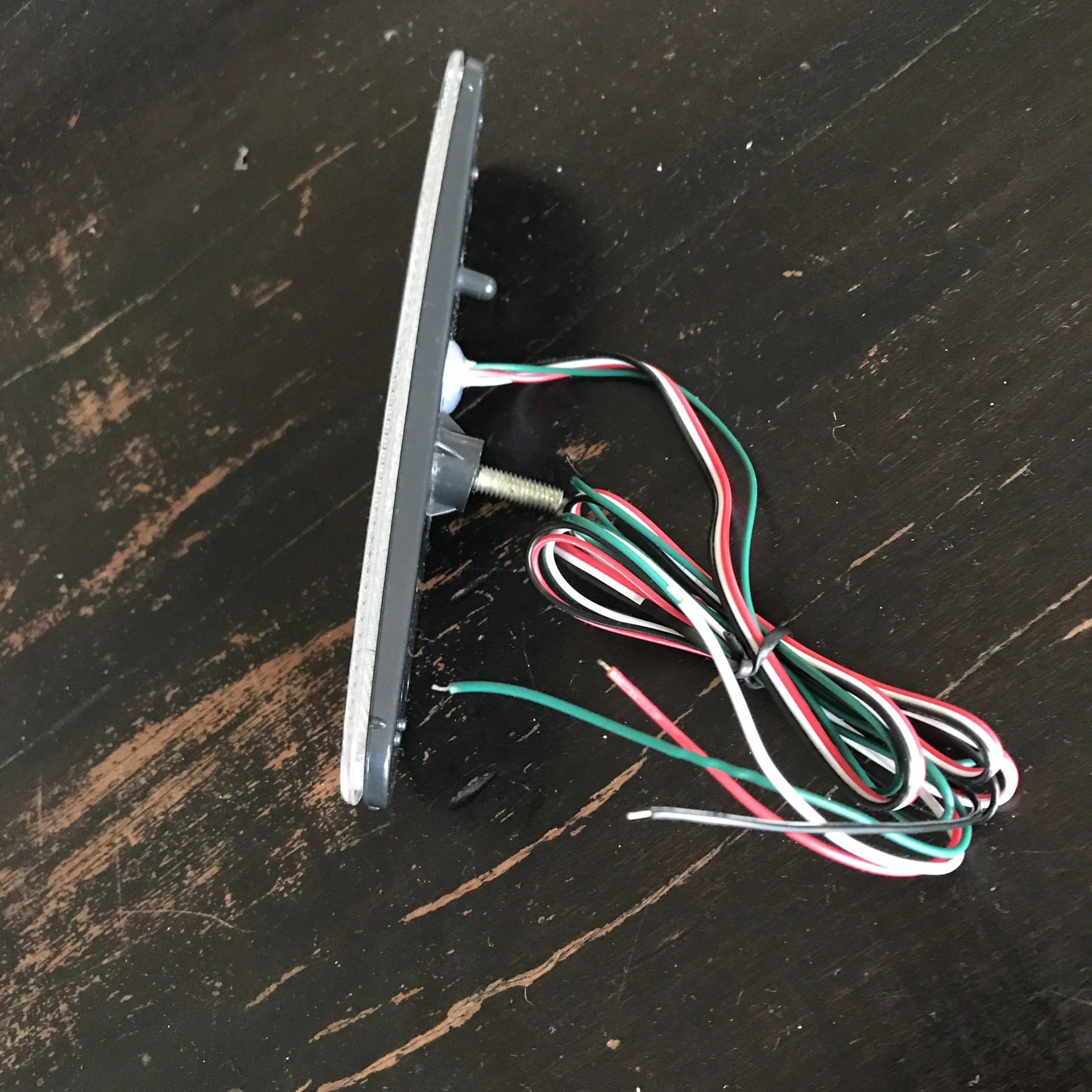

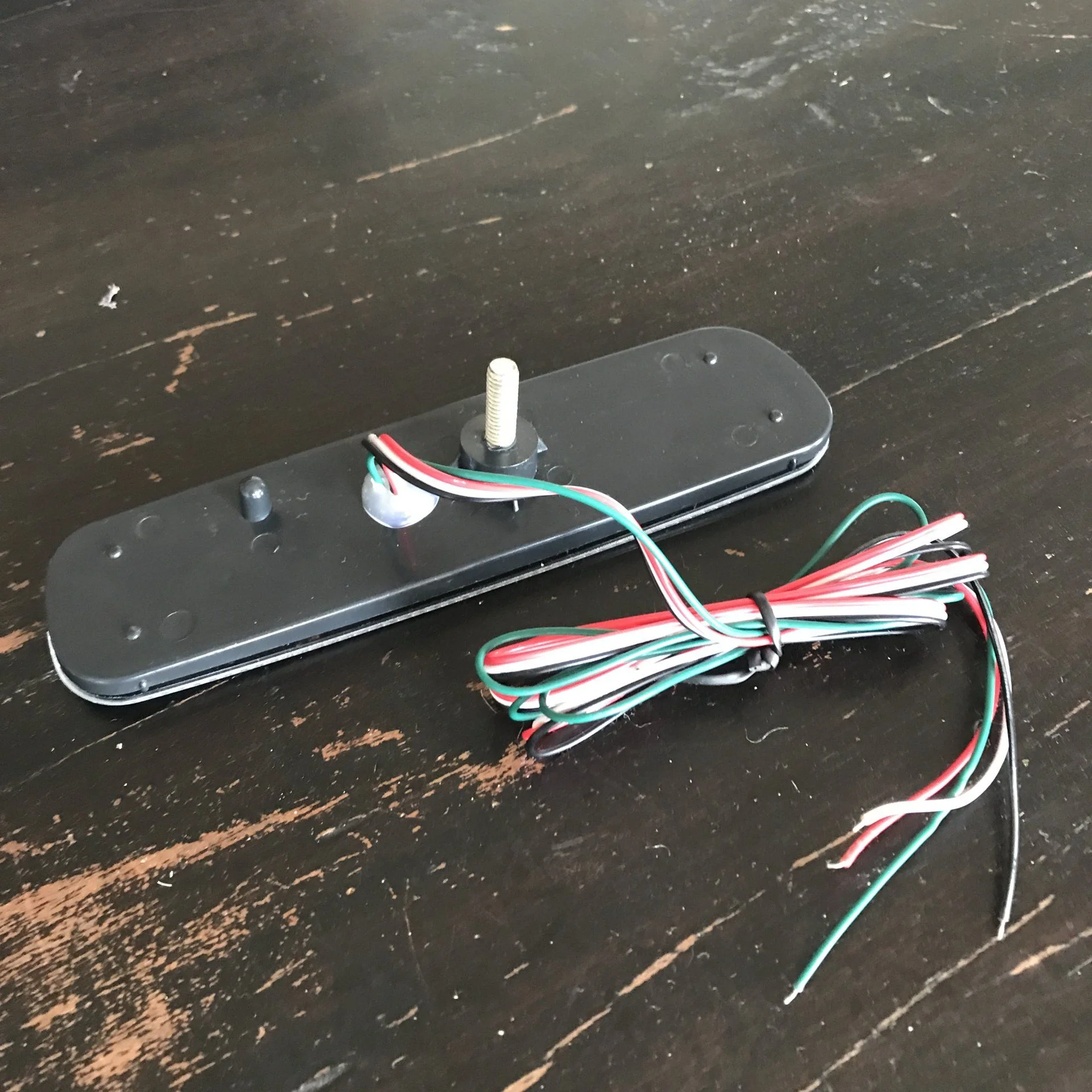

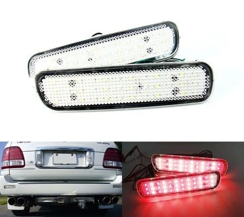

The eBay lights are drop-in replacements for the OEM reflectors and measure 6.07" x 1.57", so it looks like the body of the Amazon lights is sized right for the existing opening. BUT, the eBay lights and OEM reflectors are very shallow at 0.38" deep with a mounting bolt protruding as well. So, you're gonna have to cut out some of whatever is behind the OEM reflectors to get the Amazon's to fit. (I haven't removed one to see even though it's just one nut. We can thank H3N2 for that.)
Here are some eBay light pics so you can get an idea of things:
