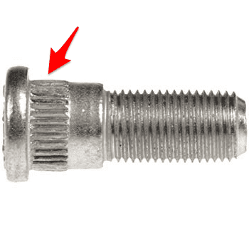

While lots of people re-use wheel studs after replacing a rotor, there's not an insignificant risk of possibly stripping the splines down the road when trying to remove a tight nut.
When the stud gets pressed (or pounded) in, the stud splines round off their sharp edges a tad. Then when removed, more of the same. Then when reinstalled... more of the same.
A re-used stud definitely doesn't have the same grip on the hub as a brand new one. Whether it'll strip and spin in the future when trying to repair a flat on the side of the highway is the million dollar question.
