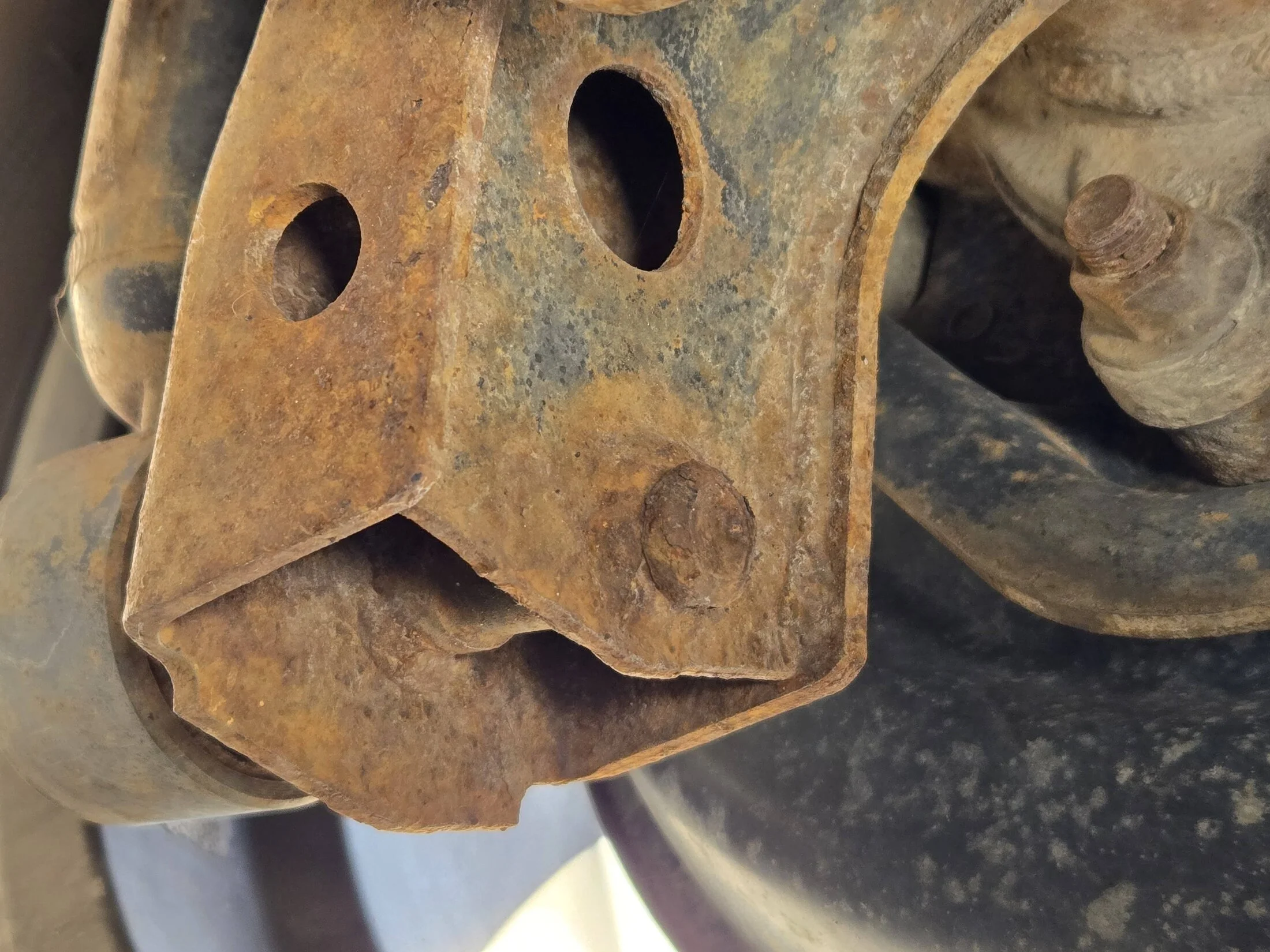

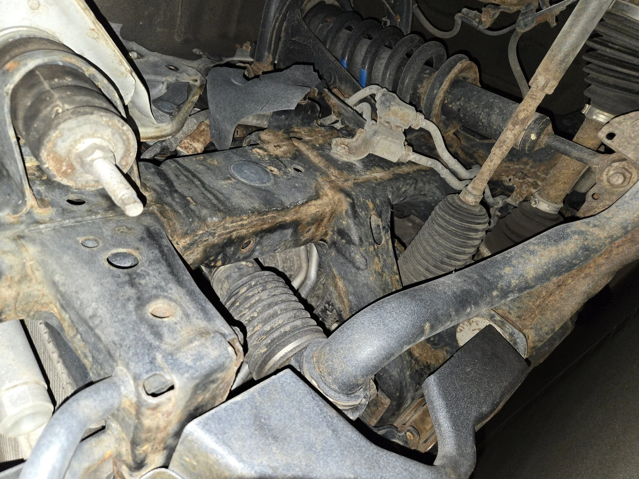

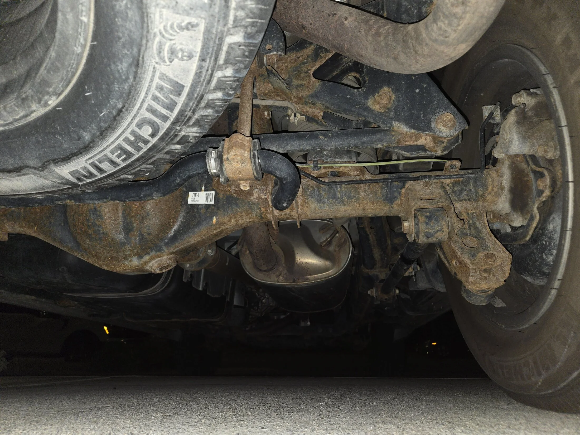

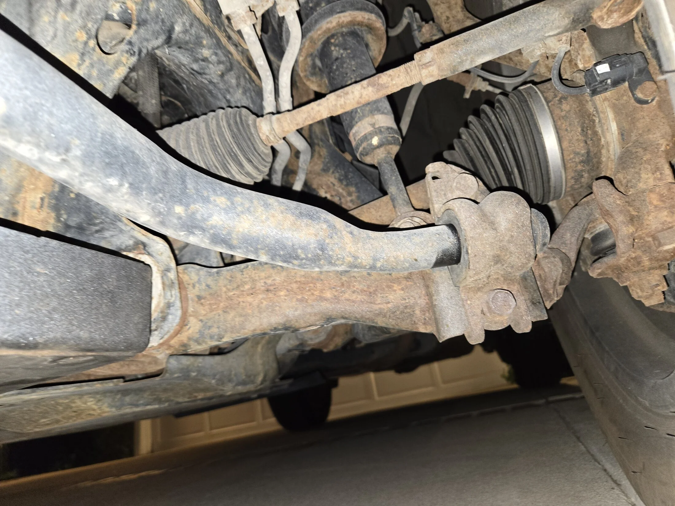

I slid under the car yesterday myself after driving back from the dealer and took some pictures. And frankly, it looked pretty bad to me, and now I'm questioning my purchase.
I have 7 days/700 miles to return the car, no questions asked, but would probably need to ship it back, since I've already driven 400/700.
I'm kind of lost with what decision to take. How bad is this rust?
Should I just take the $1k loss (one way flight, PPI, shipment cost of the car back to Sacramento) and walk away and keep looking, and take it as an expensive lesson learned?

There is no rust that's penetrating, it's all surface which can be easily knocked off with a wire brush.
Get the rig, and either pay someone or get under it yourself and clean it up, maybe add an undercoating and you'll be very happy with it.

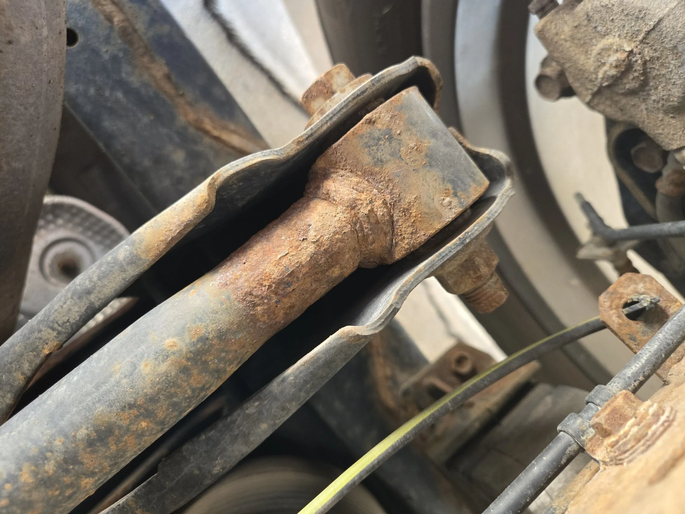

That's not "bad" persay, and would be typical for a GX from the lower midwest. My GX was about the same when I bought it. If you work on the rig, you will probably end up rounding off, stripping, or breaking a few bolts. It's not the end of the world, it will just add a few hours to the job when it happens. The problem you might run into is a lack of experience in local mechanics (and yourself if you are DIY wrenching) in dealing with rusty fasteners and knowing how to move past them.
IMO, $23K is a bit steep for a 2012, regardless of the mileage, but that's in my local market. A quick search on Cargurus in my area shows several 2014-2016 models with similar mileage as that one for around $23K. The undersides will probably look the same as your 2012.
For my personal rig, I treated the inside of the frame with Fluid Film and the outside with Woolwax Black. I purchased the rig in 2020, did the first application in the spring of 2021, and the second in the spring of 2024. The treatment completely stopped the rust progression - and that included over 3 winters with salt on the roads. I'd recommend the same if you keep the rig, except you'll probably need to treat it far less often. It's a pretty easy DIY job with the Woolwax applicator gun and a small air compressor. It should be around $300 total investment to do that, even if you need to buy a small pancake air compressor, and you'll have enough left over for 1-2 future re-treatments.
My 2015 GX460 that lived 120k in Iowa has way less rust than this. I would be concerned with the rust you can't see.
I'd return it but then again I would have looked underneath to check for rust before I would have even opened the driver's door.
GX460s aren't that hard to find.
I've got a 2013 with about 150K on it that's lived in Virginia all it's life and and I have nothing even close to that for rust.
It's been somewhere....maybe the dude had a vacation home in the rust belt. I'm super OCD, but I'd return it...
Ship it back and take the hit. There's plenty of GX's out there.
Guys, this can be mitigated for around $300. If this rig is cherry otherwise - good maintenance history, no trans issues or valley plate leak - I'd personally prefer it over a rust-free one that's gonna need $5-7K plus in mechanical repairs dumped in it.
I do think the price is a bit high - by Midwestern standards where a 2012 is just a 13-year old SUV and nothing too special. Around here, it probably should have been priced closer to $17-20K. So ultimately it's up to the OP, based on what other rust-free GXs are going through in his local market and the mechanical condition of this GX relative to those.
If it has any trans or valley plate issues at all I'd personally take it back.
