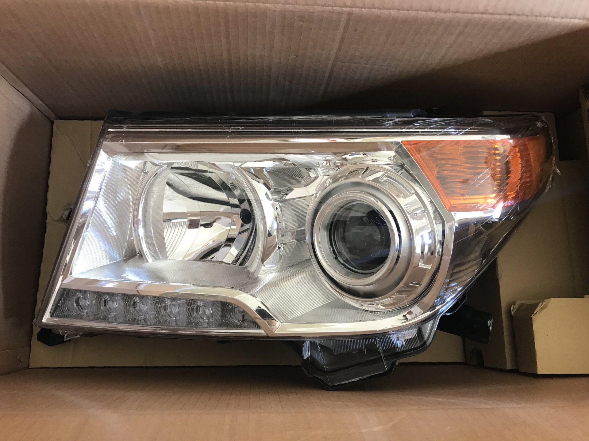

These are the ones I was considering, anyone use them???
Adding no name from China electronics to a vehicle this reliable would make me nervous. It’s still a lot of money to add potential headaches to you electric system. I saw a thread somewhere once somebody had a lot of negative things to say about EBay aftermarket headlights he bought. Can’t find the post now
I do remember that, the low beam wobbled if I remember right.
I did it. I used OEM ballasts and bulbs. No concerns there. Low beams do wobble and it took a few rounds of silicone to make sure they were sealed up and didn't fog. You get what you pay for in this. OEM is best but the ebay ones are doable with a little effort. Install isn't difficult.
The ebay headlights come with connectors for the 2013 so they will not be plug and play either. Might as well fork out the extra cash for the genuine headlights. Make sure to get the Euro spec ones which have bixenon projectors and DRL LEDs. I posted the part numbers in the thread linked above

Totally agree. If I had to do it again, Id just fork out the extra money for the OEM ones. Its not like the eBay ones are cheap, they're still going to cost you ~$500 bucks or so.
List for OE is about $850 per side though.. Deals can be had but you'll still spend twice as much as the ebay junk.

Those are from the same place in China that I bought. Be prepared to have to seal them up. In addition, I'd retrofit good quality projectors into them prior to installation, and make sure they're secured properly.

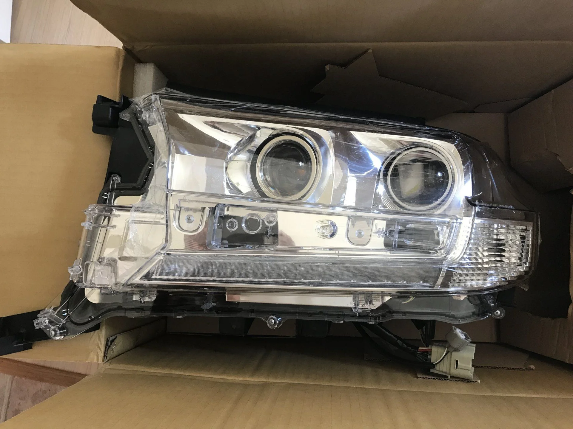

Not yet, I have one side of the 2013 HID DEPO lamp, but not the other sides. Ordered the wrong one in my previous shipment, ordered the 2016 on the other sides instead. :bang:Will make sure I order the correct side this time for upcoming shipment.
