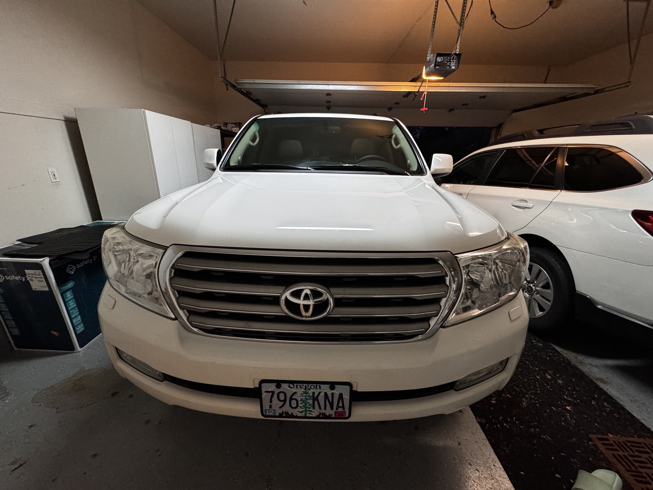

View attachment 1901375View attachment 1901376

Ok so I bit the bullet and did the mod. Was a big gamble given east headlight was $600 each and install was another $100. Did it during my radiator preventative maintenance replacement. Replaced the heater tees and fan and fan clutch while we were in there.
The big lesson is (and as someone pointed out on another thread) there is some plastic modification required to get it to fit, there was some interference between the tab on the bottom and the headlight washer system. My guy had to take a handsaw and cut away to make things fit with the old style bumper.
I tried to run leds on the high beam but they cut out almost immediately and one of the two Phillips HID bulbs I got is a little yellower than the other one which is white. I’m suspecting something’s up with the bulb so I have another one on order.
It does modernize the front end of the truck a lot. Love the improvement in lighting at night which was the main reason I did it. I finally like the front and look of my car now!! Used to hate how the halogen housing looked.
