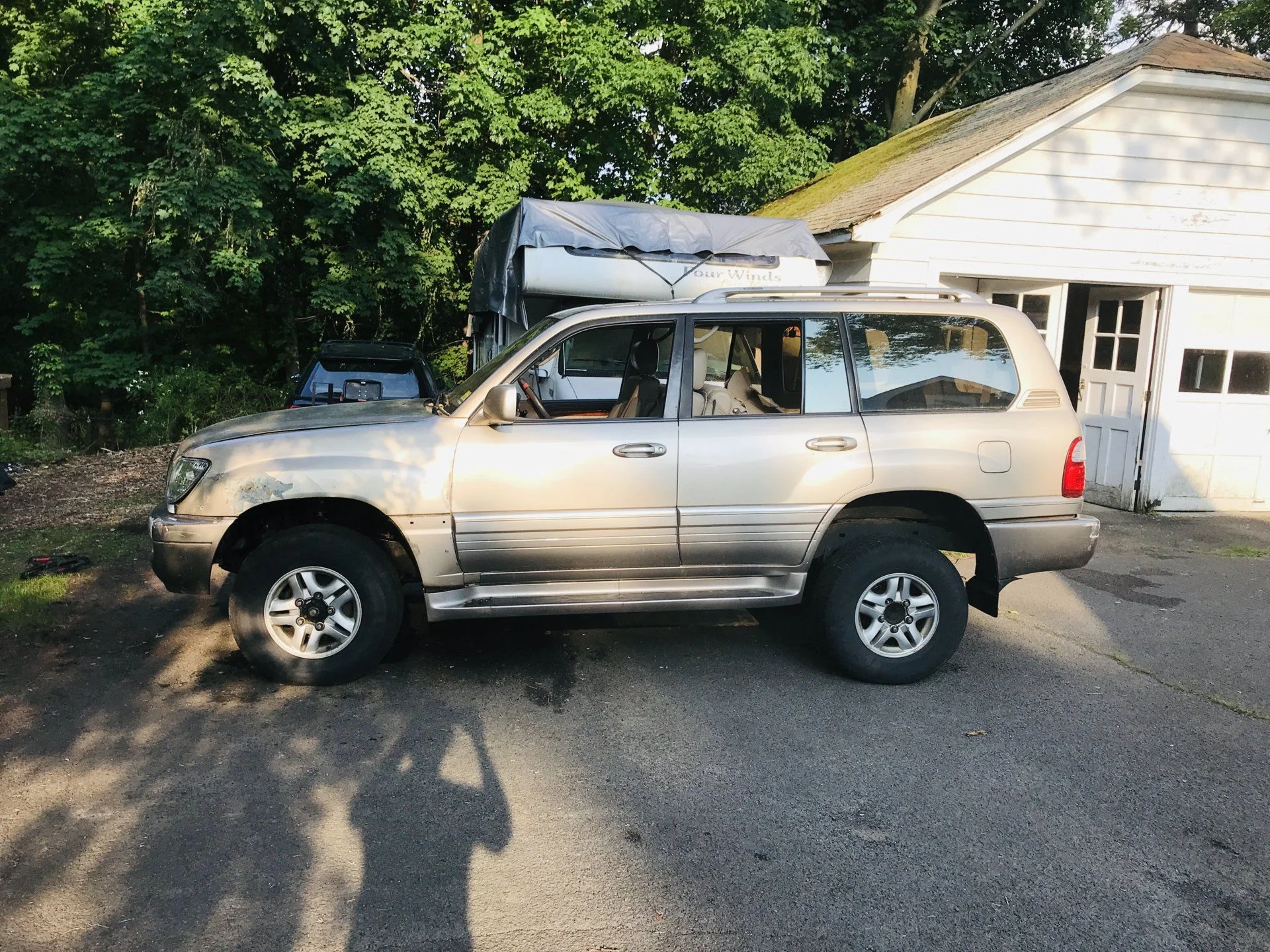

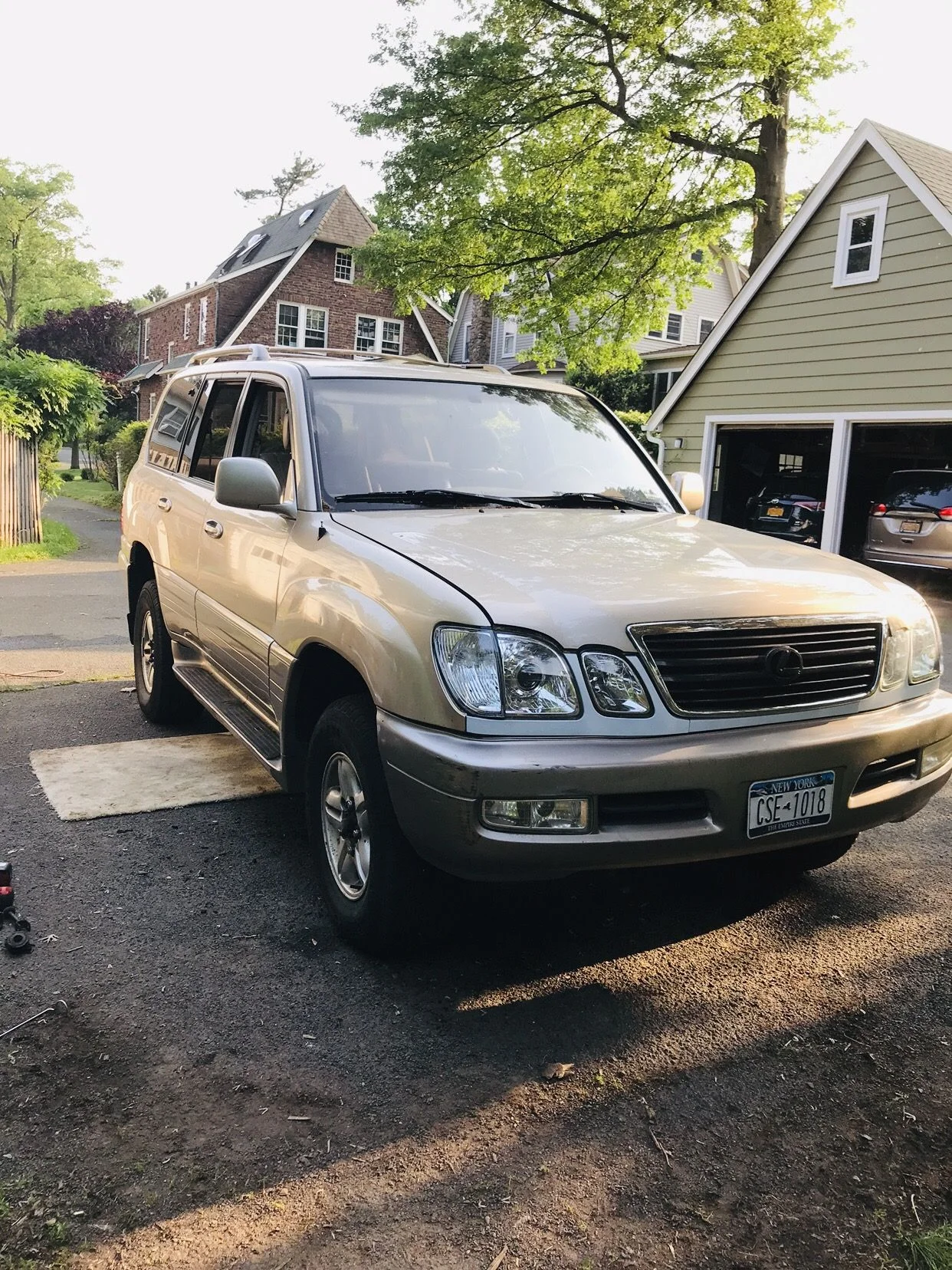

2000 lx470 247k miles.
Just got done with the ome kit with HD lifted springs and sway away torsion Bars.
Total shop time 24 hrs. Spread over three days
Removing the old failed hydraulic suspension was difficult.
I had to weld the security lugs to my wrench to spin them off.
Felt like a good battle.
Tired and beaten but pleased with the results

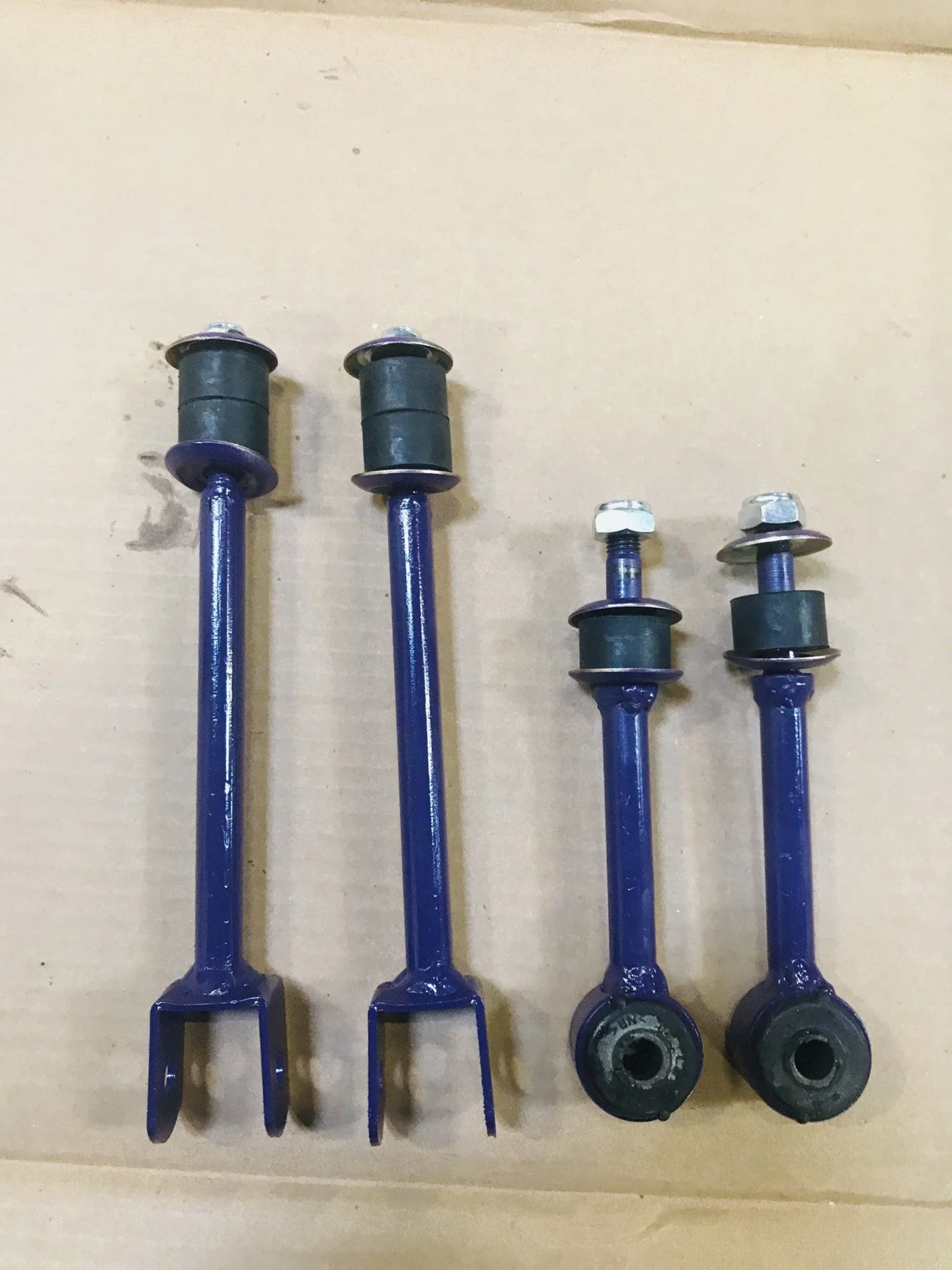

The factory set of sway bar links arrived today, I will extend them and put them on.

Cut and elongate the factory sway bar links and install them, I was gonna lengthen the links with some 1/2” steel pipe but the pipes might be too heavy. Any suggestions? I’m now thinking 1/2” steel hot rolled rod
