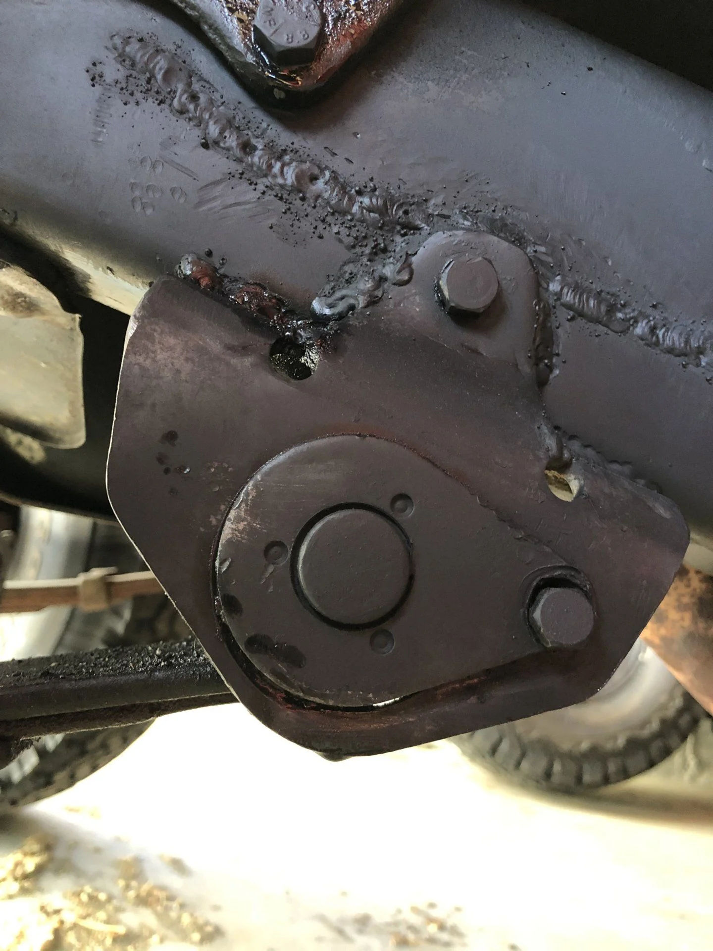

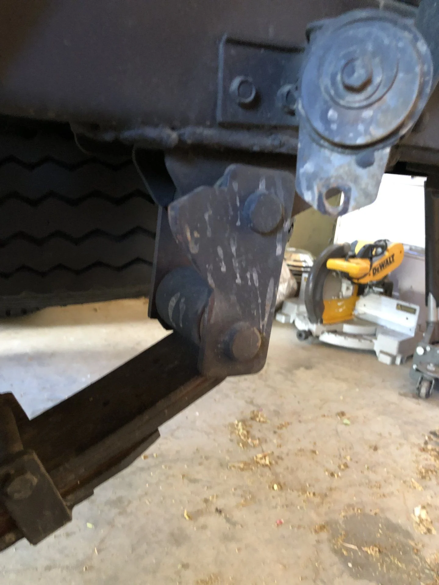

I’ll try and post some pics of mine. Onur thinks they are non-stock.
Your setup looks like the later larger style pins and shackles. That weld line looks suspicious--some things may have been moved or replaced. I'm guessing you cannot talk to the previous owner?
No. I don’t speak Spanish 🤣. The weld line is from a crack in the frame. All 4 hangers have been rewelded at some point. And i’m guessing it was done in the field. Things are not lined up exactly and it’s putting stress in different places and some hangers are cracked. Things you can’t see when buying from far away places and looking at photos they send.
