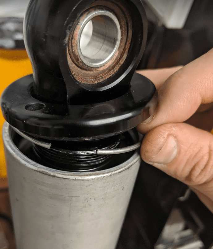

Alright I said I would post some pics so here you go.
1) let nitrogen out by unplugging the bolt at the top and using the provided needle in kit to get the left over nitrogen out. In my case there was zero nitrogen left
2) Remove tube cap with allen wrench
3) Unlock tube cap by counter clock wise twisting the cap using the holes left by the previously removed bolts as leverage
4) Remove cap and then locking clip hidden inside tube. Note you will have to compress to be able to remove clip
5) Take clip out and shock will come apart now. Be ready for fluid to pour as you are pulling shaft out
6)Slide shaft out and clean
