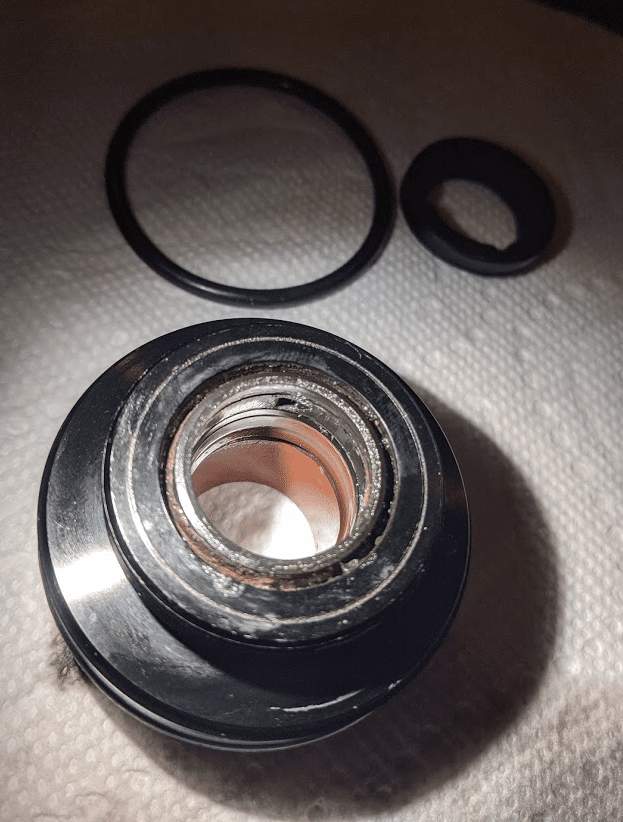

7) So this is the rebuild kit and what you are rebuilding is these rings and pieces in order.
7) Remove shock bolt and keep washers in order
8) replace rings. White vinyl washer goes inside cavity of black section of screw. This is probably the trickiest part of the whole process.
Old next to new rings
Installed vinyl washer:
8) Put everything back in reverse order. Fill in new oil to top and nitrogen refill at 220 lbs and done
Shock rides like new
