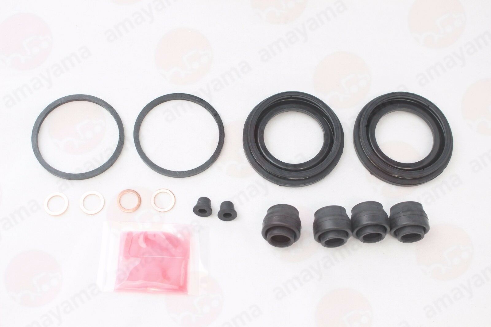

Depending on mileage and the condition of your calipers, it would be a really good time to replace the piston seals and boots, slide pin boots, etc. if they're original. Toyota has a kit with all of said parts for around $25: Part #0447960060.
