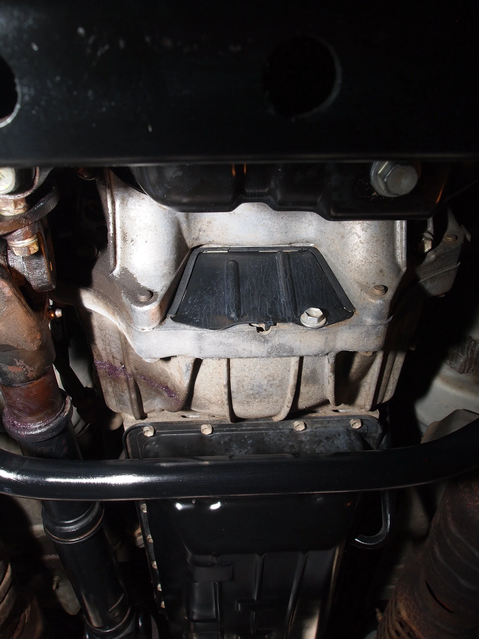

It may be rear main oil leak:
More likely, it's the rear main & O-ring, than pans. Often the few times, we see these rear main leaks, the front O-ring is also leaking. In front O-ring, factory book method is remove engine. But if just rear main. We pull transmission, to get at rear main seal & O-ring, from back of engine. Oil pans are not removed.

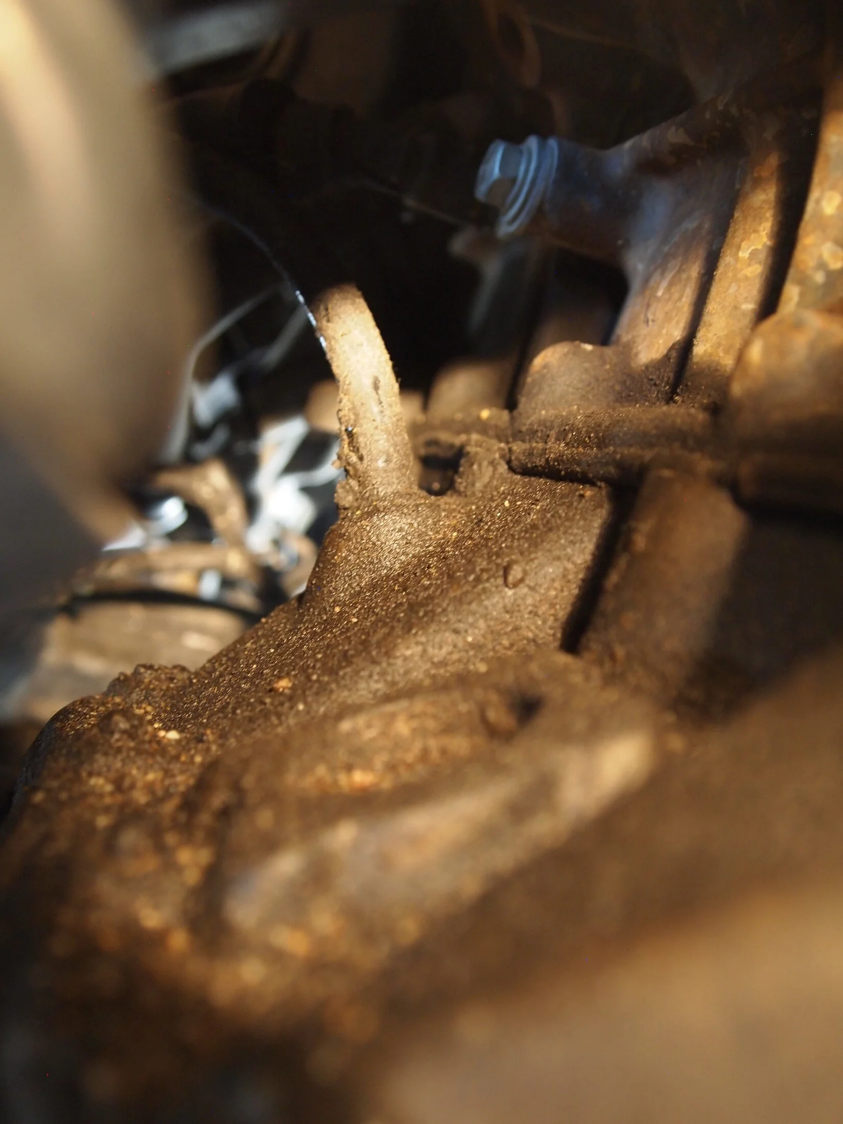

Most times, leaks we see at rear:
Are actually from above, from head cover gaskets. Studying where oil is at bottom of engine and following wetness up engine.

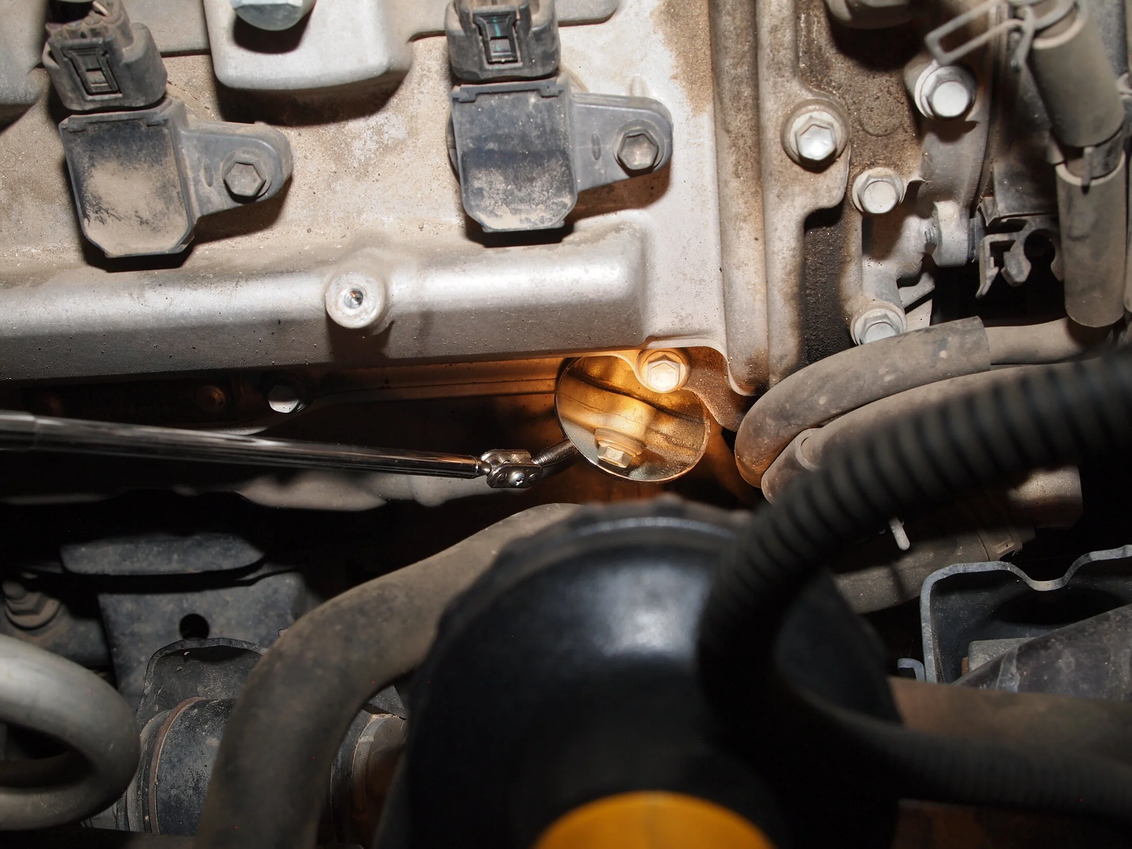

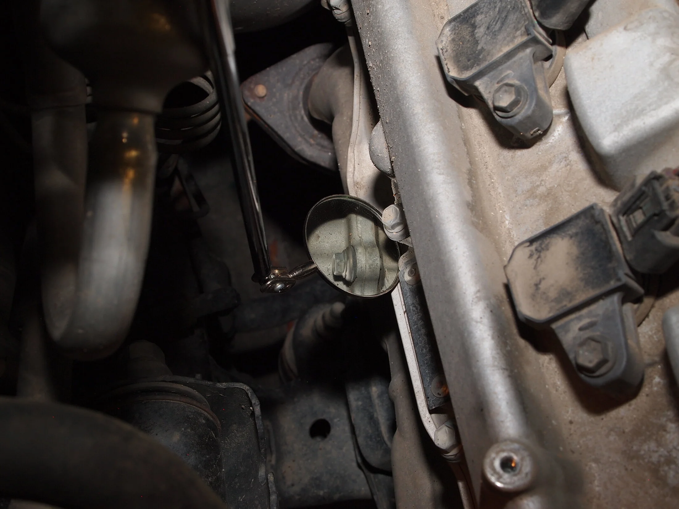

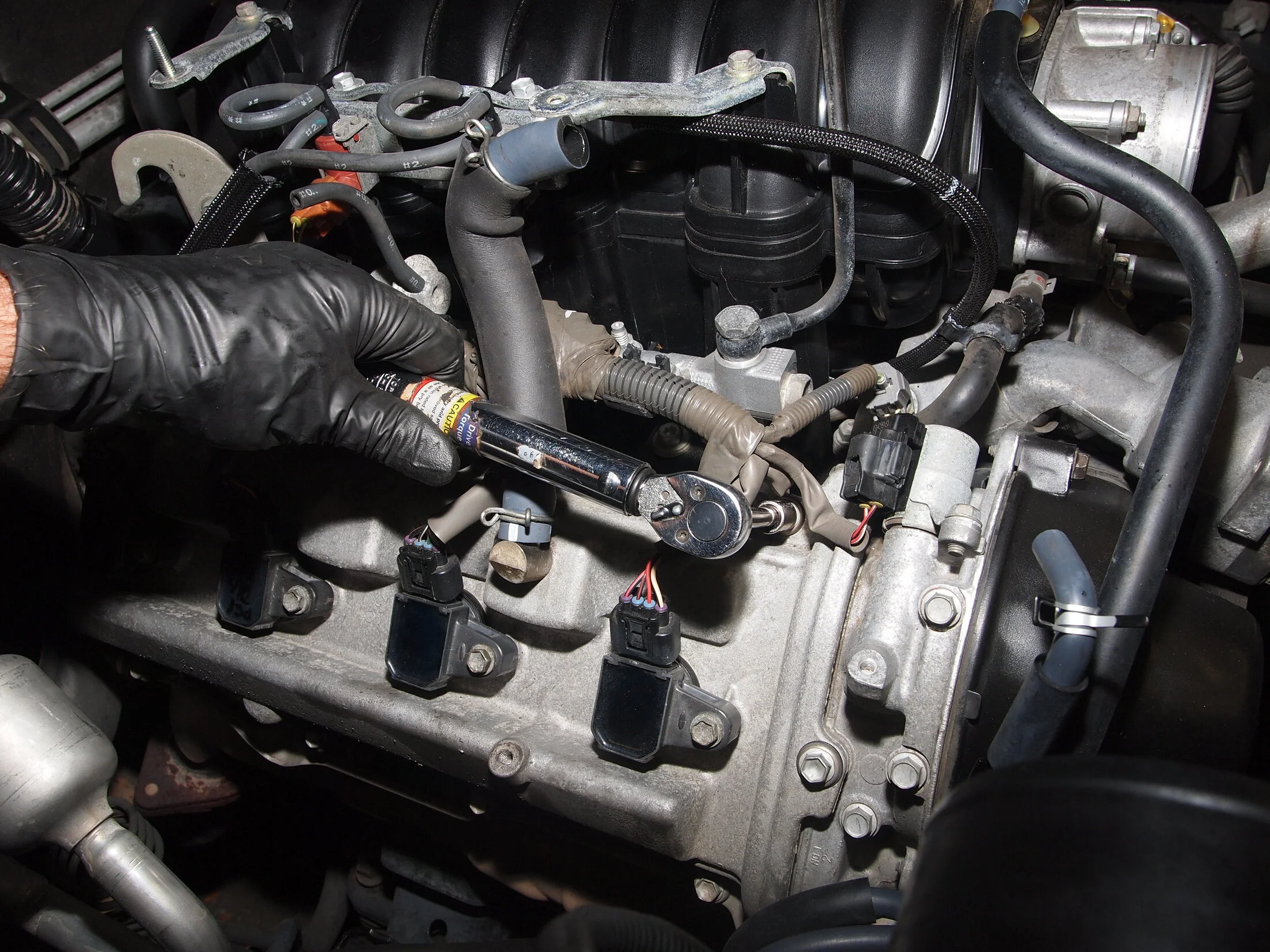

  1. I would re torque the head cover bolts to 54 INCH-lbf. Making, 2 cross pattern passes.
  2. Replace PCV valve and both hose, if needed. If not doing its job, at reduce crankcase pressure, we get oil leaks.

Bk 2 PCV hose, and 1/4" torque wrench set to 54INCH-lbf, retorque HC. These HC (head cover) bolts always loosen. Or rather the bolts rubber washer and head cover gasket shrink. I've stop 100% of over 100 4.7L HC leaks, that still have factory gaskets. This works until it doesn't.

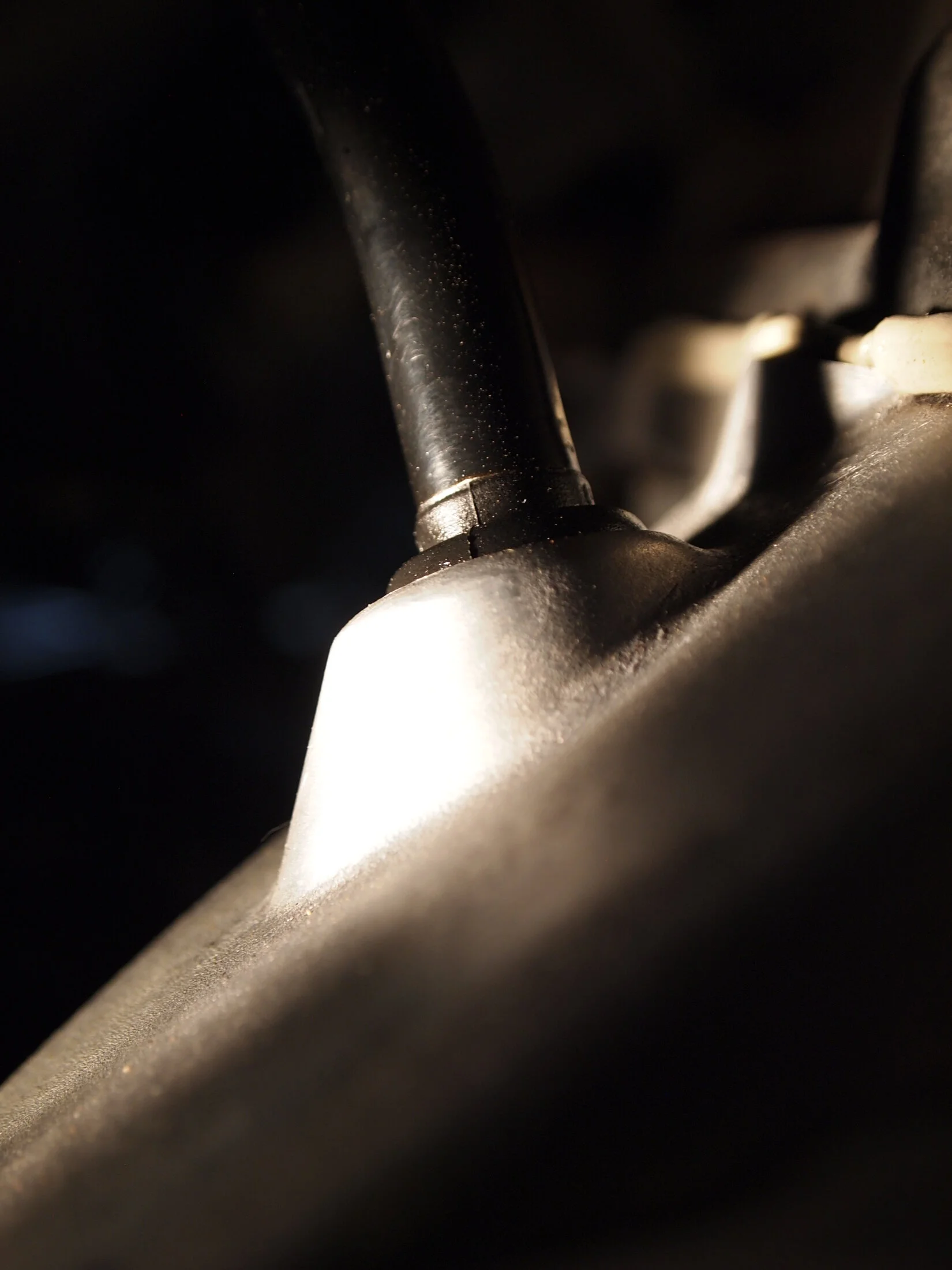

One other very common leak:
Is a weep, seen on LH side and rear of oil pans. Is dipstick O-ring. We see this in older high mileage engine. Because slow weep takes time to accumulate to be seen on pan, and with age rubber O-ring shrinks and the weep increases. Easy fix, replace O-ring, by remove 1 bolt hold dipstick tube.
