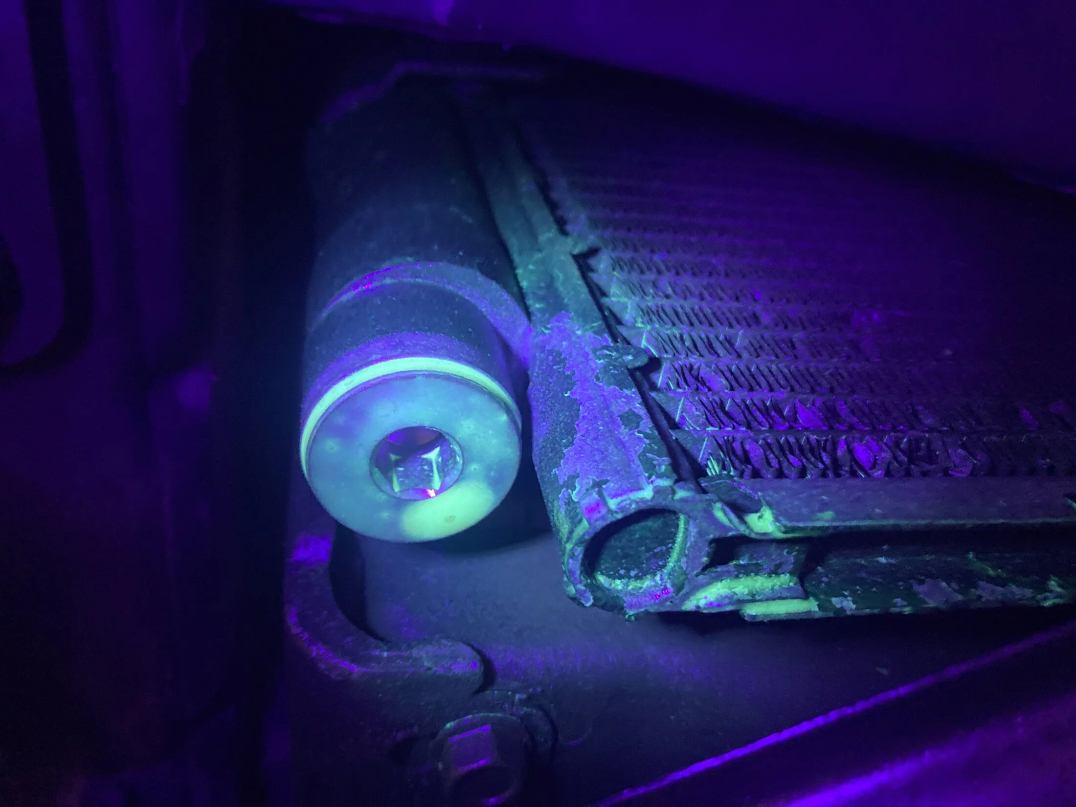

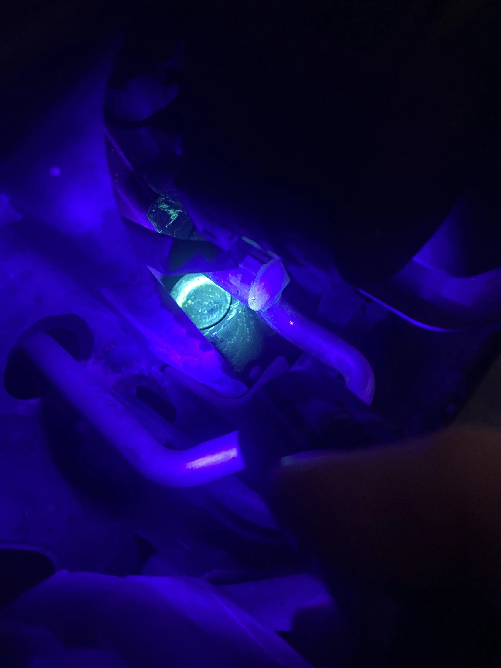

This makes me think the condenser is done:
The second pic you posted:

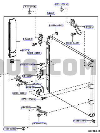

It's a plastic cap that's removable. The desiccant bag is in there chilling. I would assume you pull the old and put the new in.
What if you tried changing the o-rings on that cap first? Or the cap itself, which looks like it's included in that kit you linked to. Last ditch before you put a condenser in it.
The Toyota condenser comes with the desiccant bag in it already. I replaced mine two months ago with a Mr T part. I personally would stick with Mr. T for this stuff.

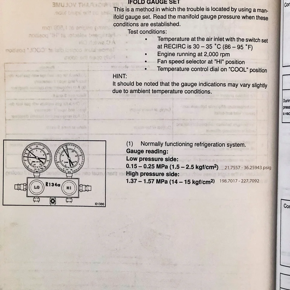

I replaced the o-rings on the hard line feeding the condenser, and then my guy put the system in a vacuum state for 50 minutes.
After that he added 2.5 lbs and showed Low side was at 34 psi and High side was at 240 psi.
That cap with the Allen fitting is plastic? So you are thinking that o-ring could be blown?

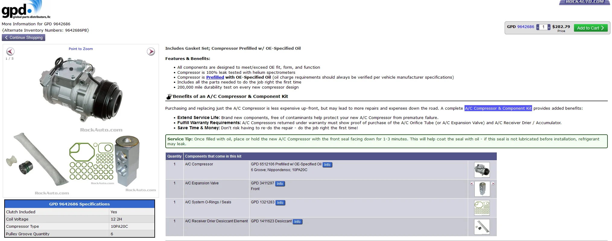

I actually bought a new compressor; the desiccant kit was a bonus:
I did not use the plug from the kit, however. I reused the OEM and installed new O-rings.
I have a GPD Condenser from RockAuto. It was about $100 out the door. They're based out of Macon, GA. You can get OEM just under $300 out the door with the sale that's going on.

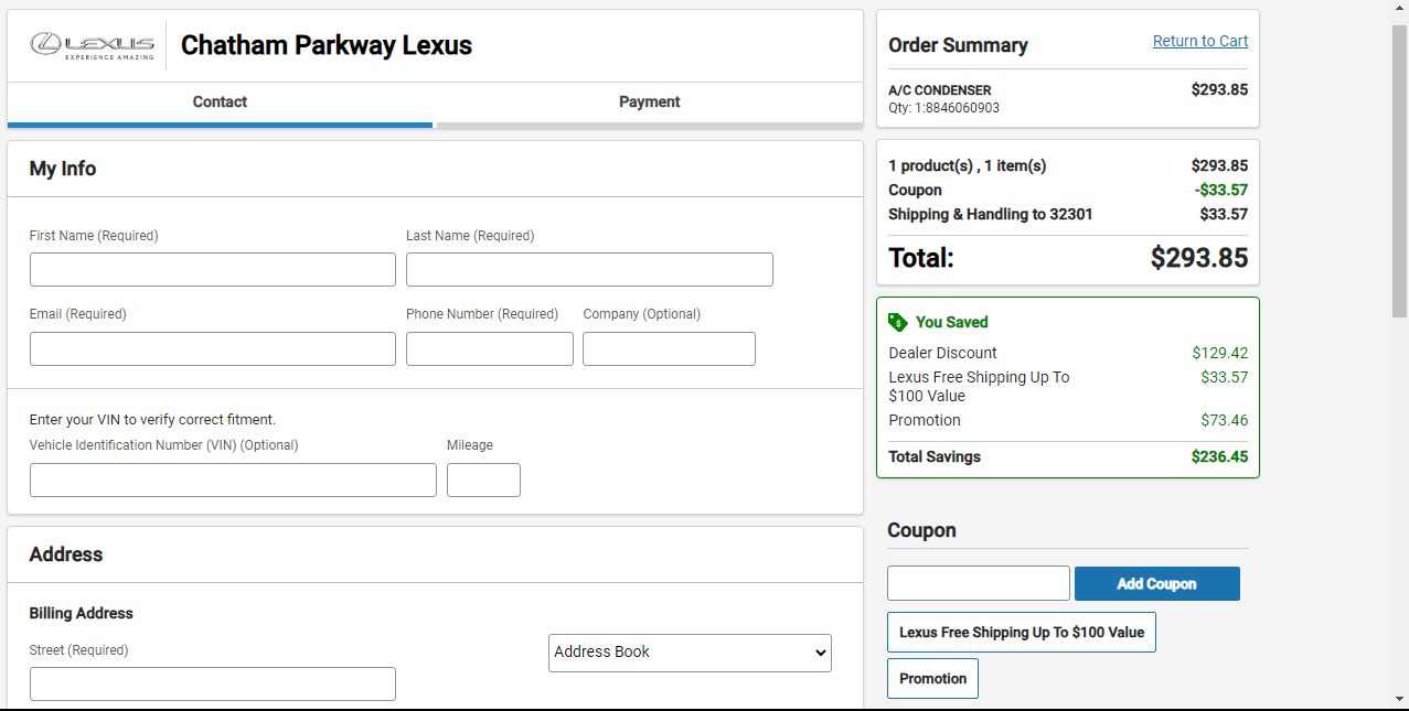

Based on my research, everything inside that "box" is included with the OEM condenser. Price for OEM right now is $343.42 out the door. I would wait for a holiday sale if you want to go the OEM route. Or try GPD from RockAuto for $100 out the door, it also includes the desiccant, but not all the unnecessary brackets.
