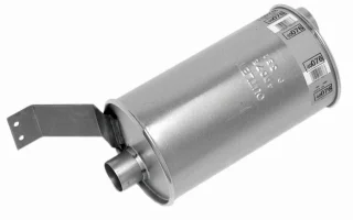

Walker 40076 quiet flow muffler

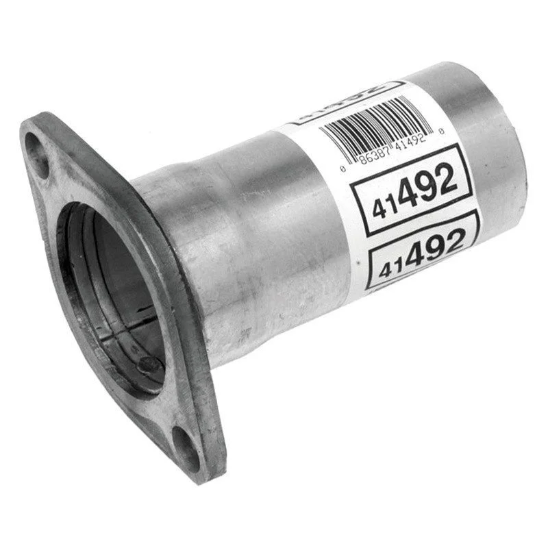

Walker 41492 mid pipe

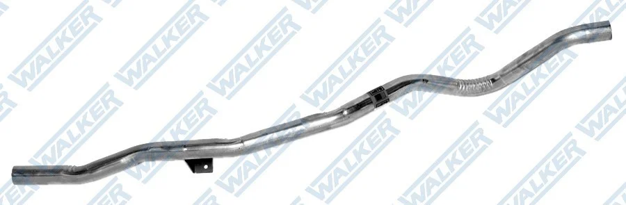

Walker 46678 tail pipe

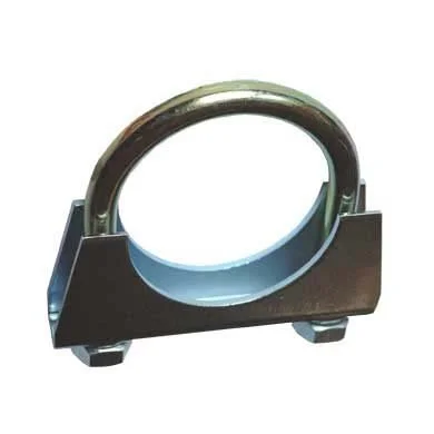

Dynomax performance clamp 35336 2.25"
Dynomax performance clamp 35335 2"

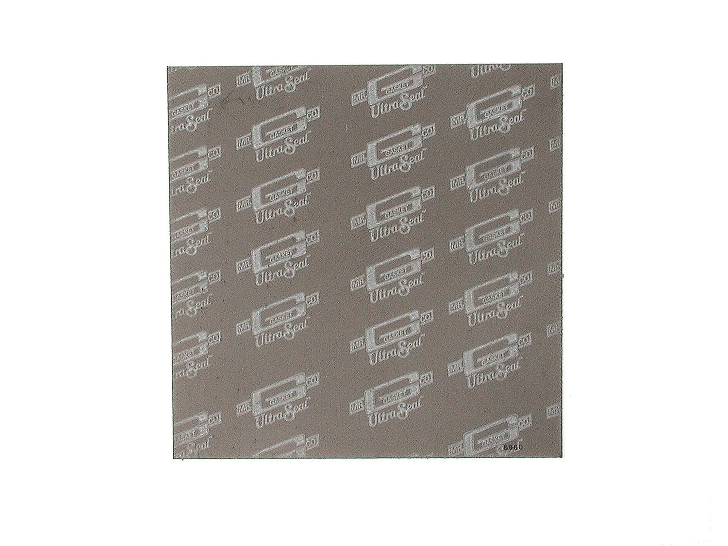

Exhaust gasket sheet (steel core surrounded by graphite)

After that it was a matter of fitting the pieces together. Easiest to mount the tail pipe first then fit the muffler, then the mid pipe. It might work different for different folks. 2" clamp in the mid pipe flange the muffler and 2.25" clamp on the muffler to tailpipe joint.
Now the FJ is nice and quiet.

Useless? Maybe, but only for those too lazy to do a part # search. The rest is self explanatory, even for those who have never done this before. It will in fact only fit together one way and one way only, clamps and all. For those of you who need pictures...

What did you use the sheet material for? Splain it to me Ricky! :) I need all this stuff and have it ready to order but the sheet material has me at a loss...
It sounds like he made his own gaskets for the bolt together sections such as the mid pipe forward.
