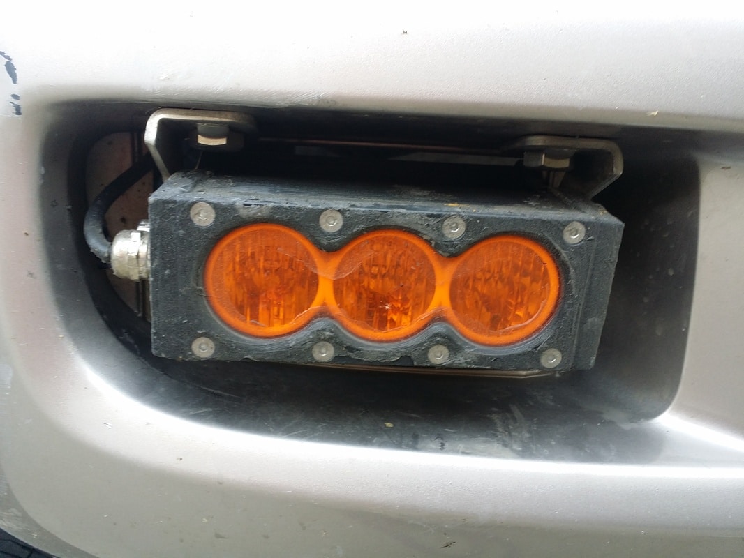

I have 2 Amber LED pods installed in my stock fog location after having my OEM and replacement OE style fogs fill up with water.

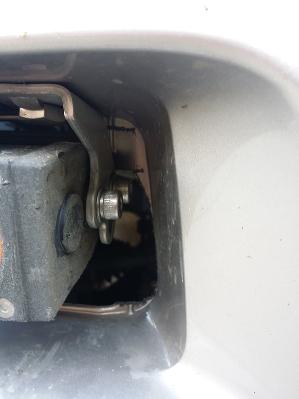

I had to trim the OEM LED support tab with a dremel or sawzall to get them to fit (mainly I cut the OEM fog support / mount). But only on one side for both LEDs if that makes sense.
Took measurements and some pictures this morning. The opening tapers slightly going from front to back (slightly less clearance in the back). Height: 4.25" Width: 8" Depth: 3.25"
My lights with the bracket part are : Height: 4" Width: 6" Depth: 3".
One support tab that I didn't cut.
The support tab I did have to cut on the opposite side.
What it looks like:
I wired these directly to the OEM fog harness. I cut maybe 6 inches before the fog light bulb holders and spliced/soldered/heat shrinked the connections, has worked for a solid year without issues.

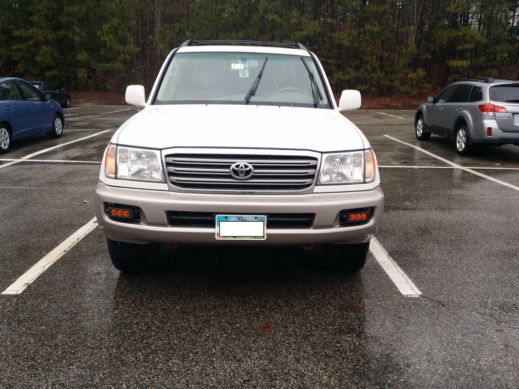

@dogdaysindurham Can we get a shot of your whole front bumper?
I'd like to see how they look when viewing the whole thing.
I'm liking this idea with the amber LEDs in there.
