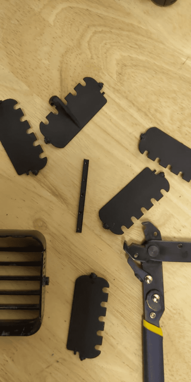

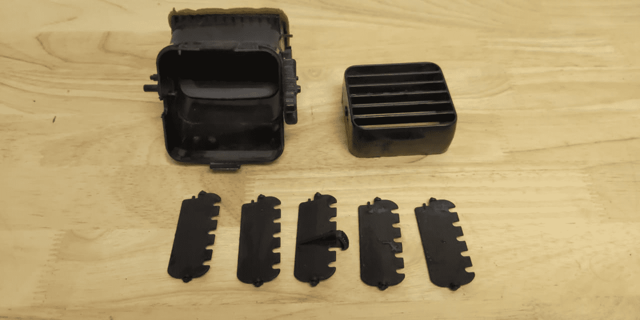

Here is the assembly taken apart.
I found that the little nubs that the plastic strip ties together is a little bigger than 2mm, so that is the size hole I drilled after measuring the inter-vane distance--13mm for this register.

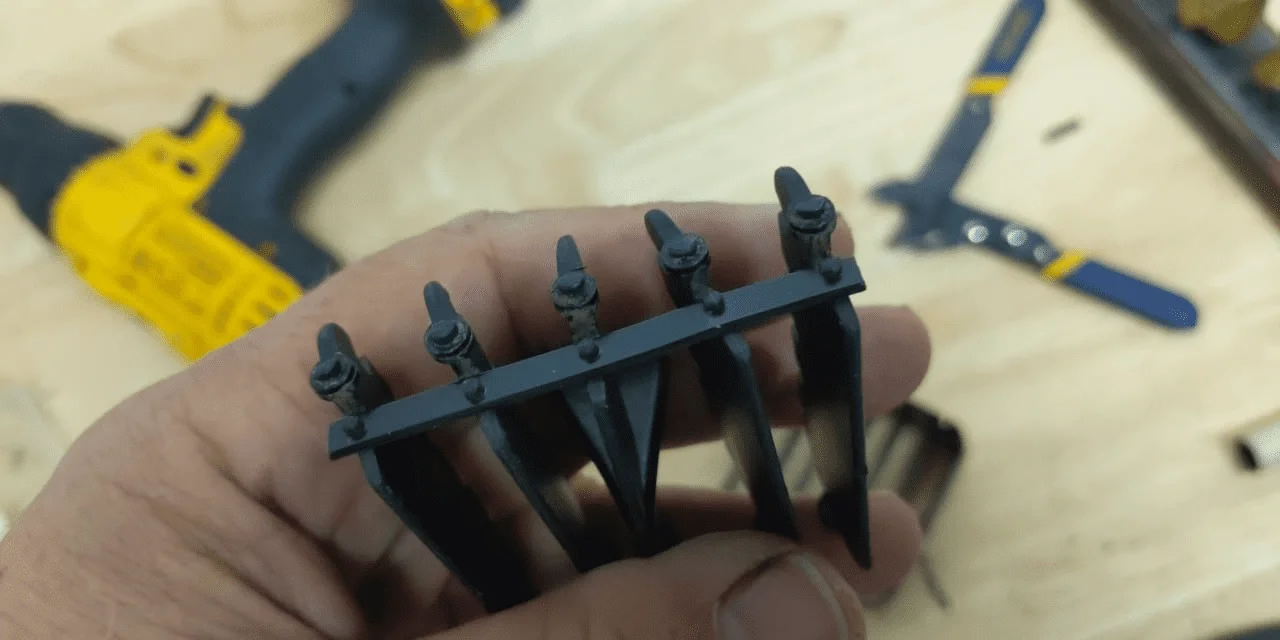

Here's the completed strip with 5 holes, 13mm apart (other registers have a different distance).
And here are the vanes now tied together again, this time by the zip tie section with the holes drilled in it:
The nylon zip tie seems to have just about the right amount of flexibility. The little nubs snapped through the 2mm holes and showed no tendency to pull out again.

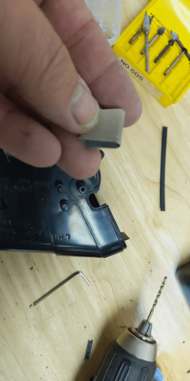

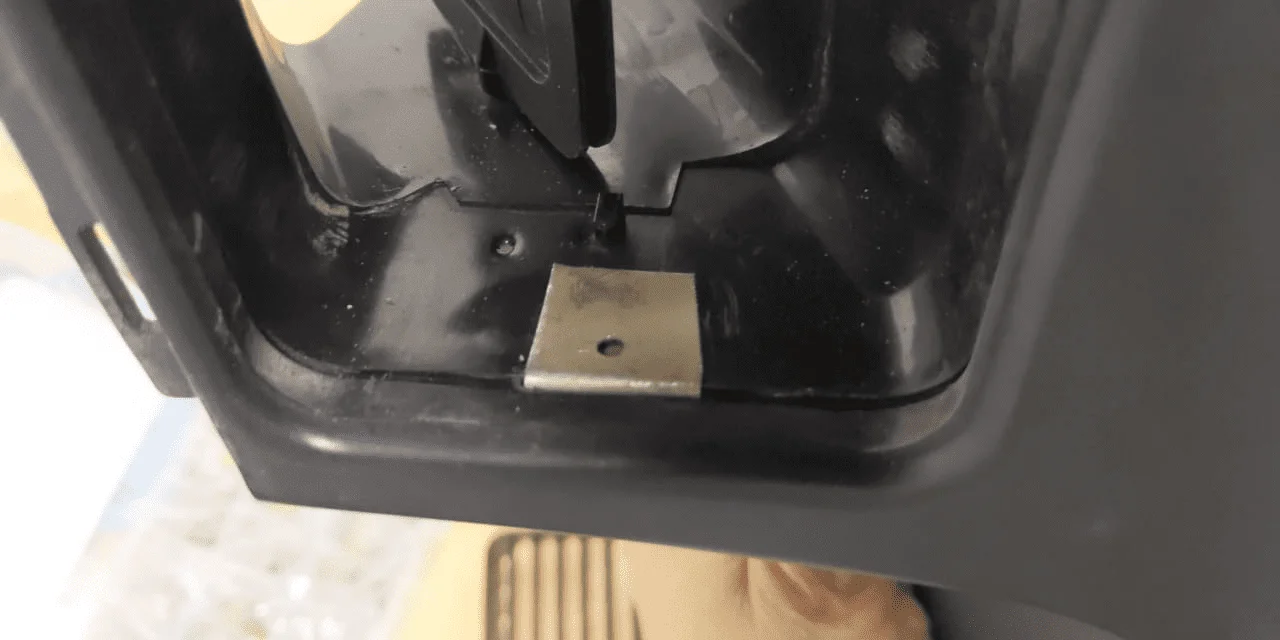

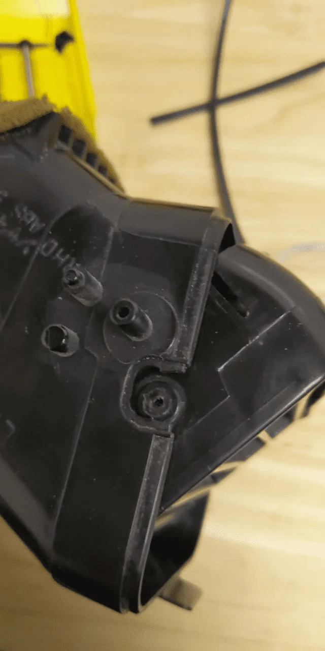

The next problem was that the bearing at the side of the vent also had disintegrated:

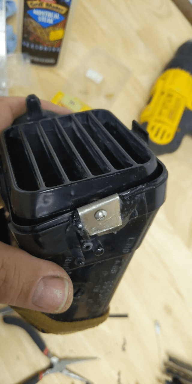

I ended up using some sheet aluminum bent into a clip and then drilling a hole in the inner component of the vent to accept a small screw, the hole being tight enough that I could self tap with the screw.
I glued the metal clip onto the register housing.
I had to trim the dash panel slightly to accept the register because the metal clip was just slightly proud.

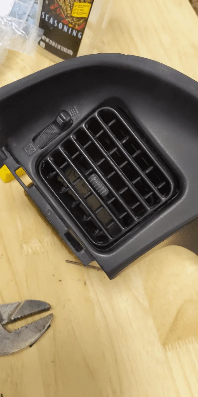

And here's the end result.
I used permanent marker to blacken the metal clip. The register has about the right stiffness, at least for now. I'm going to go ahead and try to fix the other three registers the same way. All of them had floppy vanes because the little strips were falling apart.
