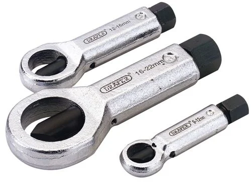

Hm. Never seen a nut splitter before... does it take 'em off without damaging the bolt threads?
It can but if you need a nut splitter the bolt will be done anyways.
They work like a hot dam, even a 3/4" nut in a snap.

Thanks for all the tips folks!! I don't have air so will see how I make out with penetrating oil and strategic use of muscle power, tools and physics... If no go, will take it into a shop with air chisel for removal. Those nut-splitters look very useful, though I don't think I can get at the nuts on top of the frame with it...
