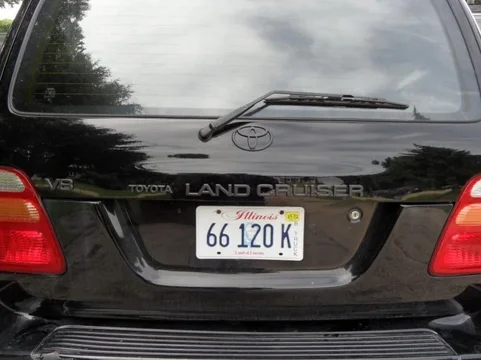

Here is what is left after the emblems are removed:
final product; I was removing gold emblems so I just upgraded to the newer style:
I didn't have to use any of that stuff. Just a little Goo Gone on a lint free rag and about 2-3 minutes worth of rubbing. It looked like the emblems were never applied from the factory. So good in fact that I had to spend a great deal of time with a level, tape measure and painters tape just so I could get the new ones aligned correctly. Did I screw up my clear coat in that area or something?
Installation suggestion:
When you apply the new emblems, consider leaving off the "Toyota" piece that goes to the left of "LAND CRUISER". There is already the sombrero right above all of that and it is kind of redundant. I did a mash up of the 98-02/03-07 rear badging and just left off the "Toyota" and centered the "LAND CRUISER" pieces. Looks a lot better in my opinion.

Paul, here's my alternative to the Black Pearl kit, just used PlastiDip and it's held up great for several months.
I did about 4-5 coats in case I wanted to peel and reapply.
